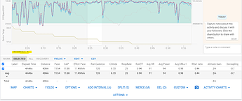

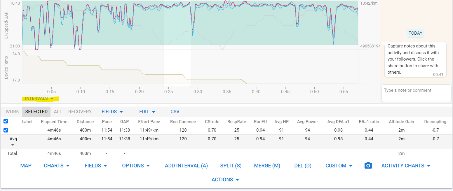

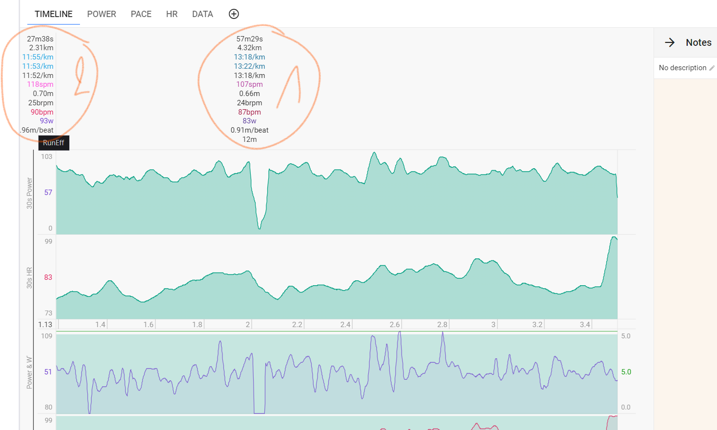

A selection in Intervals is a zoomed in view of a part of an activity. You can make a selection by click-hold-drag-release at a point in the chart. The important thing here is that you must be in the active part of the plotted area. Not above in the header part because it won’t work there. Once you do that you will get a zoomed-in view of the selected part. To zoom back out to the complete activity, left click anywhere in that same area. Don’t drag because you will zoom in further. Important to know is that selections are not stored, not permanent.
Once you made a selection, you get a second set of metrics, specific to the selected part (2). Where the first set (1) is still the header for either the complete activity or any visible already created intervals. I will discuss intervals in more detail in a follow up post.

  • A number of Actions will have effect on the ‘visible part’ of the workout. Some examples are Fix data/Crop/Ignore part. all functions you can find in the ‘Actions’ menu at the bottom of the Timeline tab.
  • If you are interested in the metrics for a part of the activity, but you don’t want to create an interval. A part of a climb that is already an interval for example.

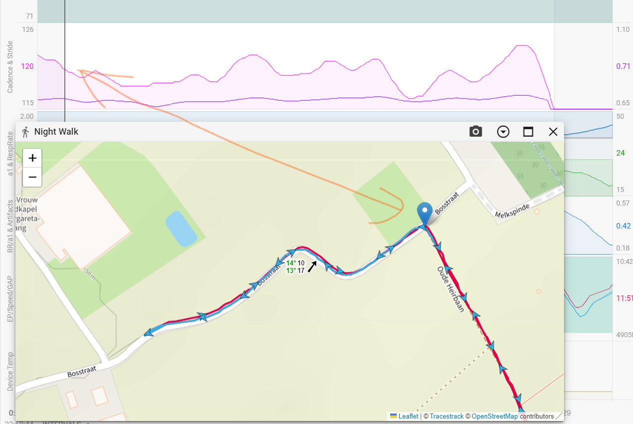

  • If you have the map displayed, the zoom will also zoom the map. This means that a roughly created interval can be very precisely edited if you want a specific point on the map as start and end point of an interval. Zoom to a small portion around the actual start point of an interval, then drag the edge of the interval precisely to the desired start or end point.

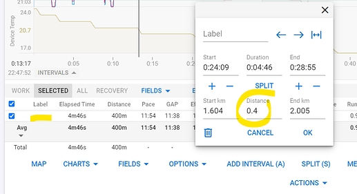

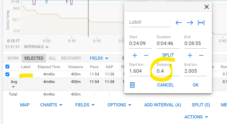

You can further edit even more precisely by clicking on the Label of that interval, blank if you haven’t named it. In this example I created an interval with a specific start point on the map and an end point exactly 400m further.

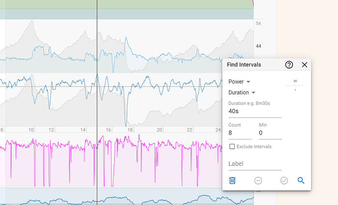

  4. You can instruct Intervals to look for specific intervals, with a specific power range and a specific duration. You can for example look for 6 intervals of 6 minutes at 110% FTP in case you did a VO2 workout where no laps were logged.

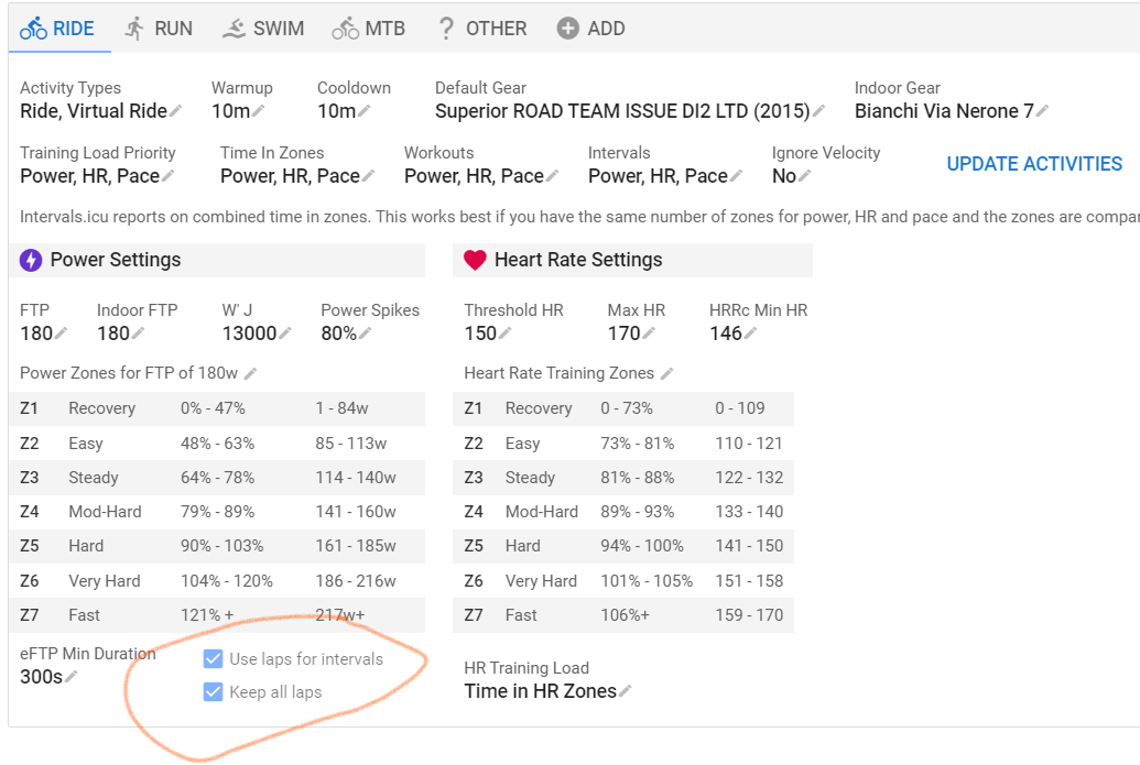

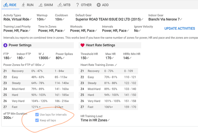

In settings, for each category, you have 2 checkboxes, ‘Use Laps’ and ‘Keep All Laps’. If you enable Use Laps, Intervals will not auto-detect and follow Lap-events in your activity. The ‘Keep All Laps’ will make sure that ‘weaker’ recovery/rest intervals, will also be logged as an interval. If you keep it unchecked, a weaker range in between two efforts, will not be considered an interval. So these checkboxes define what Intervals will do with a new activity coming in by default. If you don’t like the result, you can go to the Actions menu – Analyse and you will get a chance to change the detection method. Actions-Analyse can be done at any time, so the best way of learning what’s described in this post is to try all methods on a single activity and see which method is best for your use-case. The first three methods above can be chosen from the Analyse dialog.
Actions-Find intervals is the menu option that will let you do as described in nr 4. Just play with it to see how it works.

Use the interval dialog to move an interval left or right per second with the L/R buttons (1)
If you only want to move the start or the end, click on the +/- buttons under start or end to move that by one second (3)
If you want to make the entire activity one big interval (2)
If you want to split an existing interval in multiple same smaller ones, use the Split function which has further possibilities to split by time/distance (4)

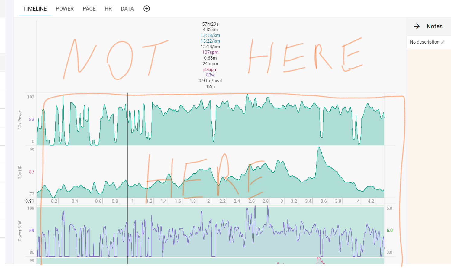

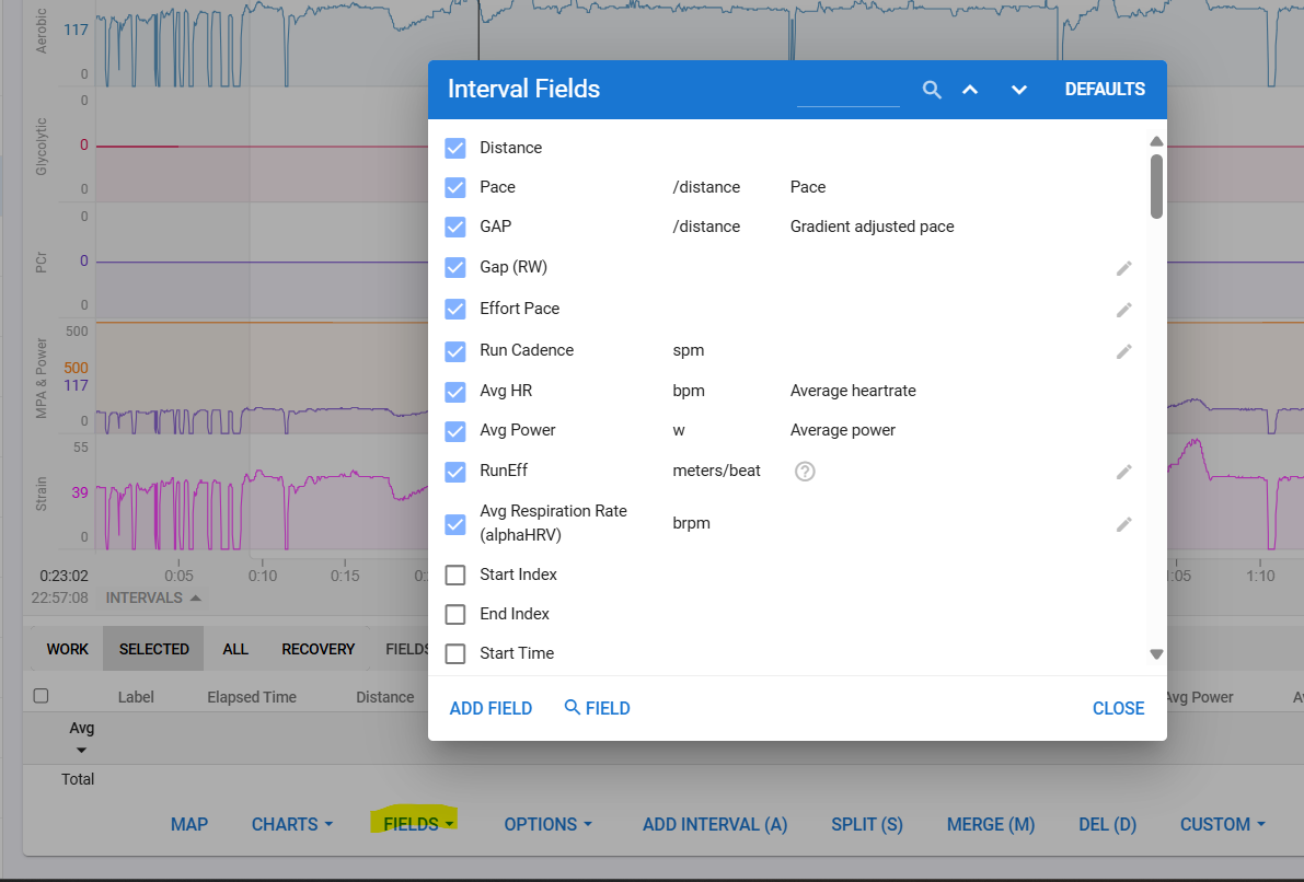

how do i get these circled numbers like your page has? i dont see them and when i select an area of the graph to zoom in it doesnt show any updated averages
You can configure what’s displayed in the headers from the Fields menu at the bottom.
thanks its working now that i added the fields

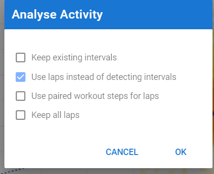

You can use the planned workout steps by analysing from the actions menu with these selections:
But the best solution is always to have them from ‘Lap events’ in your activity file. Either by running the workout on your Garmin, or using the lap button manually.
That was a great tip. And I’m annoyed that I didn’t see it. I don’t start the workout on my Garmin, and I don’t send it back to Intervals via Auuki. But the analysis worked perfectly with the parameters. Will new activities now be analyzed with these parameters as well, or do I always have to select them?
Coming back to the Analyse window will by default activate the last used options.

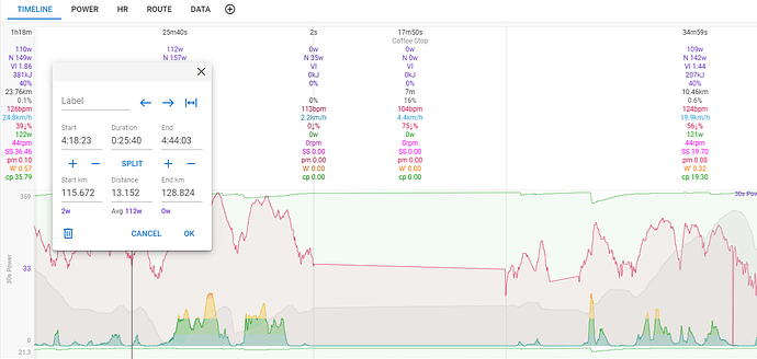

I might be a pain with my questions but I’m struggling :frowning:

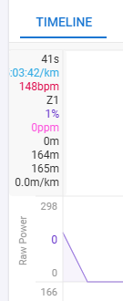

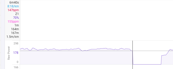

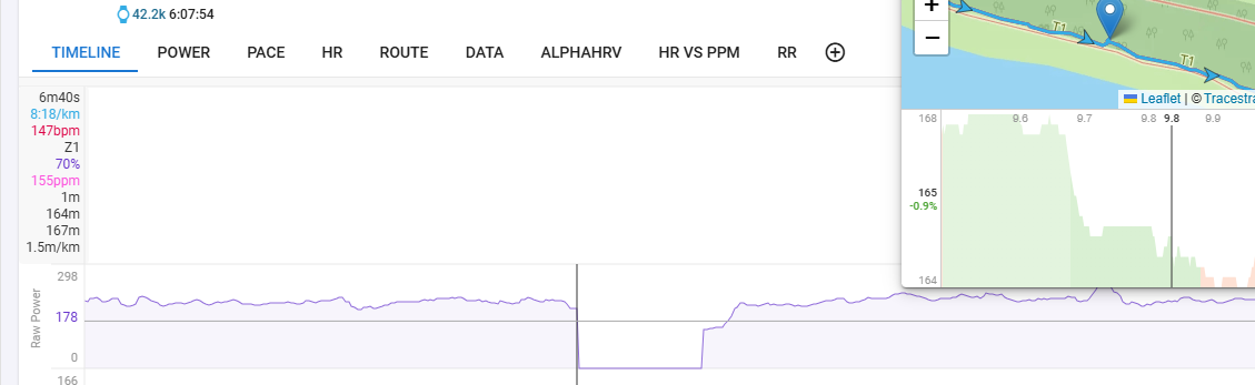

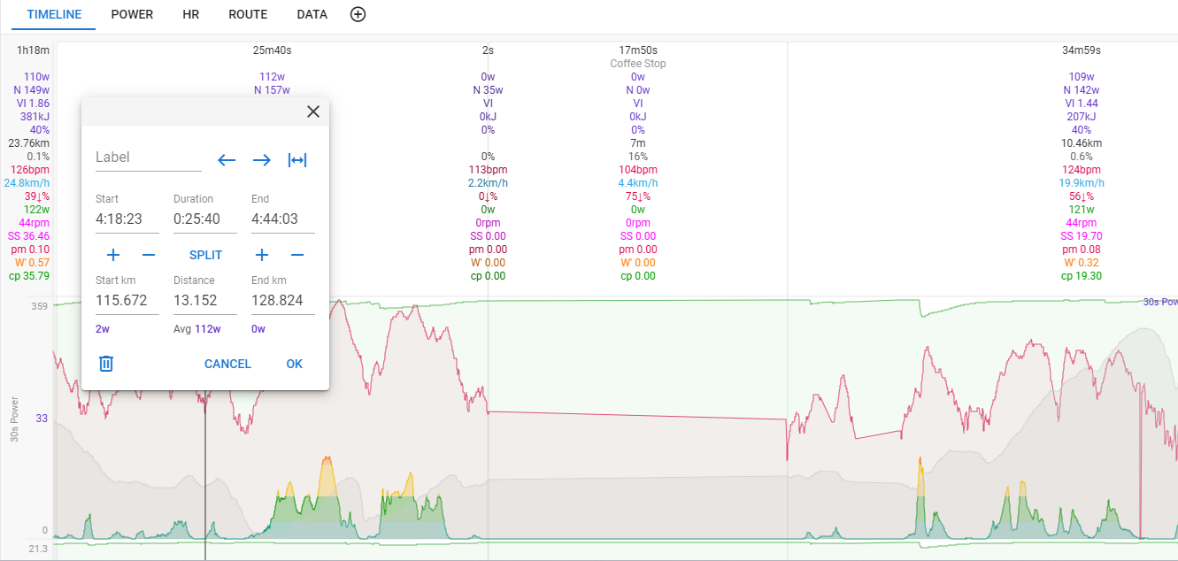

1/ I start from my activity which is an ultra trace race with manual laps. Then I’d like to zoom in a particular area of the run to identify a short break:
The break looks to be about 1h15, so I will do a mouse click left to it, then hold and release a little bit on the right to “zoom in”:
There I can see it much better, but:
The numbers on the top left are now completely fixed, if I move my cursor nothing is happening.

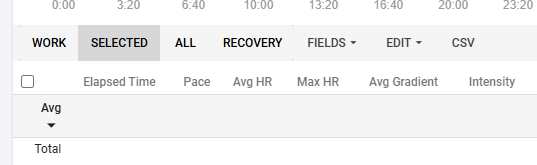

If I go at the bottom view in the intervals area, in the “Selected part” it is empty even?
So from there what I’m doing is another mouse click left and hold, release a little bit further on the right to select only the short break:
This is when what I see on the left part of the charts:
So I guess this short break was 41 seconds ! Next, what I’d like is to create an interval from it and give it a name so that this is fixed and I can view it on the bottom part of the screen where all intervals are summarized after I zoom out and come back to the whole activity view? If I do that across all my activity, I should be able to have stats on all my breaks (how many, and put some labels, comments, etc).
Thanks a lot to help me in the next steps I think I’m not too far from my goal.

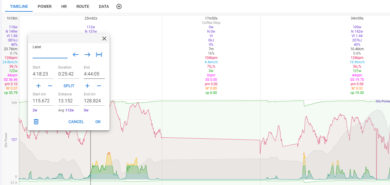

You can just split the interval on that point by pressing keyboard key S
Then do it exactly after the pause and you have a complete interval of the break. If you hover over that interval you can click on the interval (the white area above where the values are printed) and give it a label
The values on the top left are always the summarise of the cooked part, not of any “selected” interval.

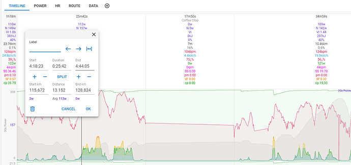

Here’s anexample of what @R2Tom is referring to.
Split the intervals so that you have before, during the stop, and after.
If the intervals have a small gap in between (2s in my example), click on the fields, eg. 25m40s, to open the interval toolbox. Click on the + icon on the “end” interval to close the 2s gap (see the changed effect below).

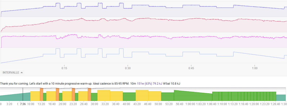

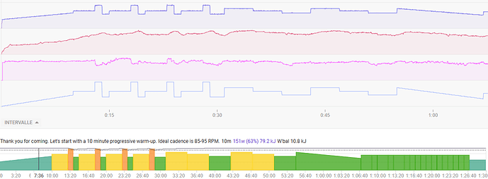

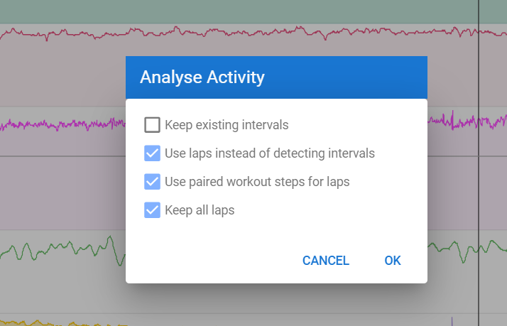

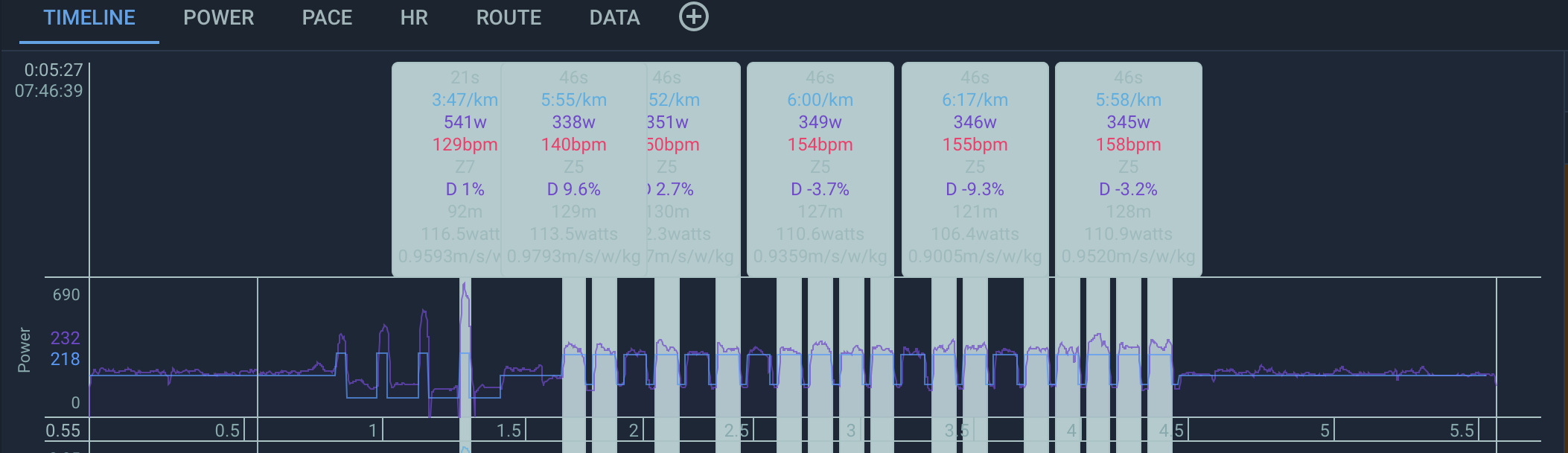

Is there a way to have it use the laps but also auto detect/populate the work and recovery screens? On my activities the only way that I’ve found to have it detect work/recovery is to untick “use laps instead of detecting recovery”, but then it doesn’t always detect correctly. Sometimes missing minutes or whole intervals.
If I have it use laps instead of detecting intervals then all of the intervals end up in “work” and to compare/average them I have to manually select them.
It seems like it should be able to bothe keep the lap boundries of an interval and detect whether that interval was work or recovery, particularly if there is an attached workout plan with the intervals labelled.
If you uncheck ‘Keep all laps’ a ‘high effort’ will be a Work interval but can’t be followed by another Work interval and thus it is alternating Work-Recovery-Work-Recovery…
The easiest way if you have work intervals following each other is to have the ‘Keep all laps’ selected and then just glimpse through the timeline while moving mouse cursor from one interval to the other. Hit the D key to delete if it is a recovery intervals.
If your Work and Recovery intervals are always simply alternating, just uncheck the Keep all laps checkbox.
Thanks, my work and recovery are nearly always alternating (except for if it counts the warmup as it will be next to the first work interval).
I unchecked “keep all laps” just keeping “use laps instead of detecting intervals” and “use paired workout steps for laps” but it still just seems to miss a lot of the intervals (even though they are laps and also in the linked workout)
If I leave just the detect from workout checked, then in this workout it picks up all of that group of 20 intervals but still only two of the four at the start, and also the durations off them are less accurate e.g. 45s intervals are shown as 36s-44s intervals.

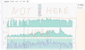

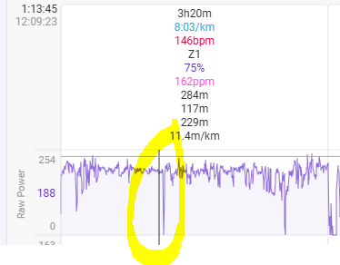

There is an annoying behavior here. Whenever I click to zoom back/out, I am always returned to the top of the page rather than to the position I was previously viewing.
This makes the process of examining details within an activity very fragmented, with a lot of back and forth scrolling.
Is this the default behavior that you also experience?
Yeah, I see this too. Hope some of the devs can fix this @eva
