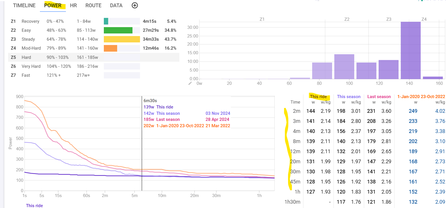

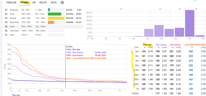

Overlapping intervals canât be done. You can see best power values for different time segments on the Activity Power page.
Unfortunately, you canât see where exactly in the activity they occurred.
Thanks for answer. Like I thought because I tried for hours figure out it. I know I can see there but only power without all informations I would like to see for each interval. Would be very useful to make possibility to overlap intervals for better understanding even how e.g 20MMP was made with first 5â or next 10â.

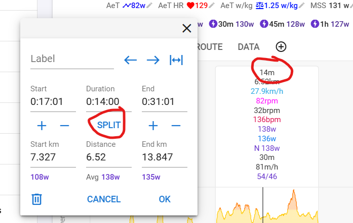

It´s faster and easier if you split the 20 min one in four equal length intervals. Click on the time header portion and use Split.
If you want to join them again to get the full interval, drag the right edge of the first small interval over the left edge of the last one.

Thanks, I miss âsplitâ option. Is simply. Yes could be nice to have it. I try to find where to do request on forum. And for now I simply do screen shoot of âbigger intervalâ before it will be cancelled by smaller ones. Not big issue. Thanks a lot
