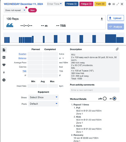

Hi! Im encountering an issue with syncing planned swim workouts from TP to Intervals. As you can see in the screenshots below the swim has a build out plan in TP but in intervals its emty…? Any solution for this?
Out of curiousity, how does the workout actually look in TP?
I tried to copy your workout desc, but this doens’t actually build the workout.
I pulled a :man_swimming: workout from TP Built in Bundled library and their workout has a ā€œworkout detailsā€ portion but your screenshot either doesn’t or has it cropped?
The issue I think with some of the TP swims is that even if they have the ā€œWorkout Detailsā€, they sometimes combine both time & distance intervals which I don’t think is possible within Intervals. Also a couple that I looked at from the TP library had nested intervals which need separating out for them to work within Intervals. That would probably then lead to so many intervals presumably with a Lap Button press in between that it would also get very complicated. A bit of paper stuck onto a water bottle is far easier.
With the example from the screenshot attached, if the workout details are copied & pasted into Intervals’ workout builder & allowing for the fact that the nested intervals have been resolved it would not work without further parsing into Interval’s necessary steps. 200m @ 6 RPE does not equate to 10secs rest in between the 4X50 for example. And the distances need appropriate units added for them to work.
Is your workout distance based? If so, then it doesn’t work yet, distance based steps are not supported.
I’m gonna start implementation this weekend. Could you show me steps for your workout (targets, etc), so I will have some sort of real workout. I don’t swim :slight_smile:
This is how the workout looks like in TP
ah… just like what @David_Bannister said, your workout has a mix of (or purely) distance based intervals. That’s the key thing which isn’t supported by intervals.icu (in fact, when I tried to parse it myself using my BreakAway app, i also suffered a crash as I wasn’t handling the distance based steps)
@Someone_Else did say that he will go and support distance based steps, but i’m thinking that it may not end up how you want it. I’m not sure.
in my mind, a disstance based step means - complete 1 lap, 25m (of a 50m pool) in whatever time it takes. But in intervals, everything is to be mapped out against your pace/100m. Or, the better way to do it is to just put it as an open lap, when you’re done w/ 25m (self gauge), then you press the lap button.
@Delando1 TP workouts work with Garmin as they are distance based & so really the problem is presumably trying to use Intervals for Load approximation & getting the intervals recognised afterwards? If @Someone_Else can find a way to get Intervals to recognise distance steps then this will be great.
As @app4g currently the easiest way is probably to use the lap button. The screenshots show how the TP workout can be parsed into Interval’s format using the lap button so as to get an idea of likely Load ahead of completing the workout. But if you are using TP then you will likely already have this. So probably the only signnifcant advantage might be that the intervals are recognised automatically in Intervals once you upload the workout. But to be honest my experience of Garmin’s lap detection in the pool is that many workouts need to go through corrections (via Swim Data Analyser) before they are accurate anyway so adding manual intervals is not that much extra effort really. Faster cadence swimmers perhaps have less issues as lap detection can be triggered if arm stops moving for something like 1-1.5 seconds I think or alternatively based on the acceleration from push off. So slow cadence or weak push off swimmers can confuse it.
