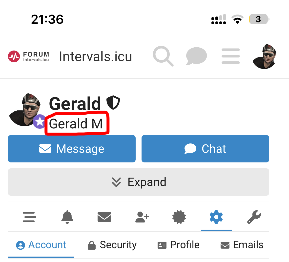

hello Gerald, how do i access these testing protocols? Nvm for some reason your name wouldn’t appear until I wrote Gerald M.
Here is the link Intervals.icu for these who want to access the protocols
Usernames, on this forum, don’t allow a space, but the name does. If you look on the profile, you’ll see the username and name just below.
