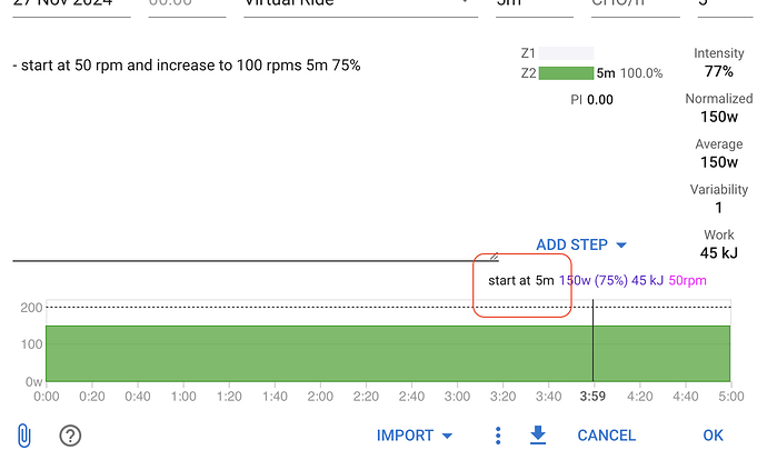

is there a way to have text steps not messing with step parameters? i.e.:
- Start at 50 rpm and increase to 100 rpm, 5m 75%
This displays “start at 5m”:
having a programmer background I tried also escaping with double quotes but it didn’t work ![]()
A quick fix might be to do either:
-Start at 50 rpms and increase to 100 rpms, 5m 75%
or
-Start at 50 rpm. and increase to 100 rpm. 5m 75%
