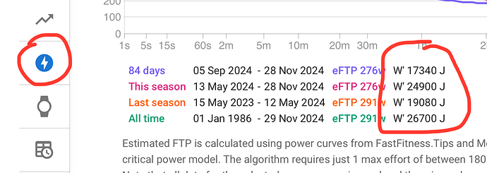

If you set this value (circled in red below), then it will show. It’s the amount of work (measured in kJ) above CP/FTP. Called W’ and pronounced “W prime”.
Edit: the value in the settings is actually Joules (J), not kJ. you can get your estimated value from the power duration curve on the power page. It has to be manually changed.

@Gerald has provided an edited screenshot of how it can be obtained via the Power Curve. Or you can also check it via any of your completed activties where you really push it and you will see your wBal drop. (Once it drops into -ve, that means your wBal is set too low)
This is for workouts pushed to Garmin. (There was a rquest somewhere in the forums for this)
@Gerald do you still have the screenshot…?
It’s in this post

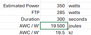

The estimate is how much power (watts) you think you can hold, above threshold, for a certain duration (seconds). Subtract FTP from that power, then multiply by the duration to get the estimated value.
edit: as you extend the duration, your power will decrease, or as you increase power, the duration decrease. Also, with a change in FTP, the value can also go up or down. Let’s assume that the two shaded blocks are 1x1 and 2x1; they both have the same area but as duration increases, power decreases. It’s not linear, but this hopefully explains how it works.
