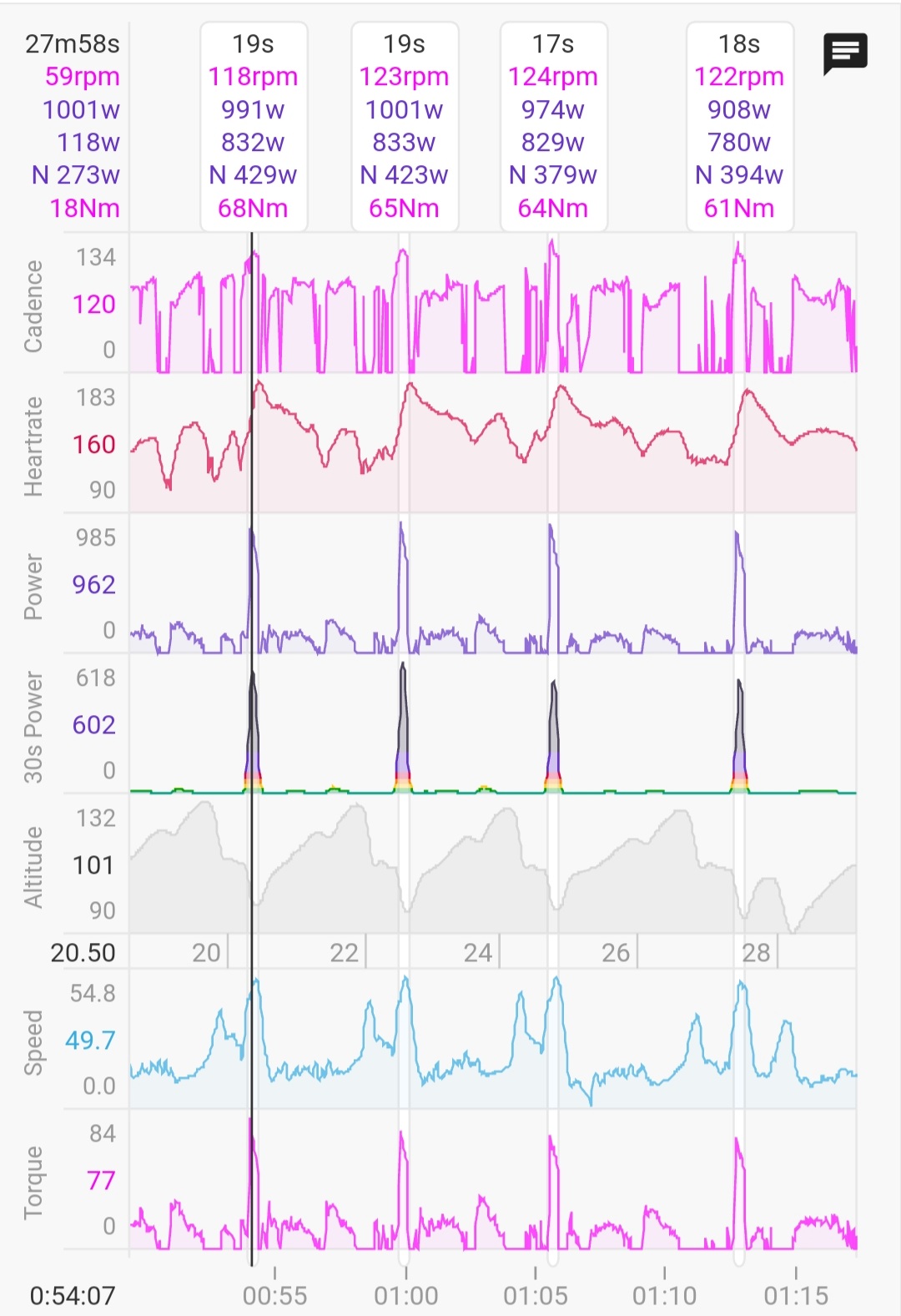

For some time I’ve been suspecting unusually low NP numbers after my rides.
Today this was confirmed when I was doing a seated sprint session, and when pressing the lap button after my interval, my NP for previous lap was almost half the power I was holding for the duration of the effort. I clearly recall this being way higher and very close to average power when doing this workout previously.
I’m using Garmin Edge 520 and Power2max NG eco.
Can this be a Garmin device issue or PM issue? How would I go about troubleshooting this? Can’t find anything on the internet.

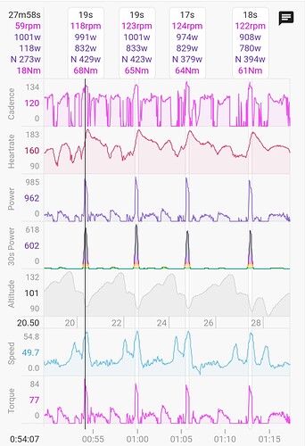

The data fields below is showing max power, average power and normalized power, in that order.
Hoping someone can assist.
see if this answers some of your questions? Not sure..
For very short intervals normalised power will be much less than average. The calculation starts with a 30 second moving average so your 19s intervals will include quite a bit of time before at much lower power. You can see this on the “30s Power” chart, though its not quite the same since that chart uses a centered moving average.
NP won’t be accurate for any interval within a session, just for the session as a whole. Your decoupling data will also have slight inaccuracies because of this algorithm. It’s a pity.
From what I can make out, Garmin employ the same calculations.
Personally I’d much prefer it to be like TP but it is what it is and gotta just go with it.

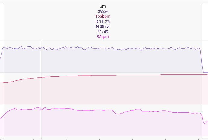

What duration are your intervals?
Tuesday was 4x8. Each reported average on Intervals was 299w and each reported NP was 297w.

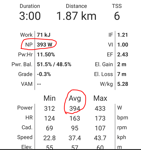

Training Peaks reported each average and NP as 300w
I’m after going back and randomly picked a session from 2021. Massive differences.
3 minute intervals. Intervals.icu reporting a 10 or 11 watt difference between average and NP for each. Training Peaks reports 1 watt difference.

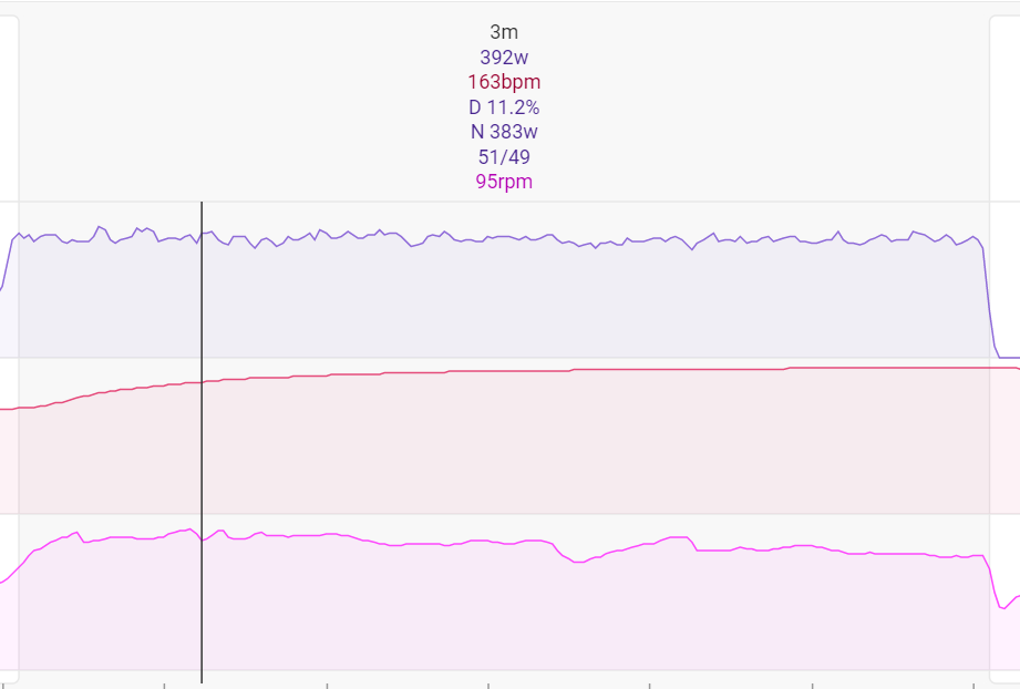

Picking one of the 4 as an example - Intervals.icu Average 392 with a NP of 383. Training Peaks reports average of 394 with NP of 393. This is the issue with the calculation method used here. If someone doesn’t have actual correct data (i.e. that from TP) to compare to you’re going to be left wondering if you were on top of the power properly the whole way through or if your power was a bit all over the place. A reported 11 watt difference between average and NP for a well executed 3 minute interval is just nuts to be honest. It in no way reflects the execution of the interval and is just incorrect data reporting.
Obviously the shorter the interval and the higher the watts the more pronounced these differences will be. But I don’t think it’s unreasonable to expect that for intervals of 3 minutes or greater we should have correct Averge/NP reporting

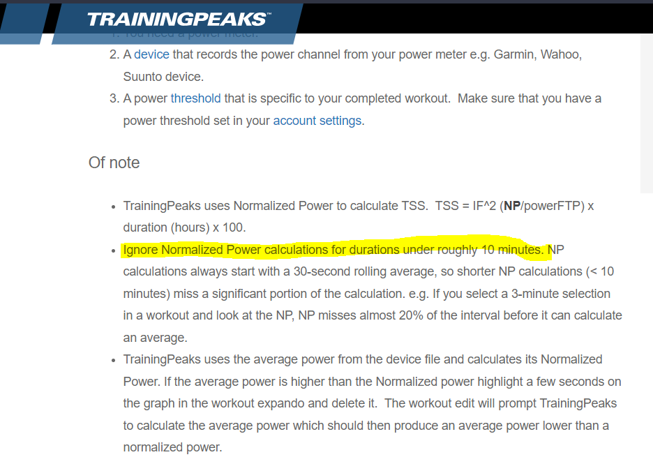

From the TP website:
I haven’t found out yet how TP does the calculation of NP for lower duration intervals, but if they come up with a different number, they are not ding it ‘correct’ following their own definition of NP. They probably use some workaround for shorter intervals, hence my feeling that you are giving this too much attention…
I’m not trying to convince you of accepting, just saying that the calculation david is doing, conforms to the definition of the NP parameter.

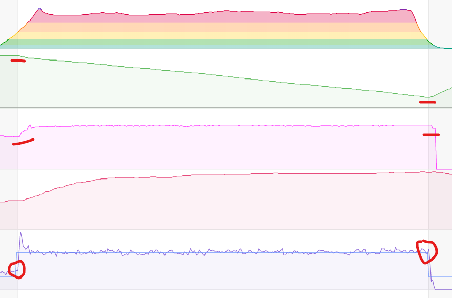

Here is one of my intervals:
I use the Raw Power first, along with (an expected) change in cadence. The W’ can also work if it’s above threshold. This is 5 minutes, so as @MedTechCD has said, below the value TP would deem “adequate”.
WKO and Intervals both import the raw data. I agree that the calculation is not ideal, which is why the raw data is better to look at. I don’t have a premium TP account, so can’t view the lap data.
WKO reports a different value to TP; Tim Cusick (WKO Product Leader) has mentioned this many times too, due to the way TP collects data. The data in Intervals and WKO match 100% (for my data, and also of those I coach that upload to TP>WKO). This is important for me, and the athletes I’m working with. I prefer WKO for some stuff and I prefer Intervals for other; it’s complimentary. Knowing that the data matches in these two apps ticks the accuracy/validity and precision/reliability boxes.

Same interval with graphics from each of intervals and TP
