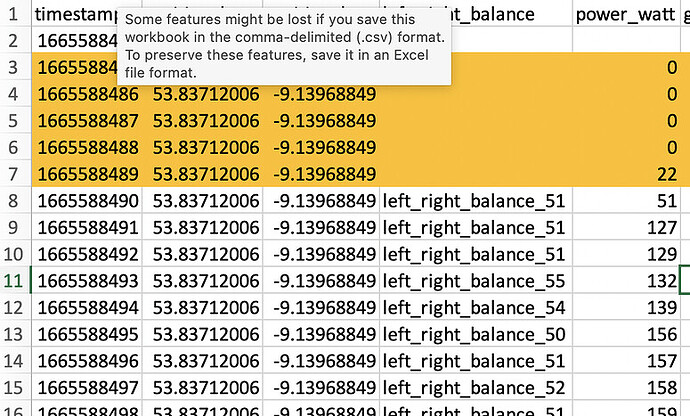

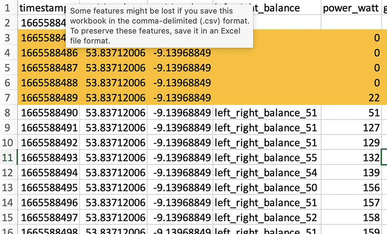

I uploaded a fit file to this thread before in csv format. I cannot for the life of me remember how I did it. Can anyone tell me how to view a wahoo fit file in csv format so I can get data from each second?
I did it before but can’t do it now :grimacing:
Edit - This site seems to be able to do it but I’m pretty sure I didn’t use that site before for this purpose
Convert FIT Files to CSV (gotoes.org)

I’m looking for second by second data like the gotoes.org gave me
Something like @app4g has in this post earlier in this thread
You can export the file as a TCX or GPX, then open in Excel as an XML table. You can get these files types from Strava and other device apps.
