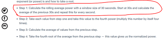

I wonder how TP are getting them numbers to align so? Interesting. I am so used to TP and so used to seeing NP and average align for well executed intervals that seeing 10 and 11 watt differences in Intervals drives me nuts :joy:
Fair enough folks. I’ll drop it!! Would love to know how TP calculate this though.
Me too, keep us informed if you find the explanation!
This is how…look here
So it is a 30s rolling average but they start at 30s. Intervals.icu starts at zero. Starting at zero makes no sense to me because you’re using data from a pervious recovery interval to calculate NP on a different interval
Haven’t read the article in depth yet but that would mean that the NP for 3 min interval actually gives a result for the last 2m30sec and the first 30sec of the interval are ignored.
What shows up as NP value when you modify the interval and drop the first 30sec in Intervals? That should then be very similar to what TP shows…
Yes. That’s how I read it too.
It does sound like TP is ignoring the first 30s of the interval. I decided to just cut a section out of the moving average for the whole ride. For short intervals you are probably better off just looking at the average power anyway and for long ones it won’t make much difference. I will see if I can add a sport setting to control this behaviour in future for people who want closer alignment with TP.
Thes @Gerald and @MedTechCD for all the input on this thread.
I haven’t time this evening but tomorrow I’ll try verify if this is indeed what TP do for individual intervals
Edit - just checked NP for last night’s session and TP and Intervals align. 253 watts. So it looks like you’re both calculating the same for entire session, just not individual intervals within that session…
