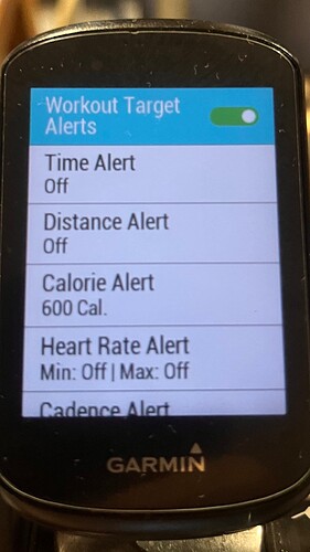

Not sure if this has been asked before. But is it possible to have a workout step where you set a Pace or a Power target but you disable the target on the target device? The way Garmin implements the target warnings where they take up all the screen for a few seconds is really bothering me, so I want to have Garmin workouts without any targets. However in Intervals I like to see my workouts visually laid out in the calendar, so I want the workout steps to have targets in intervals, but not forwarded to Garmin. I assume this is not possible, or is it?
I wasn’t talking about the workout screen. I was talking about target alert screens, which pops up every time you cross the target threshold, take up all the screen and stay up for a few seconds. At least that is how it works on my watch and its annoying since the alert only shows the pace / power when you crossed over, so you can’t see your current stats when that happens for a few seconds.
I’m afraid that setting is not part of the Forerunner 970 settings.
Did AI tell you that? :slightly_smiling_face: I also have zero alerts in that menu, so there is nothing to turn off.
Anyway, here is a link of you saying it is not possible.
Here’s the toggle on an Edge device
I don’t have a 970, so have to follow the same prompts to get a similar outcome when using a Google search.
On the Garmin Edge bike computers you can turn off target alerts. I’ve done that and never receive the alerts.
Strange that Garmin doesn’t offer that for their watches. There have been forum posts going back 10 years I think of people requesting this, but still no change in 2026.
Hey, sorry if that AI comment rubbed you the wrong way. My experience with AI is that they like to lie about stuff. Anyway, thanks for trying to find a solution. However I wasn’t looking for a solution on the Garmin side, since I’ve done the research already and knew it couldn’t be done. I’ve came here to query if I can achieve this somehow through the Workout builder. But I guess that isn’t an option either. Too bad though, since my only option is to remove targets in the workouts and then there will be no visual representation of the intervals.
Anyway if any of the devs is reading this, a toggle to disable the targets on the generated workouts would be useful to some of us (mostly Garmin watch users I presume).
