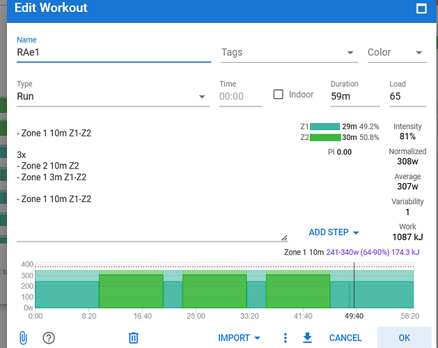

Hmm, I just put Z1 and then it automatically fills in the wattage. I never fill in the actual wattage. Here is a screen shot of what it looks like when you are editing/creating a workout. The actual watts get filled in after.
BEFORE
AFTER
the zones allow me to run in a range which are configured under setting per my FTP.

The tickbox (bottom left) includes/excludes the values in brackets.
Save the workout, then opening it again, reveals the tickbox.
