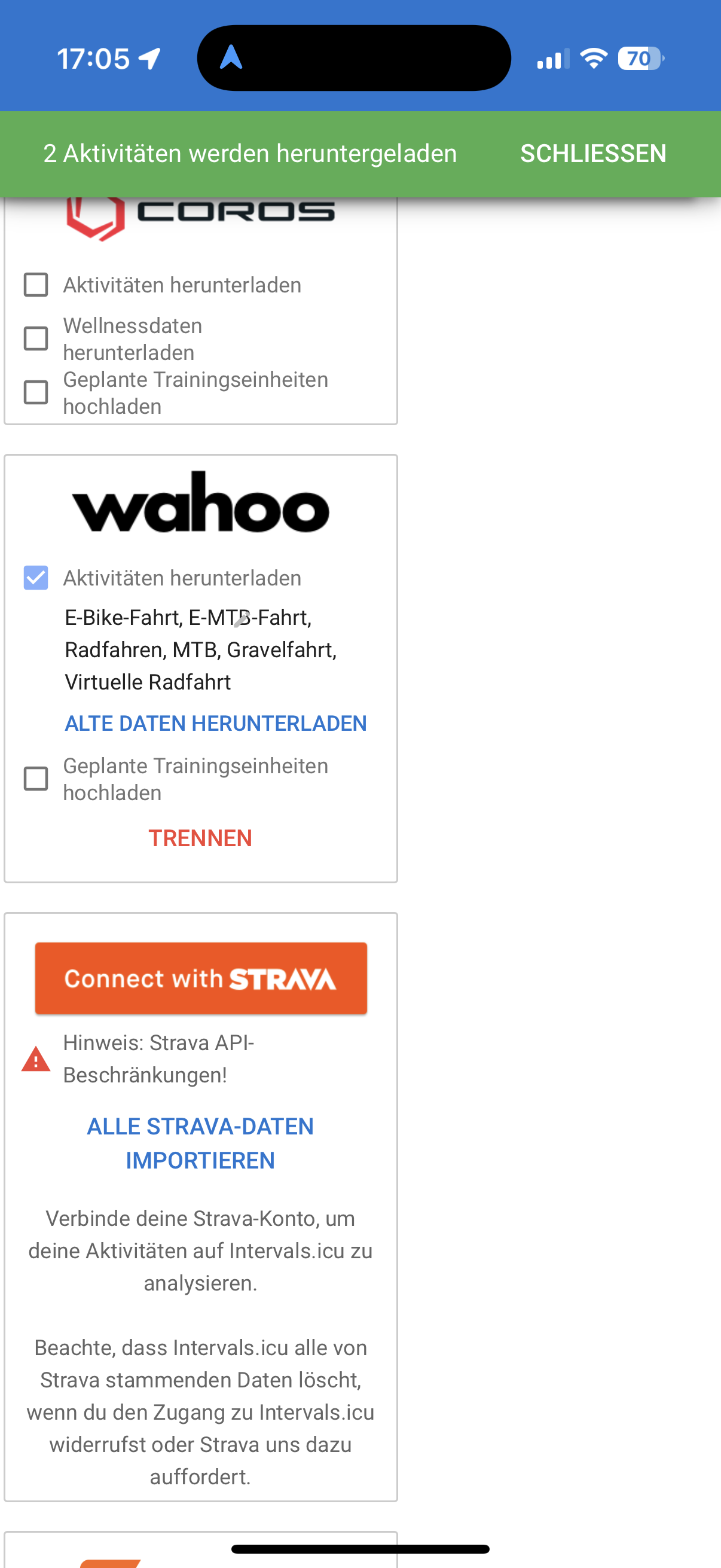

My indoor ride yesterday as well as the one today don’t upload to Intervals. I have already re-authorized Wahoo, filter for all types of rides is set. When I go to upload old data and select yesterday until today, it shows correctly 2 activities being uploaded from Wahoo, but the nothing appears in my activities.
There are some issues for zwift rides and wahoo, yes.
Thanks, didn’t see that.
