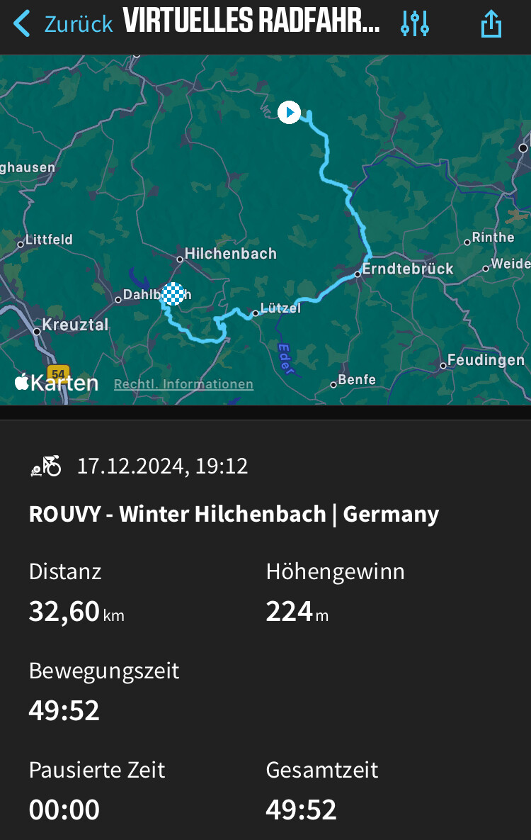

@david Would it be possible to import the name of the ride from wahoo, too? At the moment it is just Afternoon Ride or something, and not the name from wahoo.
if I read the API docs right, it should be accessible via the cloud api in: workout_summary.workout.name
https://cloud-api.wahooligan.com/#workout-summary
I just pulled some of your data from the API (/v1/workouts) and Intervals.icu is already using the only name field I can see:

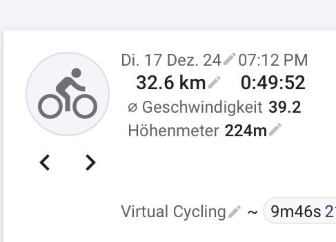

The problem is maybe only with indoor workouts, because they are different:
IMG_1525
Still only the one name field and it says "“Virtual Cycling” :frowning:
Good to know, thank you for looking at this. :slight_smile: I’ll open a ticket at wahoo’s side.

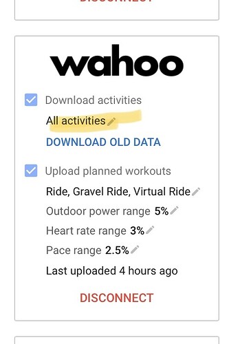

That what I did but now virtual activities are uploaded twice. Once from Zwift and then from Wahoo :cry: how to undo?
Just delete the ones which you won’t want to keep.
Set a download filter for not downloading virtual rides from wahoo.
Not sure if you can do that on the Wahoo connection…
But if the Zwift ones go to Wahoo, you wouldn’t need the Zwift connection to Intervals for activities?? Just set the Zwift connection to upload planned workouts and disable the download activities.
Yes you can do that
I think it’ll be easier to not disconnect Zwift > Wahoo connection as the latter doesn’t bring any value. Therefore, only new Wahoo outdoor rides will get uploaded to intervals.
