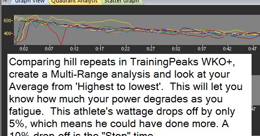

@MedTechCD Excellent points…I find the go all out to exhaustion challenging to determine. I simply try to stay at consistently stay at correct above threshold power level % for the interval. For HIIT intervals above FTP/CP a lot obviousy also depends also on the effort to rest ratio (which I assume is related to Tau time constant recharge for W’ although it is likely to be non-linear? I have heard two expert anecdotal comments for VO2max intervals I thought I might share.
- I once heard Hunter Allen comment on a -% threshold (i.e. subsequent intervals % vs initial interval) that he used to indicate your workout was no longer as effective and you should stop the interval session. I can’t remember the exact value but thought it was -20%? Has anyone else seen this type of guide.
- For VO2max interval effort/rest ratios, I have heard some various opinions on optimal effort/rest ratio. I did hear Peter Attia comment on a recent podcast the strives for 4min intervals at 1 to 1 Effort /Rest interval. (there is also question regarding whether the rest should be complete rest or some active power…but that goes deeper down rabbit hole!)
It a 10% drop. He mentions it here.
Optimal is dependent on how quickly you recover. 1:1 is generally prescribed as ideal, but if you need 30 seconds longer to recover, which means you can get a consistent average power across all intervals (first to let), then that’s okay too.
