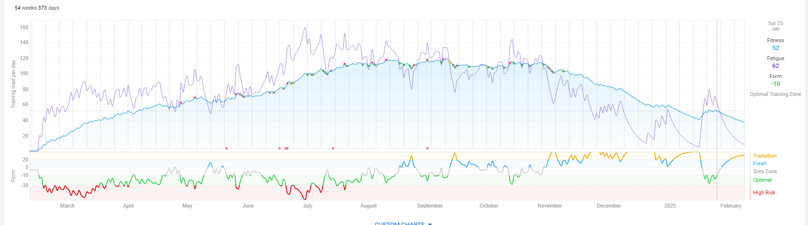

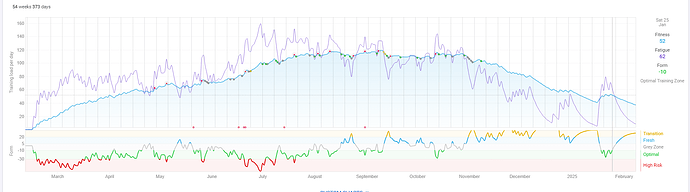

I noticed that fatigue increases significantly in colder weather and this is reflected sharply in the graphs, unlike in warmer weather. This made me wonder: why is this happening?

I’ve been cycling for several years, and over this time, I’ve noticed an interesting pattern that’s been bothering me, especially during the cold season. I have a regular 50 km route that I ride consistently. In the summer, I cover it at a speed of about 30 km/h, and there’s almost no fatigue, especially if I’ve properly warmed up before. However, as soon as the cold weather hits, for instance, when the temperature drops near zero, I experience significant fatigue, even when riding at a speed of 15-17 km/h.
What’s interesting is that in the summer, when I get tired, the fatigue accumulates normally and gradually. But in winter, the feeling of fatigue often passes faster — sometimes after just one day of recovery, I feel much better.
I dress warmly, I’m not cold and don’t feel chilled, but despite this, the fatigue feels much stronger than in the summer. During the summer, I can ride longer distances, even 100 km, without experiencing the same fatigue issues that arise in winter.
