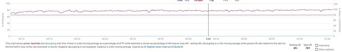

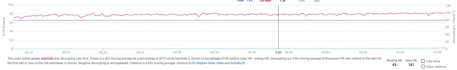

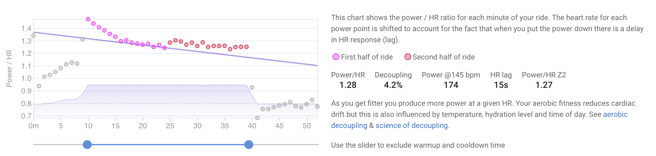

Hello, speaking of decoupling, I did this Z2 session this morning.
It was getting harder toward the end and Garmin condition status was poor (doh) but the decoupling was not that bad accoridng to intervals.icu, so I guess I could have pushed longer to see if it raises further and get a little notch up in the cardiac drift ?
(btw by measuring lactate and feel I have a quite good idea that it’s top of Z2 here)
