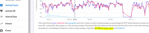

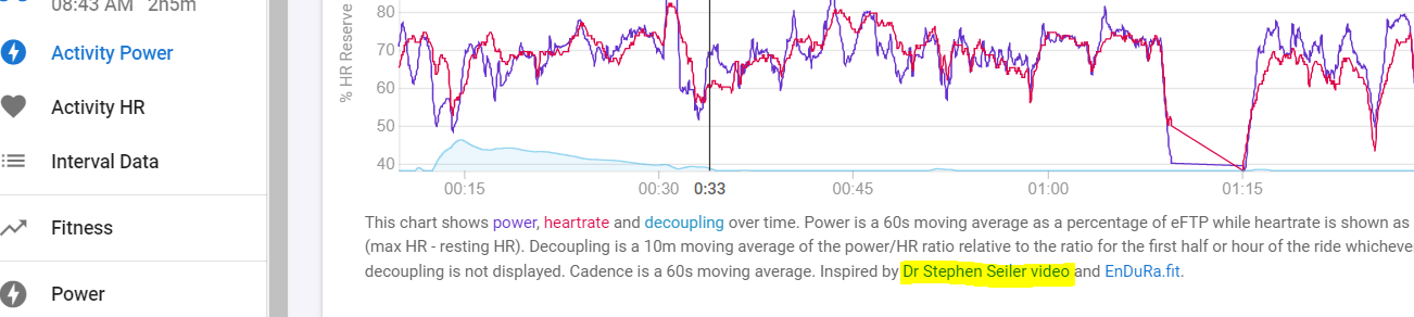

Not at all. There is a video on this specific graph where he stresses several times that you should stay hydrated and fueled when doing this kind of ride where yo check for decoupling. Will look it up and post a link later.
The video link is in Intervals right below the decoupling graph.
Not only here. In a Youtube video from a couple months ago, he specifically apologizes for creating this confusion. Thatâs the video where he ârewordedâ HIT/LIT sessions into a bucket with easy and a bucket with hard workouts.

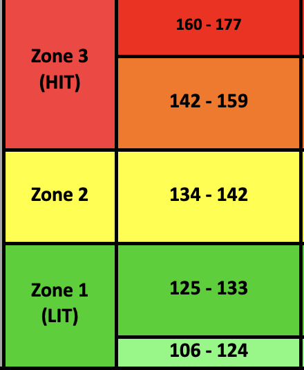

I must admit I think my original question has not been correctly understood by some. Could be my grammar being at fault. Basically âis 90 mins Z1 a High or low Intensityâ

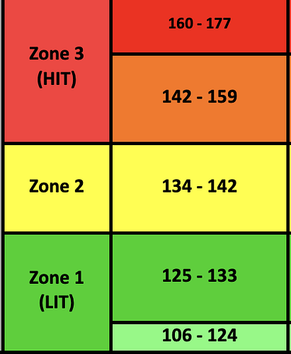

I perhaps should also mention that the 3 zone model I am using does divide zone 1 into two secondary zones as is zone 3. See attached
90-mins in Z1 is low intensity irrespective of duration. Z3 would be high intensity.

I should have added more context to my reply. I have definitely noticed the HR/PWR decoupling in my easy rides but there are so many things that can cause it, including dehydration, insufficient fueling, excessive heat, or even a brief effort outside of Z1. Upon reflection, I would interpret Seilerâs advice the same as the classic advice for intervals, namely: you should stop the intervals when you stop recovering in the interval rest period. So for Z1 you are trying to ride as long as possible before the decoupling occurs. Once the decoupling occurs, you are no longer benefiting from a Z1 ride even if your HR goes back to Z1. So the best Z1 training would be fully hydrated, fueled, cooled, etc so you can ride in coupled Z1 as long as possible.
True, I should have added Z1 Power but Iâm getting so used to power zones that I forget to specify.
Hmm⌠I can definitely make much more than Z1 power in Z1 HR before the decoupling occurs, and I can also ride in Z1 power after the decoupling occurs. So I would think Z1 is more about HR than power, although you need the power to identify the decoupling.
Iâm still not entirely following you.
Riding Z1 doesnât mean that you have to ride bang on your AeT, it means riding about 5-10 beats below AeT. That gives you some room to decouple and still stay in Z1. You should ride long enough to inflict some decoupling because thatâs what progressive overload and adaptation is about.
Damned, these zone definitions definitely make it hard to explain. As you say, there are two ways to determine decoupling. Keep power constant and let HR drift up or keep HR constant and let Power drift down. But most people talking about decoupling base there discussion on a HR drift caused by constant Power.

My main point is: striving for the decoupling cannot be the goal of Z1 training because it is trivial to force the decoupling whenever you want. So it seems to me the goal must be to stay in the coupled state as long as possible.
