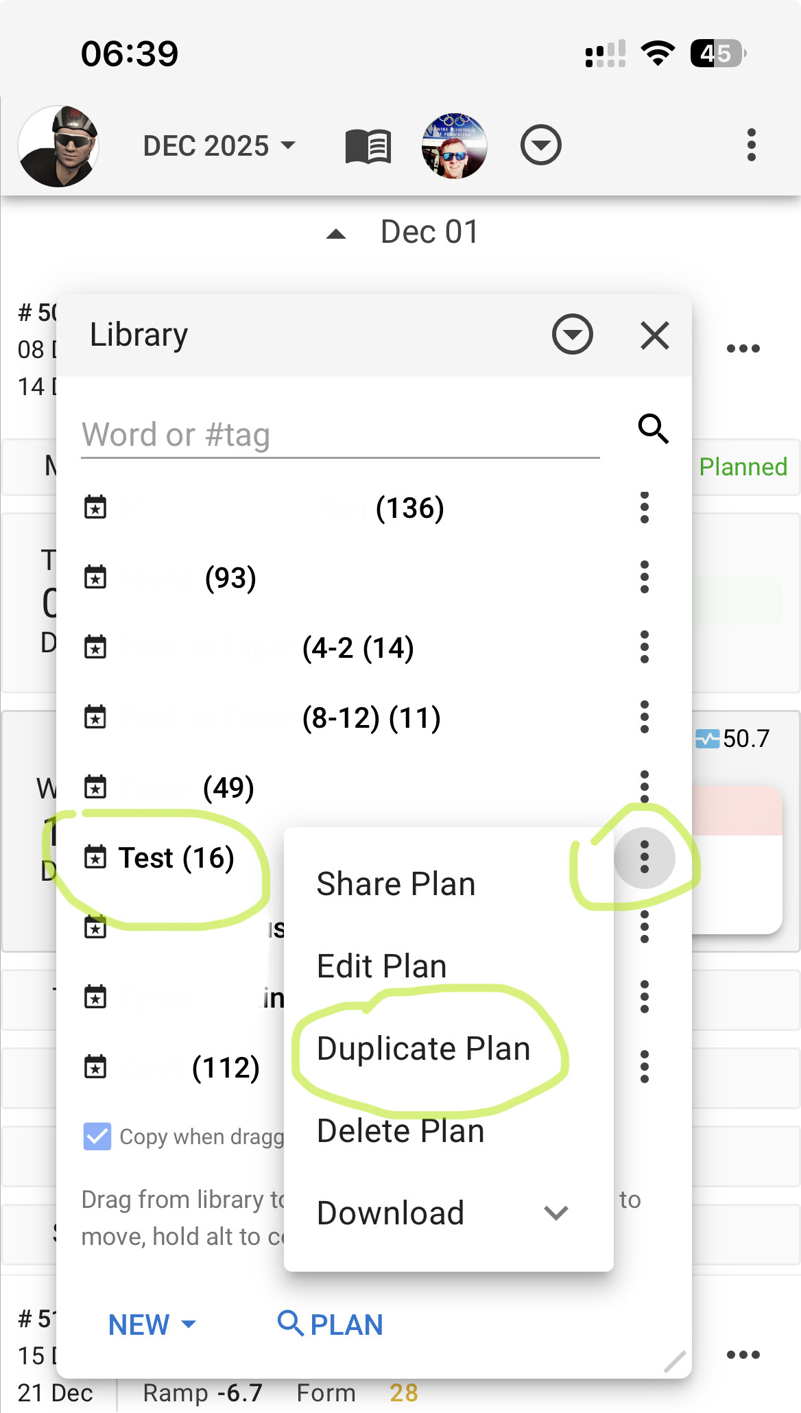

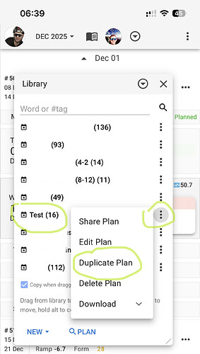

Is it possible to duplicate plans that I’ve added to my Library via the search function?
I want to make edits to a plan however when clicking the three dots I’m unable to duplicate the plan like I can one of my own.
Create a new folder, and make sure the “copy” tick box is ticked. Then drag and drop from your current folder to a new folder.
Just given this a go however it only seems to work for workouts as opposed to complete plans (including ones I’ve created myself)
To copy a plan, there is a duplicate option.
Unfortunately that isn’t showing for a plan that I didn’t create
