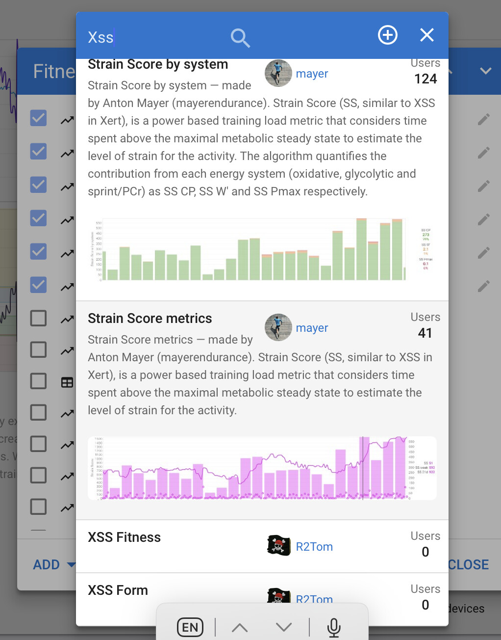

There is XSS Strain Score
We have started implementing some of the ideas in this paper (Xert uses a similar model):
Nothing is live yet but I like the first results. You get a trace with the relative contribution of each energy system (aerobic, glycolytic and PCr) as well as a strain measure that can be used to calculate a TSS like score (strain score = SS) for the activity. SS can be further broken down by energy system.

That seems to reflect a bit more the reality (97 for the intervals, 80 for the base).
Is there a way to use it to calculate fitness, beside manually editing the load to match the XSS? Thanks

If you are really sure you want to use it, then you can create a custom script and this will overwrite your load value with your own calculation:
if(icu.activity.ss_p_max && icu.activity.ss_w_prime && icu.activity.ss_cp)
icu.activity.load = (icu.activity.ss_p_max + icu.activity.ss_w_prime + icu.activity.ss_cp);
Then your overwritten load is used for fitness charts.
Other method would be to create your own fitness charts based on XSS. You can use the XSS Fitness and XSS Form Charts as base.
