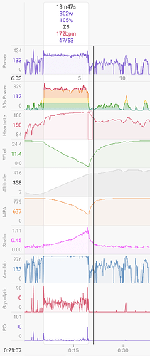

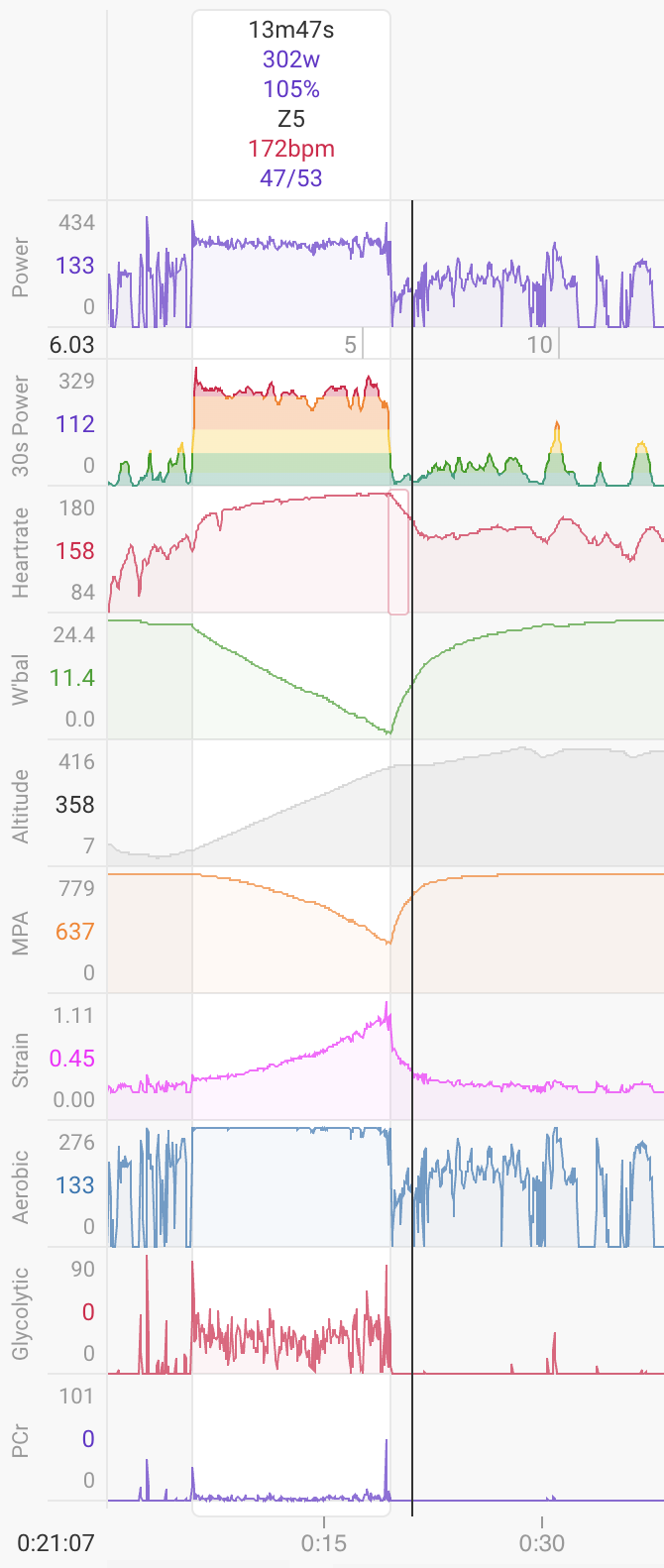

We have started implementing some of the ideas in this paper (Xert uses a similar model):
Nothing is live yet but I like the first results. You get a trace with the relative contribution of each energy system (aerobic, glycolytic and PCr) as well as a strain measure that can be used to calculate a TSS like score (strain score = SS) for the activity. SS can be further broken down by energy system.
(none of that is live yet)
What I hope this will bring to Intervals.icu:
  • Per activity breakdown of aerobic, glycolytic and PCr contribution for better monitoring of what you were actually training (better than time in zones?)
  • SS (also per energy system) as an alternative to TSS for training load
  • Per energy system ā€œfitness over timeā€ scores so you can make sure you train all the energy systems ahead of goal events

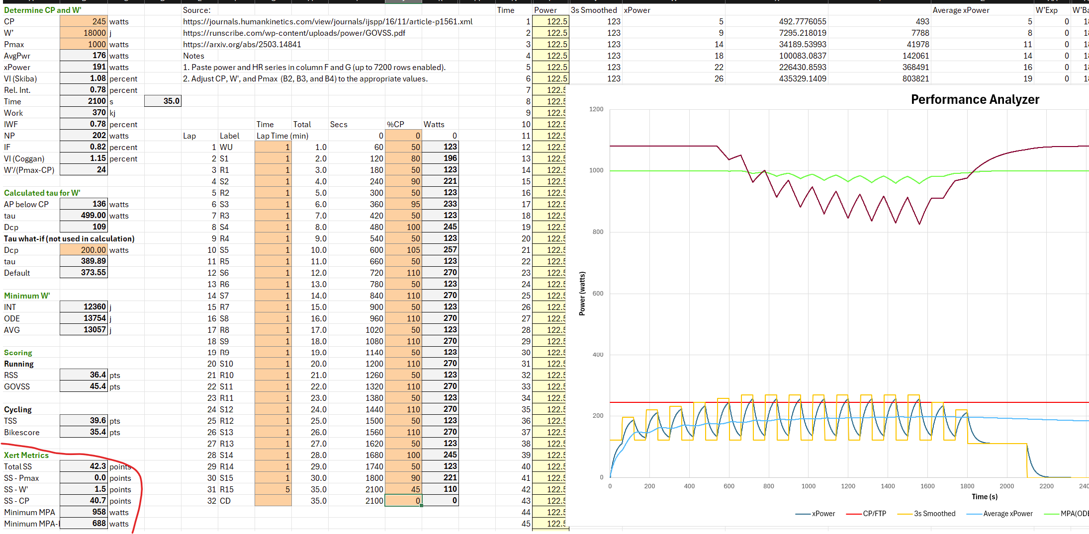

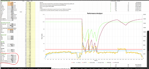

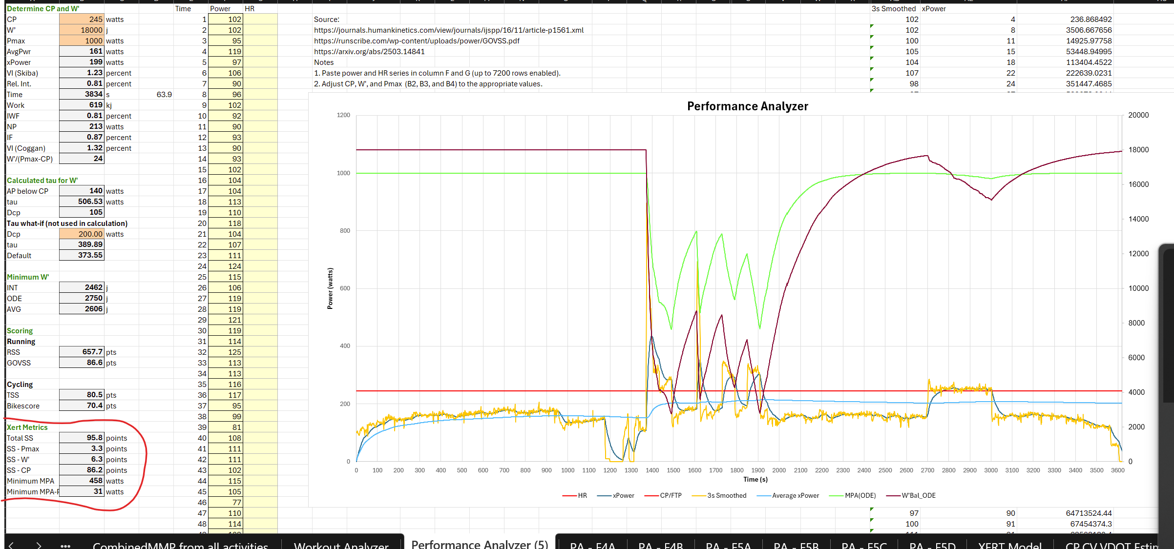

From the paper, Xert uses Morton’s 3-parameter model. In my experience, this model produces reasonable estimates over time. I like the system and think it has some usefulness, so I did a spreadsheet implementation.
Workout planning
Workout analysis.
Also, there is another paper describing MPA. I believe the MPA equation is slightly difference than in the newer Xert paper.
Xert MPA paper

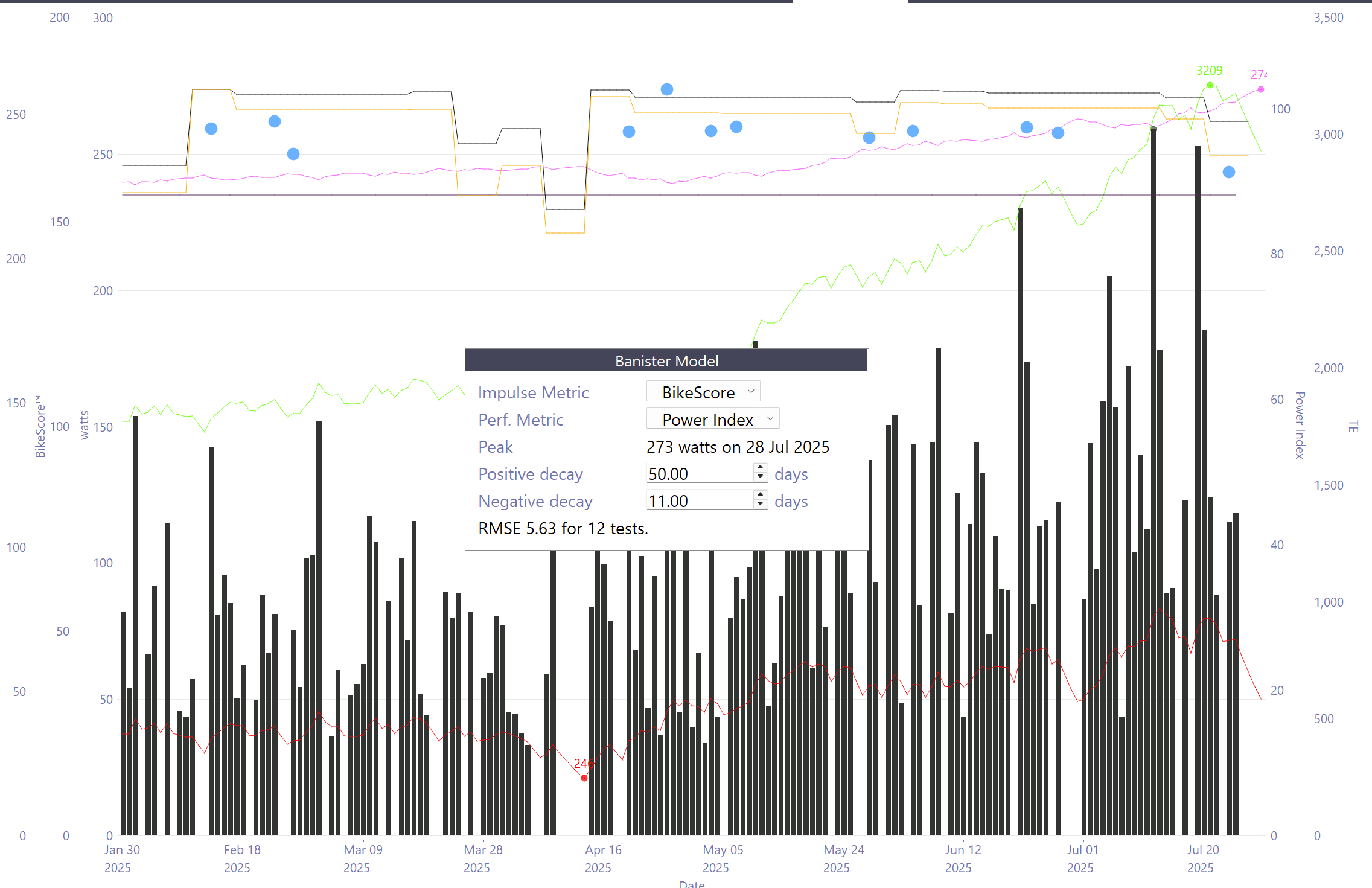

Are you planning to implement Bannister’s models for each strain score component? That’s the main benefit of this system I think. Golden Cheetah’s Banister model is a great example.
