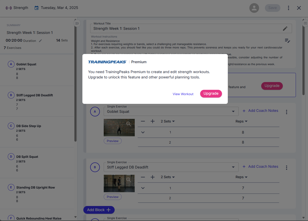

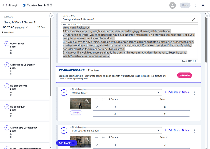

When I click on a work out, I am met with the below instruction regarding premium in TP.
Then if I click view workout, I can read and interact with it.

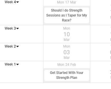

When I select the plan in Tp2intervals, It downloads only 4 of the 36 workouts, and when I load it in intervals, it is just the note entries.
mind you, this was a free plan and I am not super worried if I cannot copy it over. Was just surprised as all my other plans came over remarkably easily. Thank you again btw.
Nice, do you have link to this free plan or any free strength plan? I would like to reproduce it locally.
When you copied the plan, have you checked Strength or Other in Workout Types select? By default, it’s not selected.

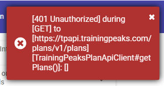

Hi there! Thanks for the tool, this is an awesome idea.
I am running into a 401 issue when trying to copy plans from TP to Intervals. Did anyone run into something similar?
Hm…that’s odd, I will check it today.
OK, no idea what happened but it worked just now. Perhaps, for whatever reason, it took some time to sync.

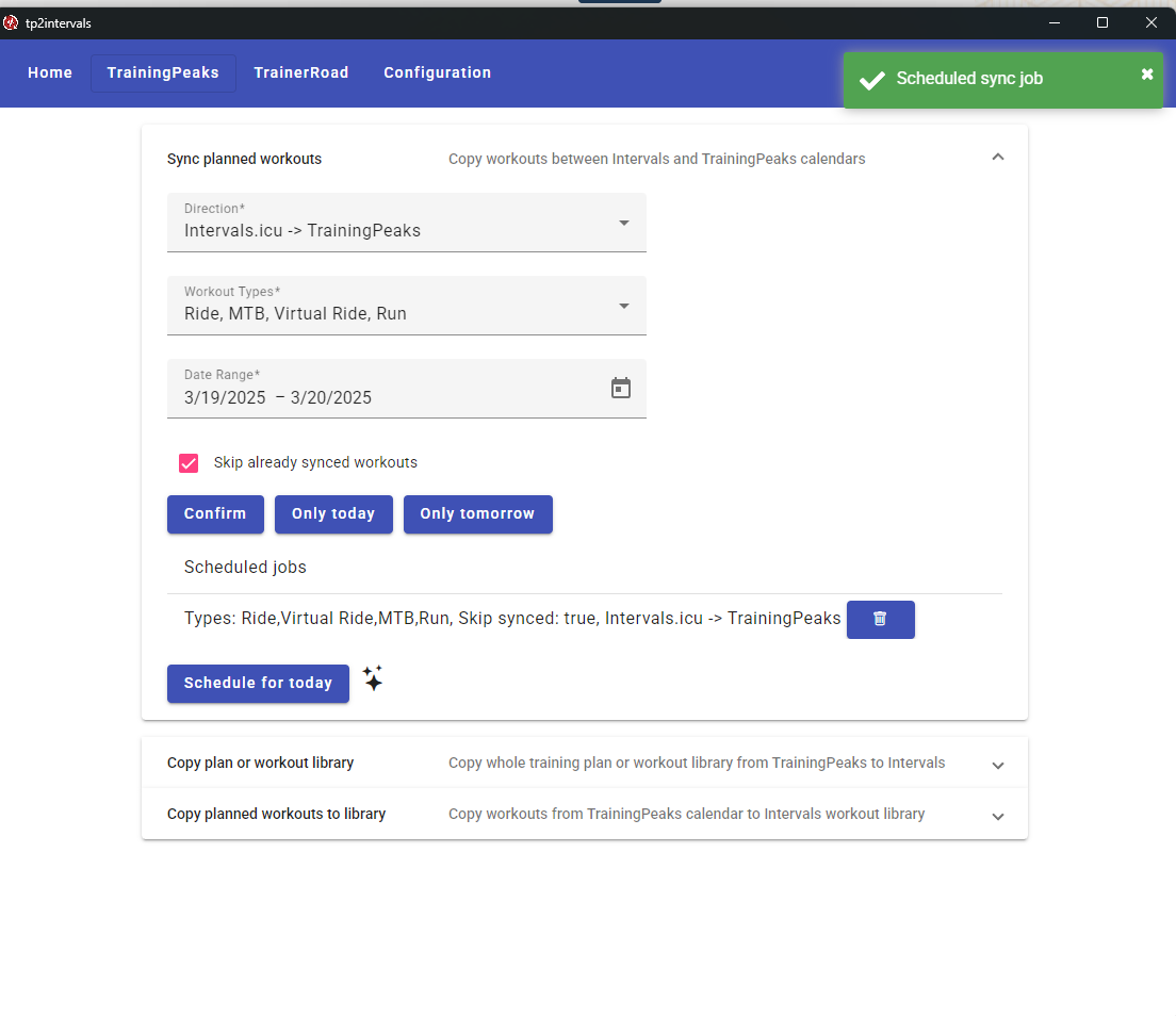

On UI almost nothing has changed (icons added\moved). But from now on your scheduled requests will be restored when you open the app next time.
How do I delete a scheduled job i have created for TrainerRoad?
I ended up with multiple versions of yesterday’s workout in Training Peaks Virtual. There seemed to be a new version of the workout created every 20mins.
Oh…it turns out button to remove job is not visible on small window. Resize window to bigger size, you should have the button
Yeah, actual job is run every 20min.

Just got this installed to solve a specific problem: I use Athletica.ai to build my workouts, which sends to Intervals.icu as of this week, but I use Fuelin for nutrition, which integrates with TrainingPeaks. Was just able to send today’s workout to TP from Athletica for the first time via Intervals. It looks like we can only do today and tomorrow, though, correct?
If you have free TP account then yes, you can schedule workouts only for today and tomorrow.
