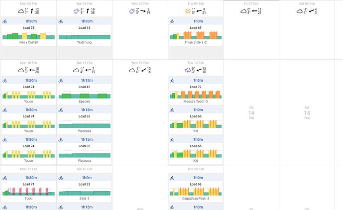

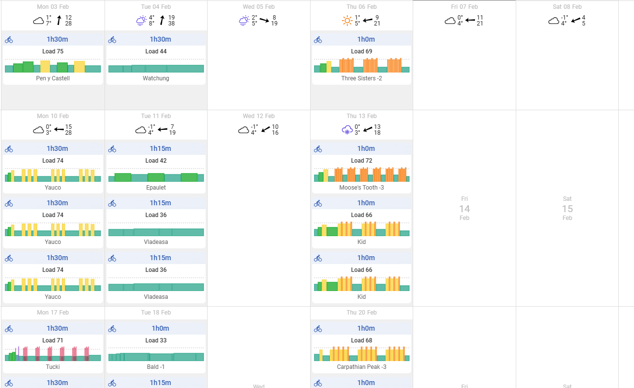

Ignore already synced workouts doesn’t seem to be working…
Can you show few last lines of workout description?
Also did you changed workouts in some way in TrainerRoad?
Just use ChatGPT. Ask it to create you a zwo of any TR workout and it gives you the text.
Sorry haven’t been able to check the details, but no the workouts are identical. It’s possible they get some sort of new ID or something every time TR adjusts your plan.
The last lines of the workout description contain data for workout skipping. Something like:
////////// trainingPeaksId=222 trainerRoadId=333
If this data is not present, the workout will be synced again. If some of the ID is different, the workout will be synced again.
That code is only in 1 of the 3 workouts - so maybe the duplicates are from a previous version.
I guess if TR changes the prescribed workout for that day, you will end up with 2 workouts.
Yes, this is possible. The feature was added only in latest version.
You have only one workout with the code, so I would say the feature is working fine and workouts are skipped. If it didn’t work, you should have more workouts with the code.
