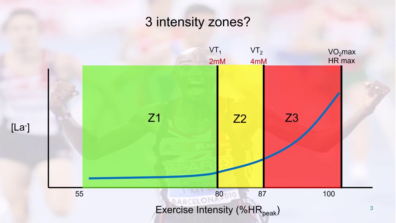

Thank you for you input.The reason for my question is that it seems to work well with the polarized metrices built into intervals to place the top at 100%. It just makes that calucation cleaner and didn’t know if I was missing something. If you place it at 105% you are putting your intervals done at 100%-105% FTP in zone 4 therfore being calculated as seiler zone 2 instead of seiler zone 3 where I belive they belong.

Note that he uses HR (% of HRmax) at VT1 and VT2 to differentiate the zones, not traditional power levels on their own. Also note that he said you have to measure it (annually), and not just estimate it.
Agreed and those intervals in the 100-105%FTP range end up for my athletes in the >90% MAX HR putting it in seiler zone 3. But that is not the issue, it is that intervals.icu calculates polarized as zone 1,2 then 3,4 then zones 5 plus. That is why I adjust to 100% of FTP for the top end of zone 4. I just wanted to make sure I wasn’t being naive by doing so since the rest of the world seems to use 105%. I get the physiology of the work done and it doesn’t change no matter what zone we call it. In fact those intervals I prescribe don’t go by zone anyhow so zone 4 for me is only a retrospective look. The zone metric as I’m looking at it is to quickly and easily see if the polarized prescription is being followed. And setting zone 4 at 105% makes that a bit harder to read. Am I missing anything?
It aligns with “each person is individual”. David mentions adjusting to 100% in this post.
Oh well there you go. Thank you so much for that helpful info. I missed that post by David.
