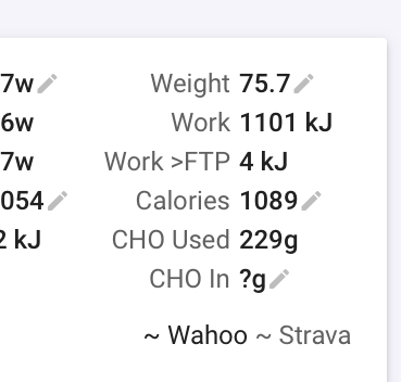

Top right corner you should see “~wahoo” next to Strava
IMG_0311
