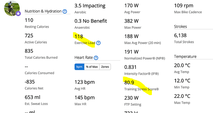

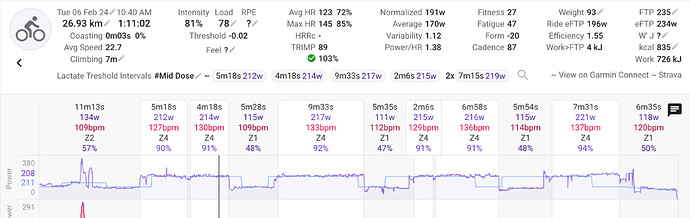

I notice that intervals.icu shows different load than Garmin. I did a workout today and intervals.icu shows load of 78 while Garmin 118. My feeling is that Garmin is off because the workout was just over an hour with 4x10 min intervals just below treshold. I definitely didn’t feel like I did an hour of FTP. Still does anyone know why are the two numbers different.
Here are the screen shots.

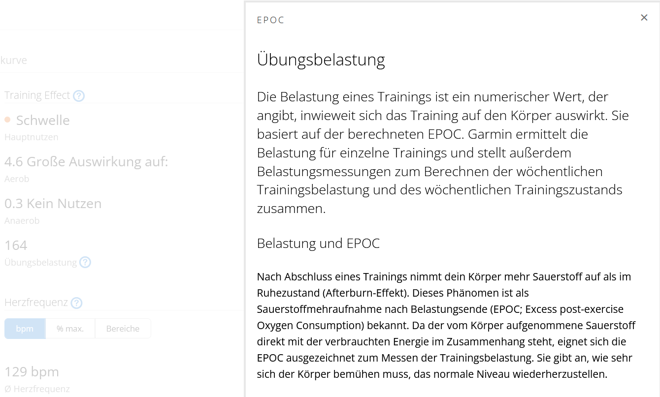

I mean, Garmin’s load comes from the Epoc value and Intervals calculates your load from other values. There is already a post about this in the forum, but unfortunately I can’t find it.

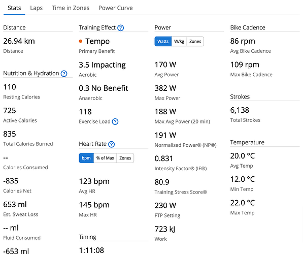

The answer is in your own screenshot :wink:
Garmin uses its own proprietary ‘exercise load’ number based on epoc but also displays the more widely used TSS:

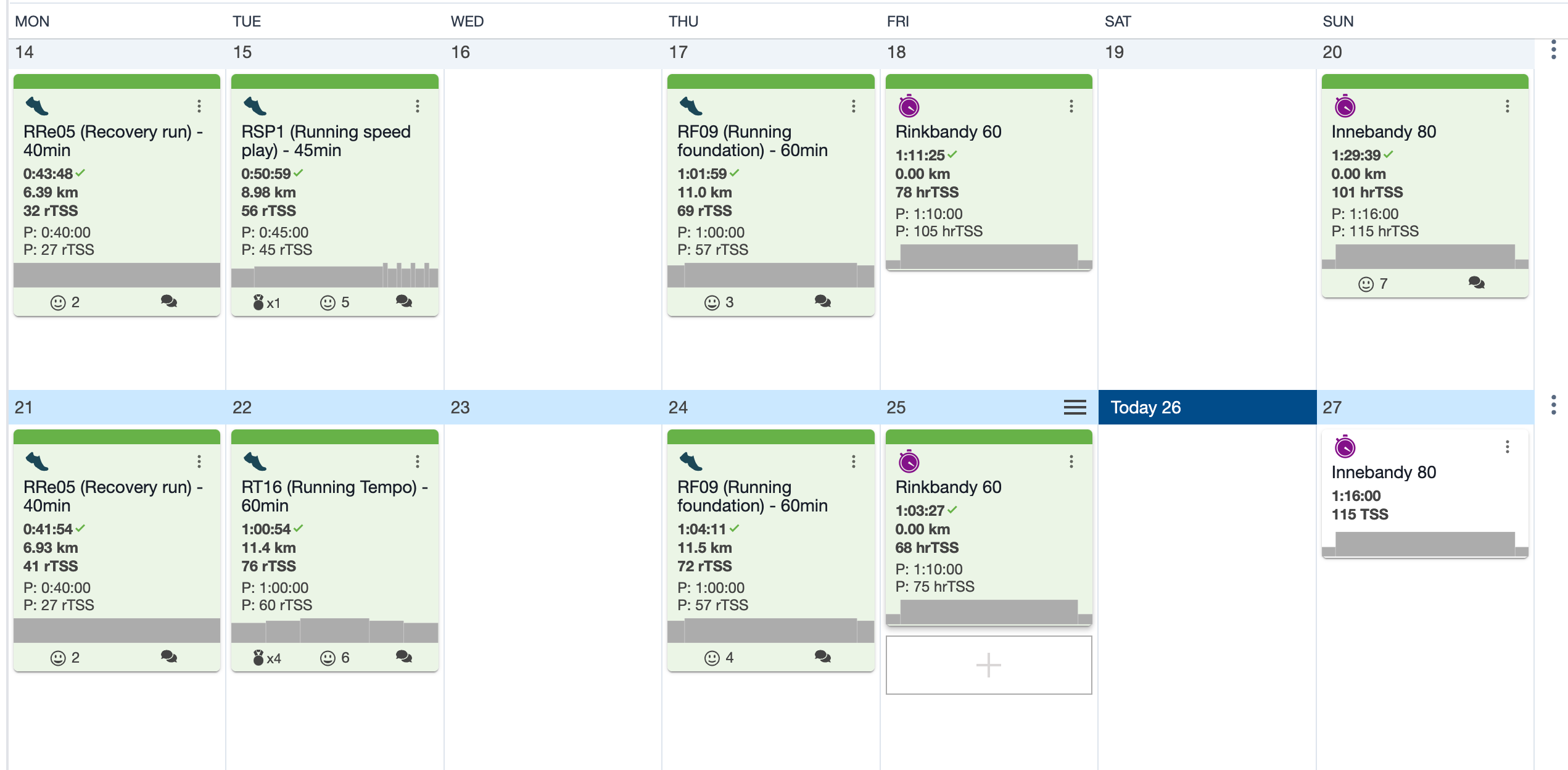

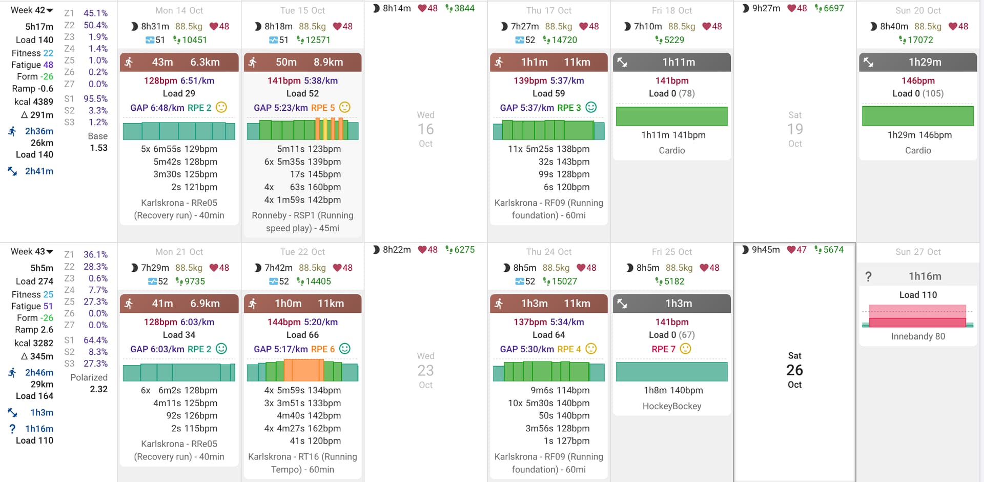

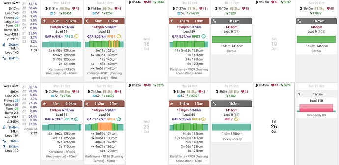

Two screenshots show a few completed workouts in TP and intervals.
How come they differ?
I am a runner although i play some icehockey and floorball.
My thresholds are set the same.
My understanding is that load should be more or less the exact same thing as TSS so I should not expect more than a rounding error.

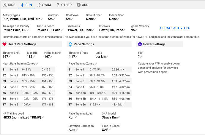

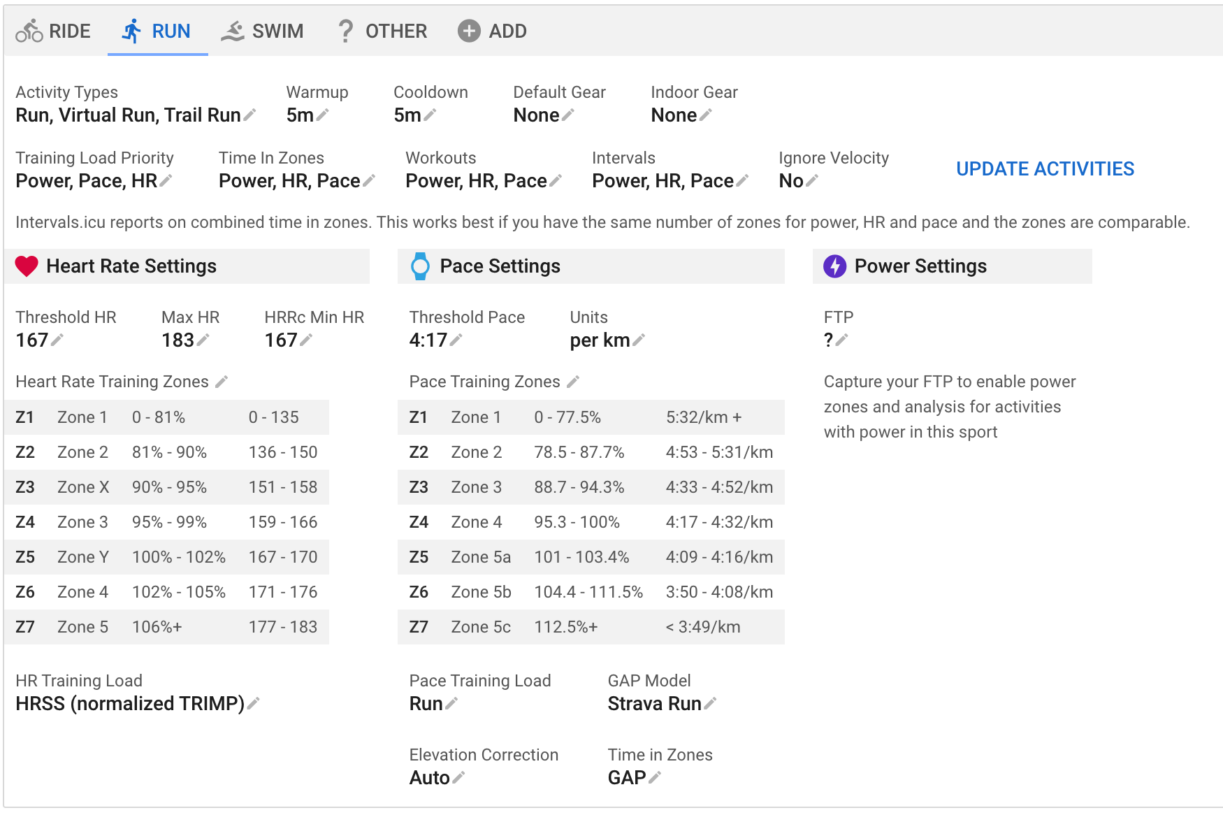

Below is my zones settings. I have read as best I could here on the forum and elsewhere but perhaps someone can help me understand why there is a difference.
I could imagine that there are differences in the calculated graded pace (GAP). Intervals uses the Strava model for this, TP probably uses its own.
Is the GAP the same or is it different?
Thank you for answering so quickly.
I messed around and recalculated the workouts with GAP models and other settings. There was some effect on load for the depicted workouts but stilla far ways off the tss from TP.
