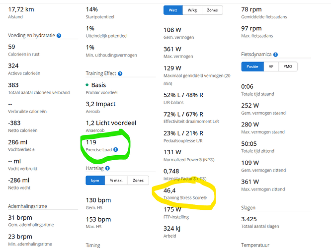

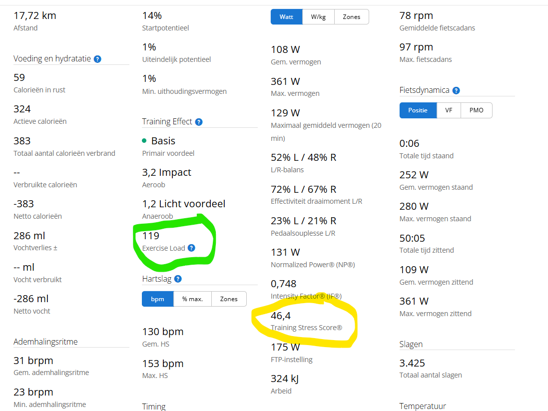

Look at the summary from Garmin connect:
The yellow value is TSS and should exactly match what Intervals is calculating (if your load priority is set to Power first and your activity has Power data)
The green on is Garmin’s own way of calculating load and is based on Epoch.
You can’t compare or interchange those two because they are another way of measuring Load. The trend when using one or the other should be very similar, but you can’t mix them.
Your Garmin device can have a field for one or both. Just make sure that the field on your device is displaying TSS and NOT Exercise Load.
