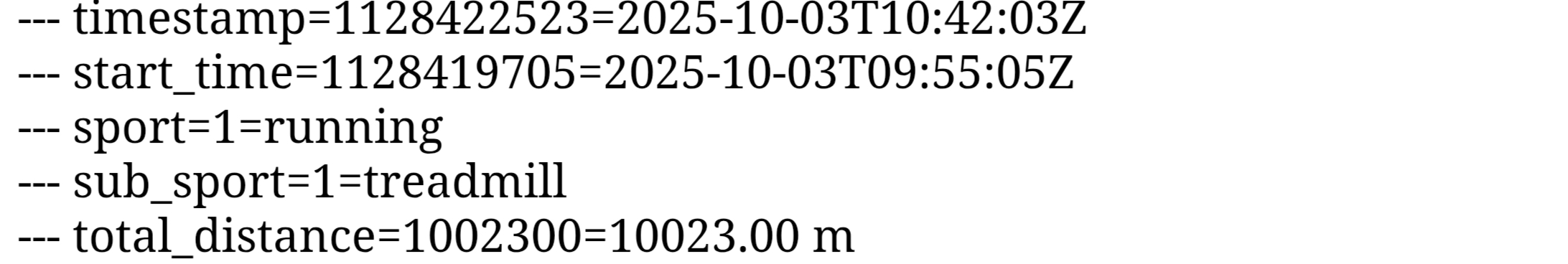

So, I checked the fit file. In the first section there seems to be no difference between a running activity and a table tennis activity.
At the end of the fit file there is a kind of summary (duration kcal, etc.) and in this section there is a difference.
For running it states: sport=1=running
And for tabletennis: sport=0=generic

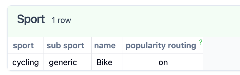

In the above,
sport = Cycling
SubSport = generic (could be road cycling, trail cycling, gravel cycling etc)
If i were to interpret what you wrote.
Sport = 1 = running ← this is the “sport”
Sport = 0 = generic ← this is the “SubSport”

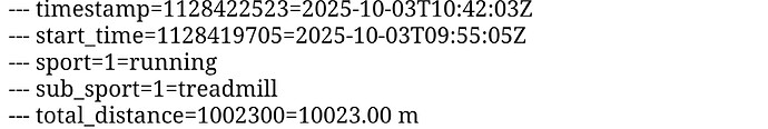

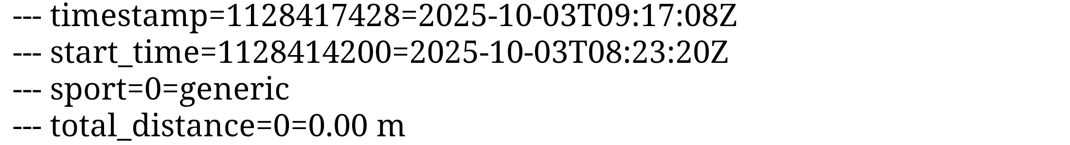

Maybe I stated it not clearly. In my examples the running activity gets labeled in the fit file as running and the tabletennis one as generic.
See the following screenshots:
The first one is the running activity. It also has a sub Sport declaration.
The second one is the tabletennis activity. It has only the label “generic” and no sub_sport label.
sorry, you’re not using fitfileviewer.com, takes some getting used to the output.
okay, based on your 2nd screenshot. the sport = generic.
Looks like high possibility that the mapping for generic isn’t being mapped correctly in intervals.icu

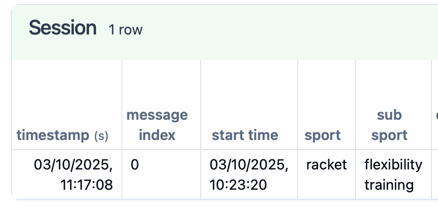

From fitfileviewer.com:
That is not very helpful. I will contact Zepp about this. You selected “Table tennis” on the watch right?
Yes I did select tabletennis on the watch. Interesting and I think this is the cause that runalyze categorizes all my table tennis workouts as strength workout.
