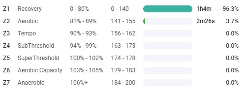

I am trying to figure out some weird mismatches between my heart rate and power zones. Essentially, it seems like my zone 2 power often corresponds to zone 1 HR, and I’m able to do silly-long “threshold” rides by power zones, which makes it seem that my FTP should be higher compared to threshold HR. However, almost every time I do a threshold test (or when I was racing, after almost every race), I get a notification that my threshold HR should be higher. I seldom hit my target power at the same time.

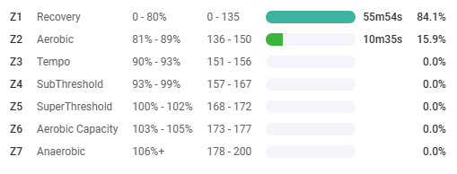

  • Zones pasted below for reference. My previous 42 days have been a bit whacky because we had our first child at the end of July :slight_smile:
The only thing I can think of would be to nudge my Z1/2 power zones higher, compress 3/4, keep FTP the same, and turn off power spike detection. That’s addressing the numbers discrepancies, but are there any underlying physical issues that I should address or look deeper into?

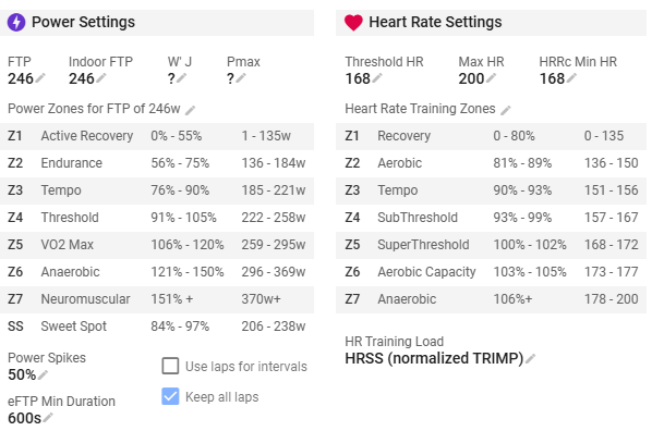

@WindWarrior Interesting, the explanation for power spike correction mentions that it’s based on FTP: “Power spikes are detected by comparing your power output to what you should be capable of based on the power duration curve for your FTP… Also consider raising your FTP if many spurious spikes are being detected.”
I’m not an expert so I just took that as gospel, but maybe those of us with more punchy power curves should turn it off or set the threshold high?
Also re: @WindWarrior I could switch to a 6-zone model like yours to maybe help. The HR percentages in your model seem pretty low - the upper range of endurance is on the lower side of my current Z2. However, it does match up my avg power to HR a bit better on many rides (norm. power is of course way different, as is time in zone). I have some exceptions (4h50m with an average of 151bpm, 4h38m at 165bpm average :grimacing:) but those were rather intense rides and probably not “healthy” :laughing:. I do think however that if I used those zones I’d have even rides classified as tempo for power and recovery/endurance for HR (based on zones rather than average).
There’s quite a number of users which have it set to a high number. Mine is at 80% because with the standard value, there was clipping for sprinting power.
If your Power Meter is reliable, this setting is actually not needed. But there are some Power Meters spitting out spurious high values.

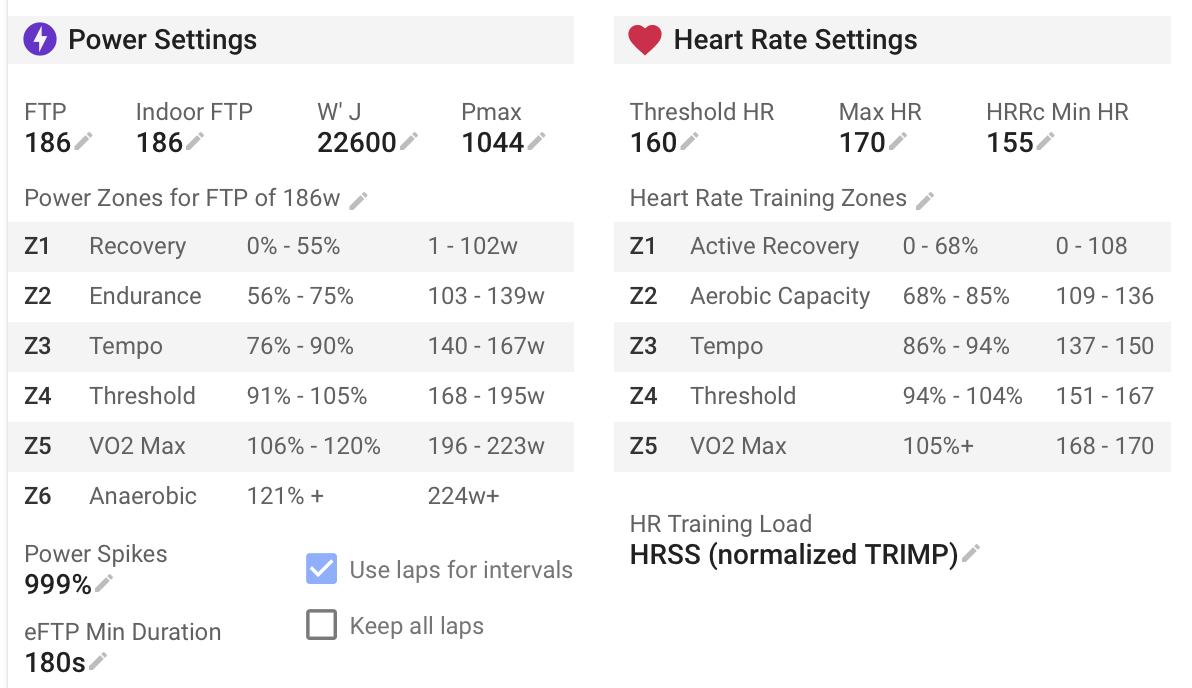

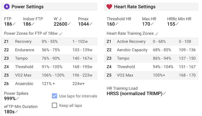

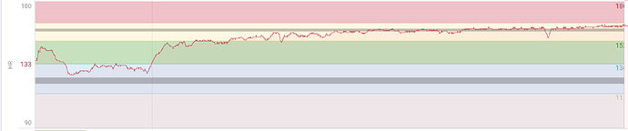

Here are my current settings - and I haven’t been riding for a couple months:
Back in 2016 I started using Friel HR zones, which I believe are the default for Intervals. A couple years ago I switched to Coggan zones, however I don’t really use those.

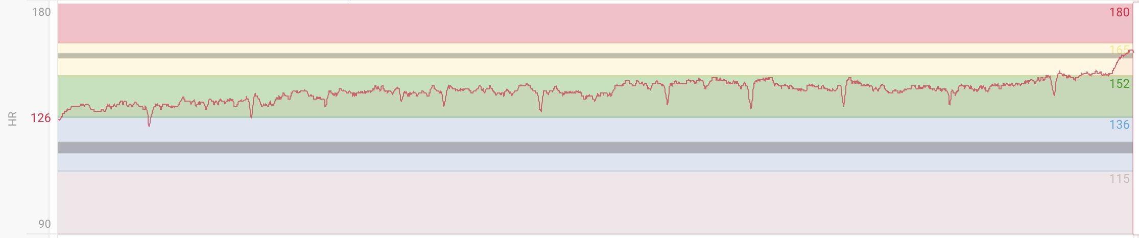

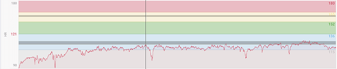

Instead I have “field based zones” and a custom HR chart so I can eyeball HR:
1 hour easy - HR mostly below the lower grey band inside the blue “HR zone2”
and 32 minutes at FTP:
HR zone4 is yellow, and the upper grey band is HR at FTP (LTHR)
and 90 minutes of tempo up an HC climb, with a 15% kicker at the top:
HR in green zone, power was a steady ~85% ftp.

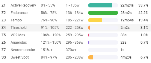

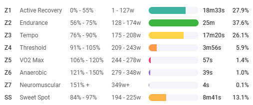

I did a ride the other day where I tried to ignore the numbers and go by feel in zone 2. HR was mostly in Z1, with a bit of zone 2, and zero time at higher zones. Power was mostly Z2, with some 1, 3 and 4. Intervals classified it as a threshold ride using power. Another potential theory is that I’m really bad at steady state power, so my power spikes into Z3+, and my HR doesn’t have time to follow. Then power goes back into Z2, and HR drops back to Z1.
If I update the power and HR to what’s “accurate” based on my most recent test, it’s even wackier:

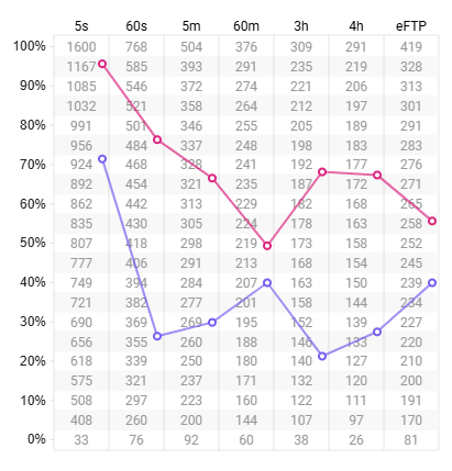

It’s a lot of info to work through at this point but you say Z2 power (75% of FTP) feels too easy but you can’t complete a 5x5 minute VO2 workout at 115-120% FTP? That would be another trial and error approach to find out what your 9/10 RPE Power for a 5x5 minute workout is – and estimate FTP from that 5 minute effort. Best done on zwift I guess.

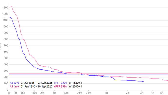

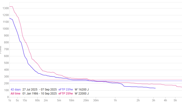

How many hours per week do you ride and how does your full power curve look like? There’s a big gap between 5 min and 60min in the one you posted.

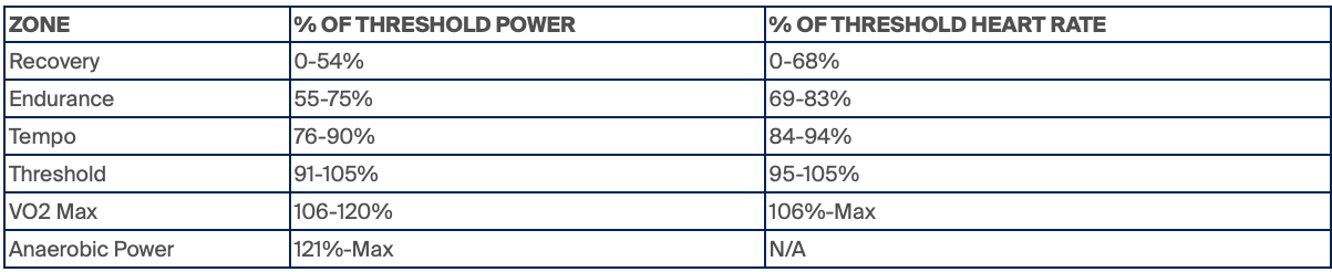

I think the lab test is not needed. Try setting HR Zones to Coggan’s Zones.
Z1/2 boundary: 69% LTHR.
Z2/Tempo boundary: 84%
Threshold: 95-105%
VO2 and above: >106%
Looks like those align much better with your power zones.

Here’s my full power curve for curiosity’s sake:
