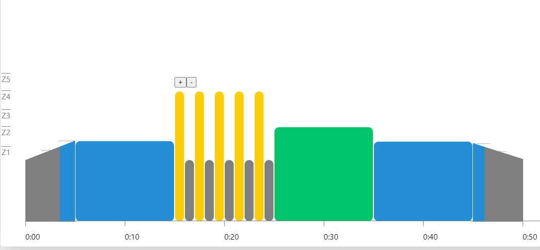

I thought about opening a discussion for us amateurs to share our workout plan, so we can get some positive feedback from the community. I’ll go first. :wink:
My aim for today’s workout is to build base and finish it with some salt and pepper.
Thanks! :wave:t3:
What is the purpose of the 5m Vo2 at the end of the ride?
ah … just something san millan mentioed a few times. i know, i know … :sweat_smile:
I would suggest to first build up to at least 80min of Z2 before adding end-intensity.
Z2 workouts have best effect when duration is at least 70-75 min.
It’s a good idea to add some intensity at the end during base period, simply to preserve top-end power, but it doesn’t have to be 5 min VO2. 4-6 all out short (20sec) sprints is good enough and induces less fatigue then the VO2 interval.
thanks for the feedback, i agree. it’s just that i want to somehow maximize my 60 min workout. with the job and two kids under 6 is somehow hard to do longer workouts as i would absolutely love to do! :smiling_face:
How many days a week do you have to train?
Weekends included.
three times a week, one longer on weekends. i also run.

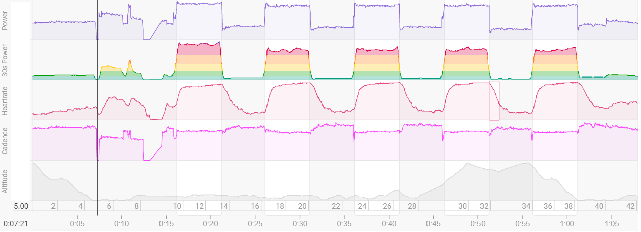

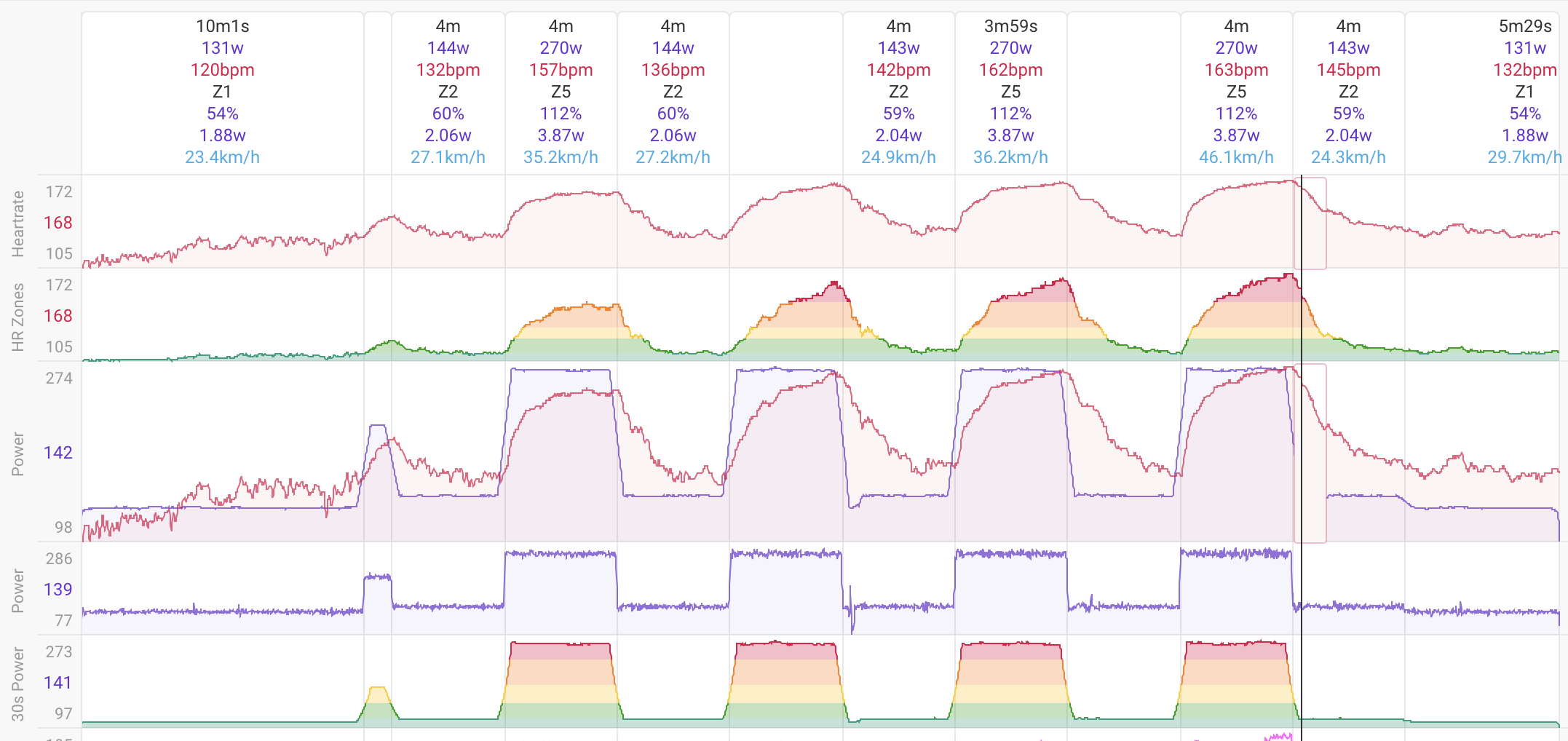

this is an example of a recent vo2 workout.
Yes, that is an example of 4x4 minutes.
You can progress that to 5x4m (20 mins) and 6x4m (24 mins).
Then move to 5m intervals, and 4-6 repeats.
If you need a little more than equal rest intervals, eg. 5-min on 4x4, then take the extra minute.
Once you have a feel for how hard it is, try do it off ERG mode, and go as hard as you can go, rather than cap yourself to a limit (112%).
