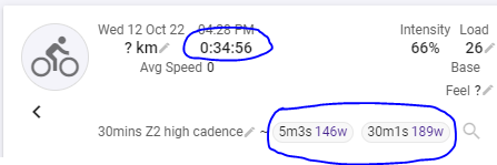

Also see the timings in the screenshot below from a short session last night.
5m3s and 30m1s is 0:35:04 , not 0:34:56 like intervals.icu reports. No pauses / stops in session.
Training Peaks reporting correct elapsed time.
Is this incorrect time reporting a potential root cause of the decoupling inconsistencies? Is Intervals pulling the average power + hr from the correct time intervals?
Timing on intervals is always including zero’s.
Overall timing is excluding zeroes. That’s why you see small differences.

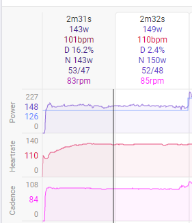

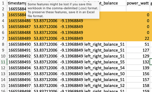

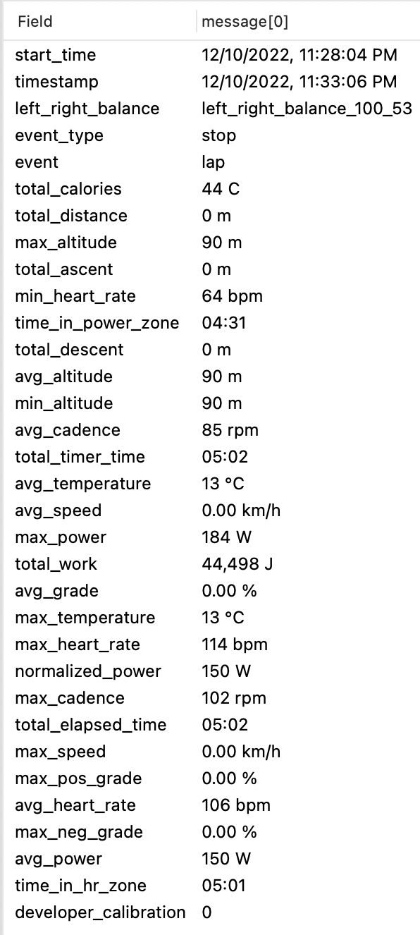

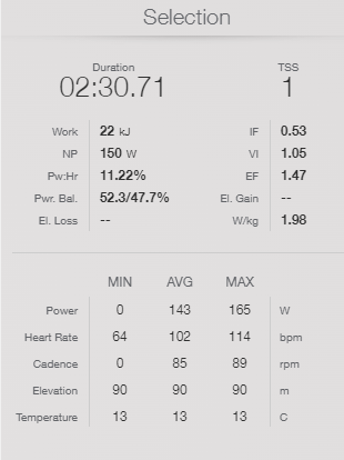

Here is a snap of a 5 minute warm up from last night. I see why there might be a discrepancy in decoupling percentages between intervals.icu and TP
The NP for the first 2:31 is 150 watts on TP. 143 on Intervals.icu.
Why this huge discrepancy for NP for the first 2.5 minutes?

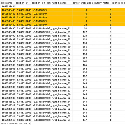

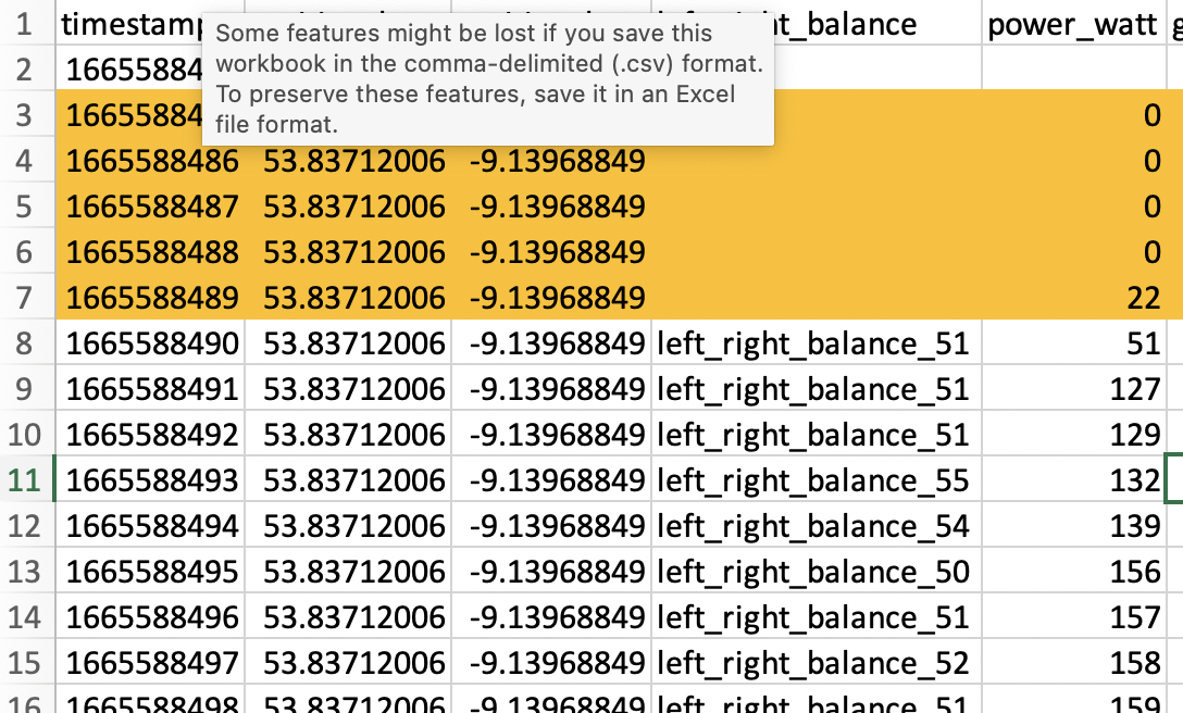

here is the raw fit file also if someone is able to anaylze?
Remove the zero part at the start. Intervals include zero power points.
I believe, these Few values at the beginning has 0 power and is not taken into account by intervals. ~6secs
Could be that TP is just taking the Lap metrics directly from the FIT file and not doing it’s own calculation.

That answers the timing question but why does Intervals.icu reoprt a NP of 143 watts for those first 2.5 minutes v 150 watts from TP.
If I omit the first 30s and analyze from 00:00:30 - 00:04:55, then both sites give an average and NP of 150. But including that 30s at the start, intervals.icu reports the NP as 7 watts lower than TP.
It looks like something to do with the zeros at the start but why? And which data should I believe is correct? This also affects the decoupling percentage because decoupling formula uses NP as opposed to average power

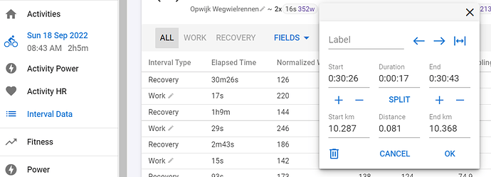

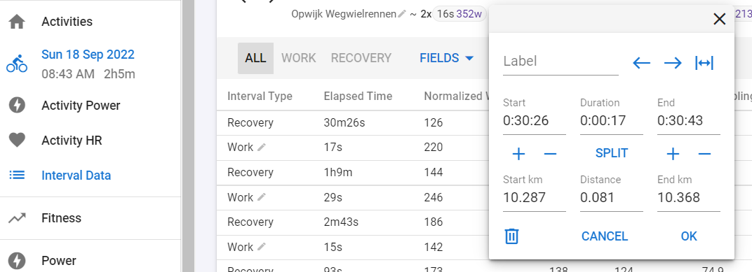

Go to the intervals data page and if that first interval is a ā€œWorkā€ interval, you will see a pencil at the right. Click that and edit out the first 6 sec of the interval. You should now have the same result.

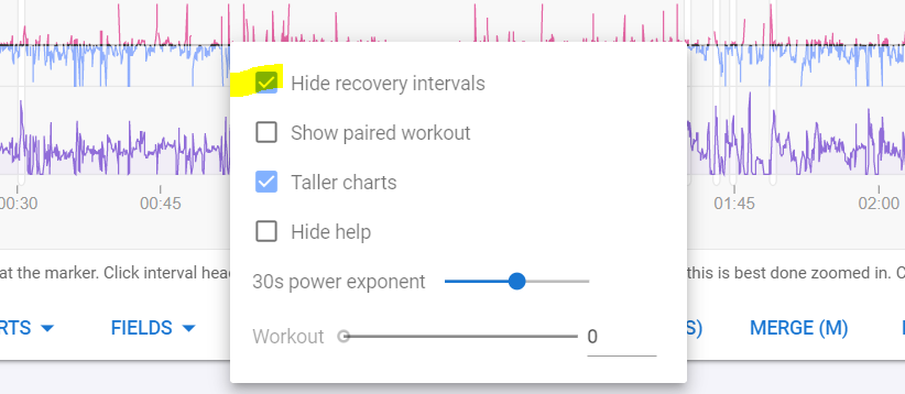

If it is a recovery interval, go to the activity page and click ā€œOptionsā€ at the bottom. Check Hide Recovery intervals. It will now not show as an interval. If you want that interval as a Work interval, place your mouse cursor at the beginning of that part and push the ā€˜a’ key to add a new interval. Drag the borders to select what you want as interval and make sure that the zero power points are not in it.

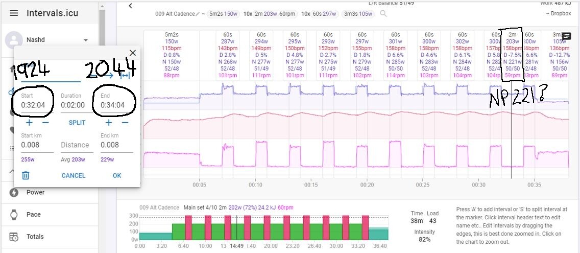

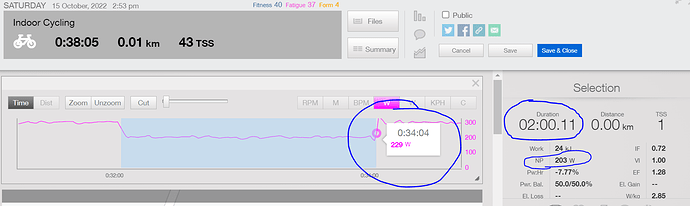

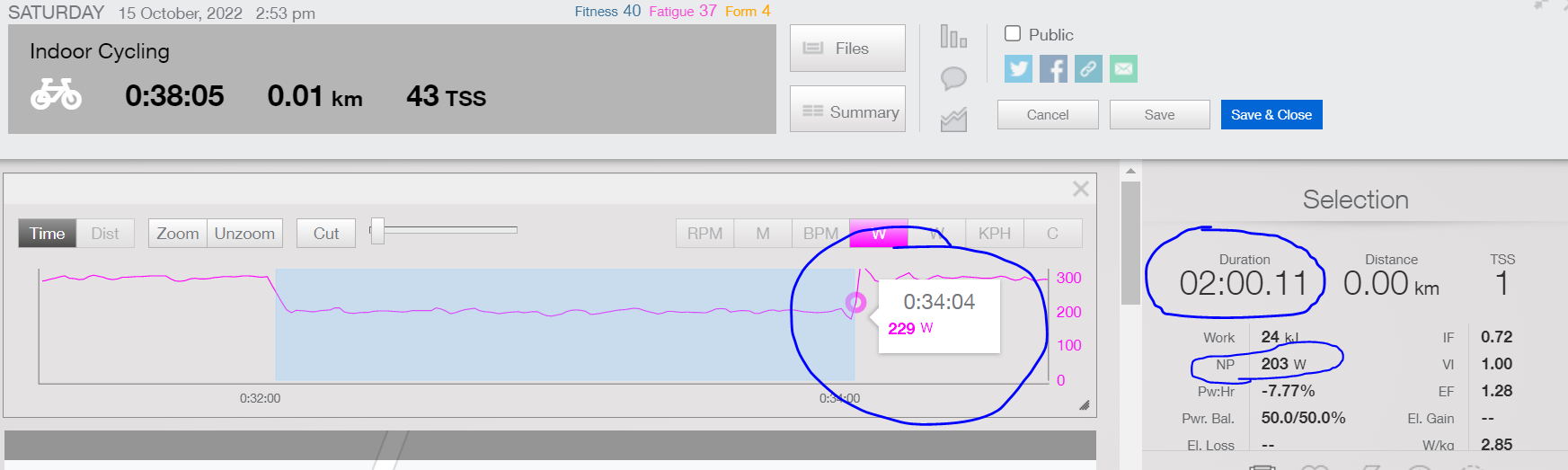

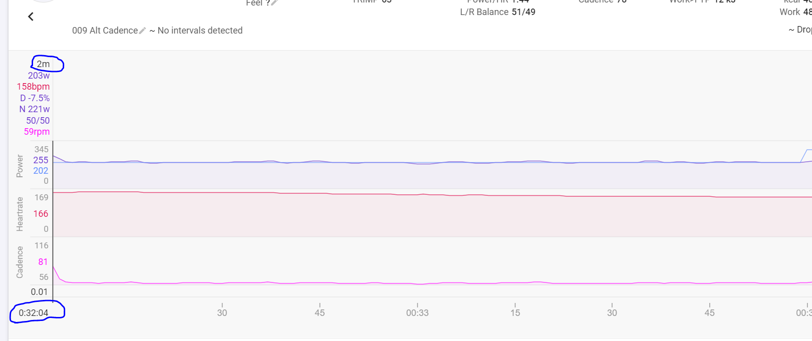

Now look at the last 2 min interval. Intervals.icu is reporting the NP for this interval as 221 watts. I just cannot believe that that is correct. I have attached an excel file showing each second of data for that interval (1924s to 2044s). It just can’t be a NP of 221. TP reports what looks like correct NP of 203 v an average of 202.
Can someone please look into this for me and see why Intervals.icu is reporting NP of 221 for that interval ( I haven’t even looked at other intervals tbh because I just happend to see this first and went investigating from there) (Edit - They’re all pretty much the same - hugely exaggerated NP for those 2 mins intervals)

Whether or which, the NP from that data I’ve posted is incorrect. There is no way that the NP for that highlighted section in the excel sheet is 221 watts. The TP normalized power is correct.

But to my original query from yesterday, if anyone can shed some light as to why the NP for each 2m interval is 221 watts I’d much appreciate it (I know it’s a v short interval and thus NP calculations are probably best ignored, but a difference of 18 watts between here and TP is still significant and I’m just wondering why there is such a difference)
So I’ve done my own calculations for NP from the excel sheet I attached yesterday and I got 203 watts, the same as Training Peaks.
I took the moving 30 second average of the power data from the interval.
Then I took the moving 30 second averaged power data and raised each value to the 4th power.
Then I got the average of that data from step 2 and then got the 4th root of that average to get the NP. 203 watts.

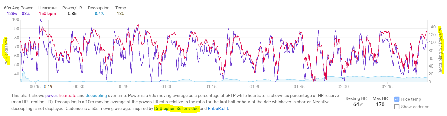

  • Heart Rate Reserve is not used for the calculation, it is only used to plot the data (on the Power page for the whole ride) because plotting %FTP next to %HRReserve makes for a much more linear relationship. Have a look at the video linked under the chart.
  • Would you mind explaining what you do with the Decoupling numbers from such a ride, and per 2m interval? AFAIK decoupling is used to evaluate aerobic fitness and only makes sense for longer semi-stable rides.
  • Can you post a screen shot of that last interval zoomed in with the RAW power data chart? Just a couple seconds extra at the start and end compared to your other screenshot and RAW power as a supplementary chart. The difference in NP must come from somewhere…

When you’re at it, also post a screenshot of the ā€œInterval Dataā€ page. Just to evaluate if it is one single interval that is off are all of the rest intervals.
