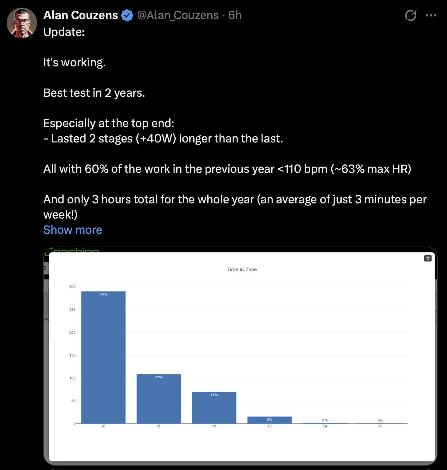

My field tested first ventilatory threshold is around 122-124bpm. Below that is zone1 and zone0 - and if I keep it that low almost no impact on central nervous system.
Above that - say 124-138bpm - is what I use for zone2 (Alan Couzen’s system).
Most of my training is below 124bpm, and I see improvements year over year. I’m using power training for tempo and above. I don’t care if HR and power zones don’t align, what I know is that its easier to recover and be consistent by accumulating time at and below zone1.
Saw this today, Alan Couzens is a sports physiologist and coach. Look at his improvements off nearly 300 hours zone0 and 100 hours zone1. Total for the year is about 500 hours:

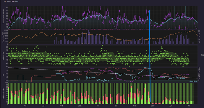

To add more context here are some metrics with hr and power zones being joel friel cycling and the blue line being the “big burnout”:
