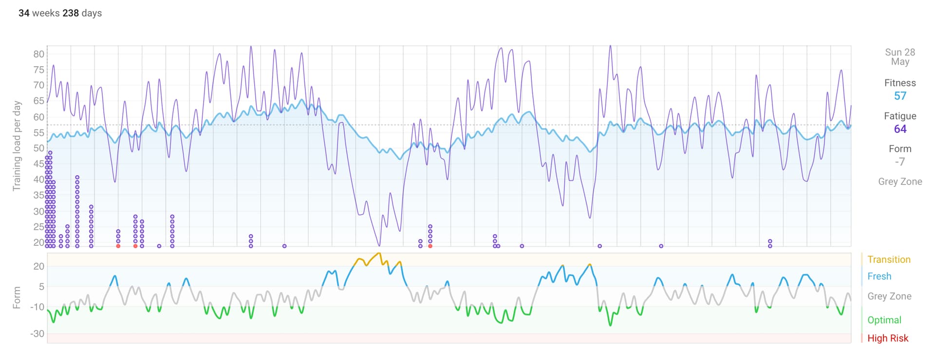

Here is one of my best executed October to May seasons (thank you coach Isaiah). Fitness had dropped substantially after taking off Sept (C-19). Sizable fitness increases (field tests) in January and May:

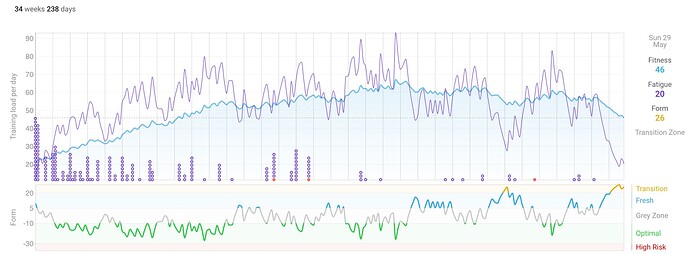

and the following October to May with my all-time best 20-min field test in January:
A lot of grey zone, but what you can’t see was the amount of endurance rides with mixed interval work, hard intervals that by design kept slowly increasing fitness according to a plan, and without the traditional signature of off-season/base/build cycle.
So is it the content and timing and organization of the training rides? Or keeping Form/TSB between -10 and -30?

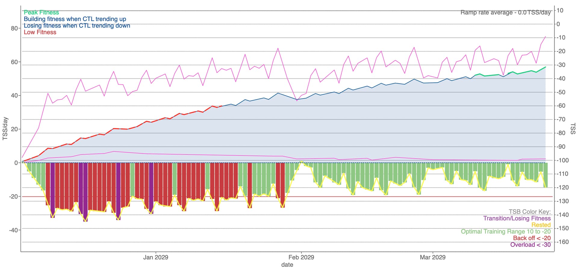

Here is a very well designed 16 week base training program averaging 5 rides / 8 hours per week, starting from 0 CTL:
Six months ago in December I essentially did the first 8 weeks of that plan above, not quite from zero but it was hard. What you don’t see is all the neuromuscular work that really improved results without too much hard work.
Training is more than Form/TSB…
in fact Form/TSB was designed to be a signal that you’ve recovered enough to absorb and adapt from the hard work. After 3 hard weeks you take off 3 or 4 days for Form/TSB to come back a bit positive (everybody is different), as thats a signal that your body had enough rest to adapt to the hard training of the previous 3 weeks. That is a good rule if you took an off-season and restarting with base training, but as you saw from my 2nd chart above it’s not a rule to use indiscriminately. Numbers support feelings.

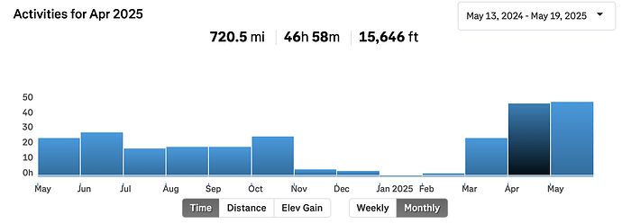

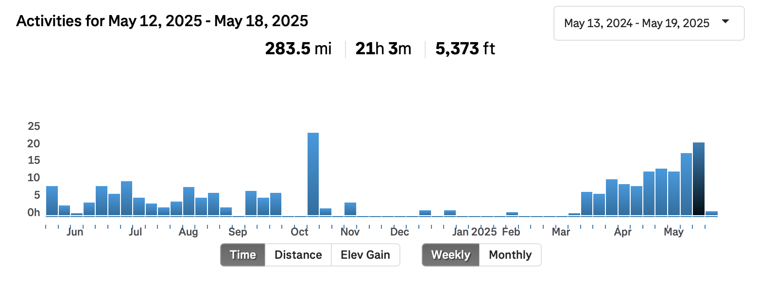

To my eyes, the rapid increases in time/volume looks like a plan to maximize the odds of achieving burnout and overreaching without a lot of fitness gains.
It’s even more hours than my late 20s friend that is a Cat1 and racing in some of the biggest US races.
Do you have a plan? Why the large volume (hours) increases?
