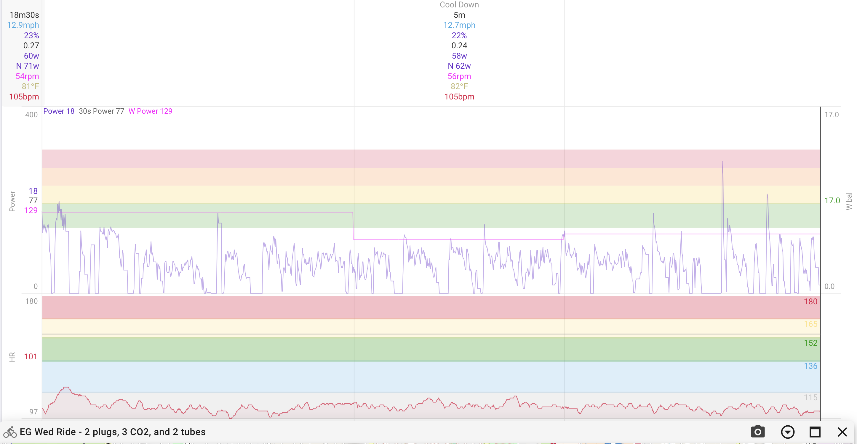

FWIW @JASON_C_WILLIAMS I’m similar height but built like a weight lifter / truck at 200lb. Here is a Wed group ride from a year ago that didn’t end well as its titled “EG Wed Ride - 2 plugs, 3 CO2, 2 tubes” :rofl: Relative to my 260W ftp at the time, doing 50-80W is “going for a easy walk” pace in terms of breathing, heart rate, and I can have a full on conversation as if I were on a walk and talk.
18 minutes slow rolling home in lower 80 degree temps at a 60W average, 71W normalized, and ~13mph WITH 10mph TAILWIND.
At those low speeds somebody more aero would go slightly faster.

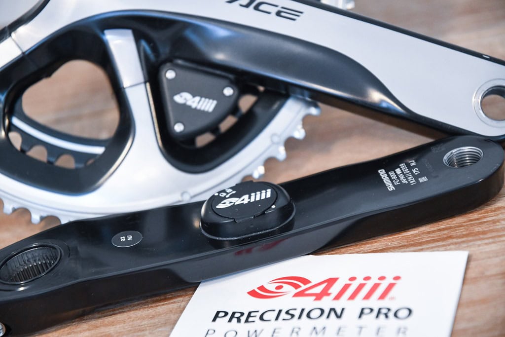

so almost as if my power meter were listening to this conversation, my numbers jumped up wildly over the last 2 days.
What was 50W is now all of a sudden 90W - problem is now the numbers seem way too high and it’s really hard to know how much effort I’m actually putting in - I’ve had to ignore the power meter and go on heart rate which is a lot harder.
I guess I can take my old bike and my new bike and swap left cranks to get my old power meter on my new bike.
Ugh - what a pain this is.
BTW this is a brand new from the manufacturer 4iiii Power Precision Pro that I paid full retail for - not super happy.

I don’t want to repeat myself. But it doesn’t matter: if you don’t calibrate it, your numbers are just garbage. You’d then better go with HR.
A simple calibration step takes seconds but ensures your data is reliable. It will eliminate installation variability, do a temperature compensation, and a zero offset correction.

If it was me, step 1 would be picking up the phone and calling 4iiii support for assistance and possible RMA.

Calling 4iiii support is a great suggestion @WindWarrior! But @JASON_C_WILLIAMS if you can relatively easily get the old power meter on the new bike, that could help give 4iii more info. Hell, just ride the old bike for awhile as you figure this out.
