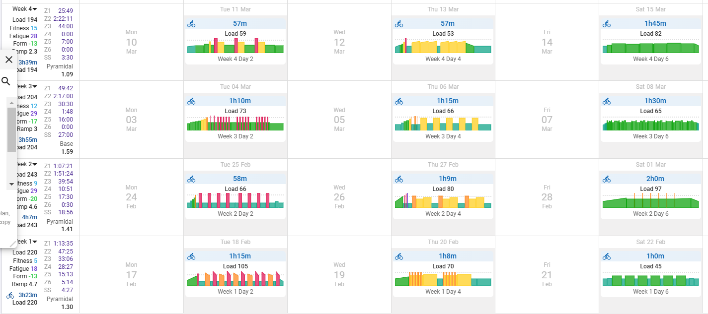

I’m running into one issue though: when I give just zone and time as inputs, it has a really hard time to generate workouts for that.
This
is the output for
As you can see on Saturday I give only Z2 and 2.5h. Should be a simple workout, but the durations it comes up with are all over the place.
It’s much more stable when I give a [training load and no duration target] or [zone, load and duration]
Any idea what might be causing this?

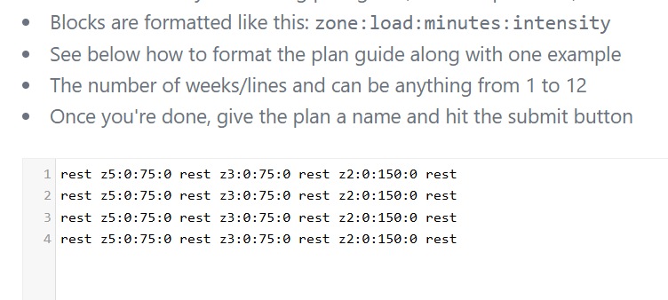

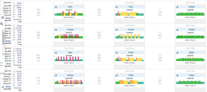

Using the same input you supplied:
rest z5:0:75:0 rest z3:0:75:0 rest z2:0:150:0 rest
This is what I’ve got:
Please, LMK how it goes.

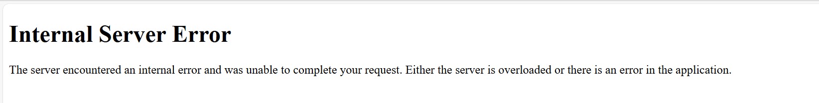

Facing an issue trying to connect :frowning: :
" Internal Server Error. The server encountered an internal error and was unable to complete your request. Either the server is overloaded or there is an error in the application."
Anyone else?

Hey, @_Arthur! Glad to know you’re using the tool!
It appears that there has been an issue with the authentication process where the Intervals.icu API was resetting the authorization scope and that was triggering an error. It seems to have been resolved. Maybe @david could kindly confirm.

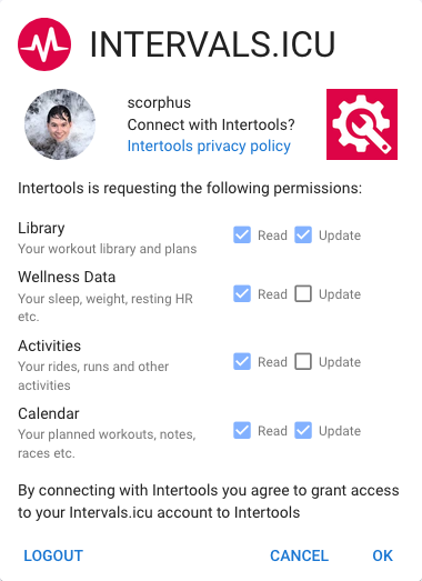

Oh, I see the same error again. I could reproduce it and will fix it soon.
In the meantime, can you please confirm you’re not selecting any additional permissions:
IOW, please leave the check boxes as they are and click OK.
My bad! I am so confused. I checked everything.. Now it works :slight_smile:
Sorry for the disturbance!
Arthur
Awesome! I’m gonna implement a fix to overcome that (although not using any of the extra permissions ofc). Thanks for letting me know!
That issue is now fixed and authentication works when everything is checked :smiley:

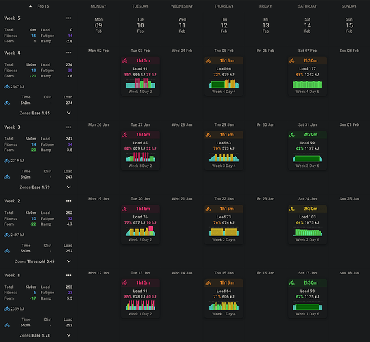

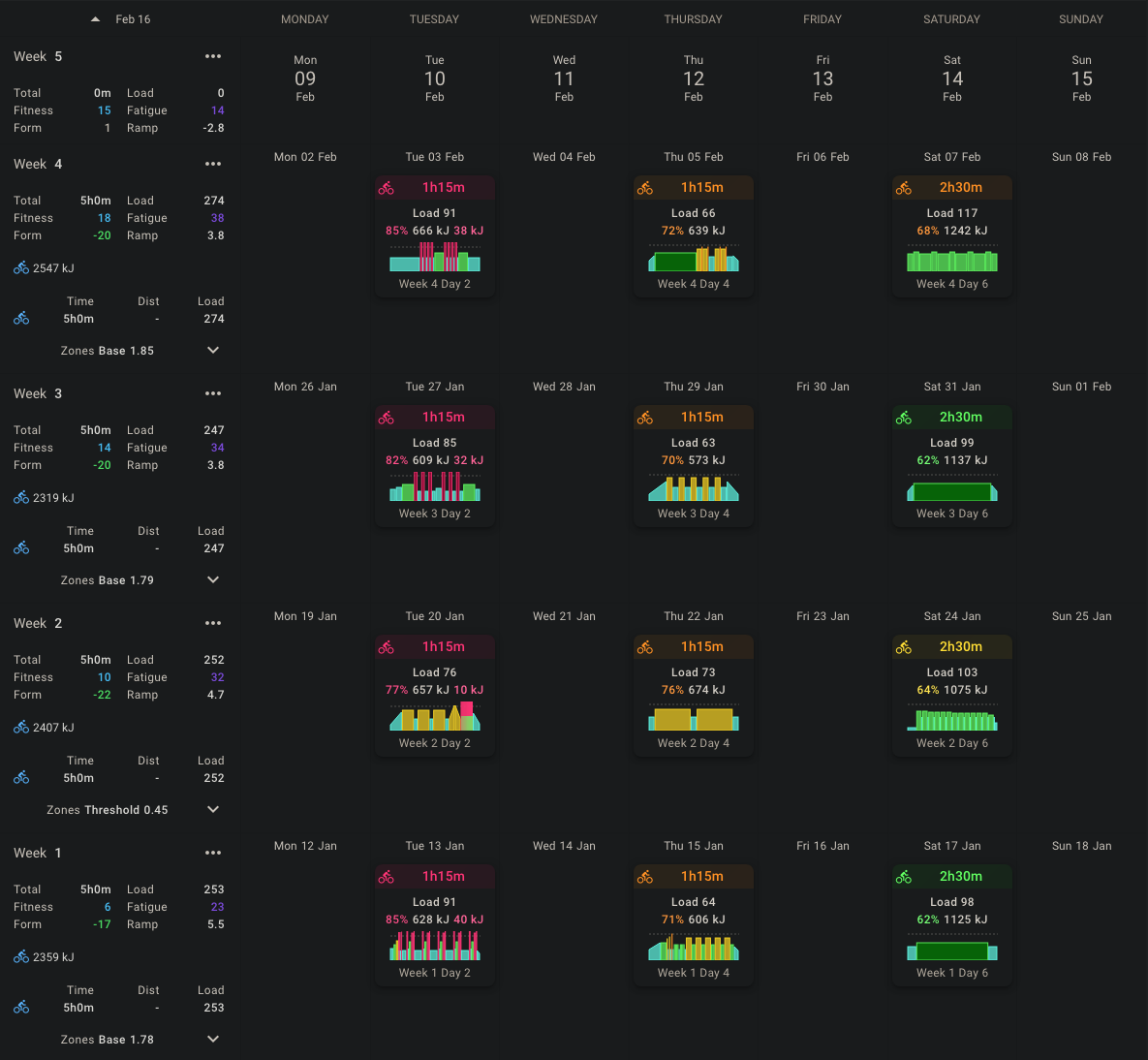

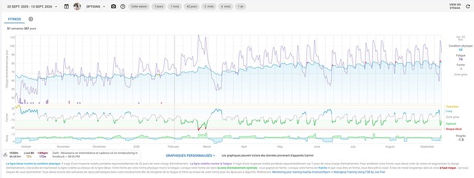

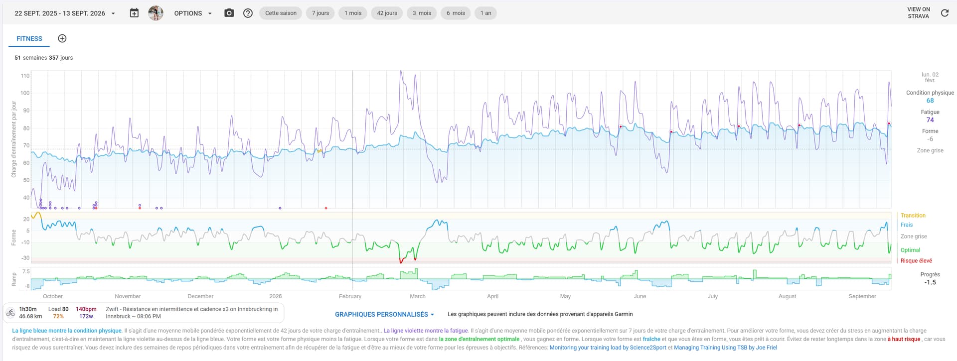

Full year planned (high level ATP vision) :slight_smile:
ready to kick all my 4 Gran Fondo this year!!
Awesome job thanks @scorphus
That’s simply mega! Makes me very happy! Thank you for sharing!
