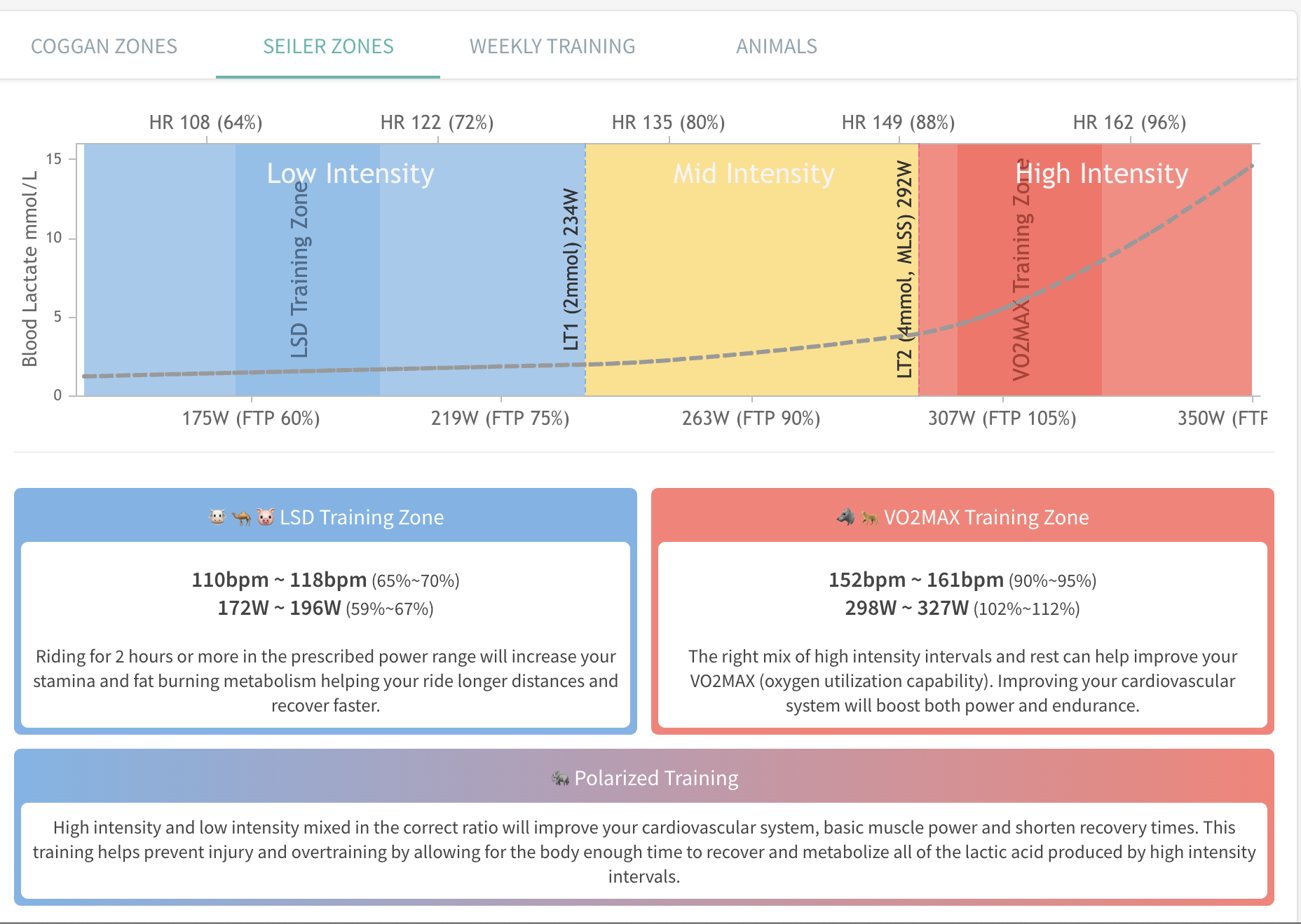

I recently did a lactate test and got my LT1 and LT2 (among a few other values and zone recommendations.)
I know I could change my cycling power zones (and did already), but im not sure, what to set as my FTP? As far as I know, TSS is based on FTP.
Should I set my LT2 as FTP? Should I do a 20min FTP Test to get my FTP? (Which seems weird to do, as I have a more accurate lactate test…) If I set LT2 as my FTP is my TSS wrongly calculated?
Thx in advance, Jan

My problem is: I’m pretty sure I can maintain 300+ Watts for about 20 min (after the 5min all out) which would result in 285W FTP. My current LT2/MLSS was measured at 267W (and its reasonable, because it’s not my first test)
So: 18W between those two - Is it close enough for a reasonable TSS?

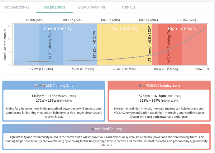

this coming from another app which I use, called riduck (from Korea).

I was tested with a INSCYD protocol, not a ramp test. But nevertheless 5-10W is accurate enough for me.
But:
On friday my brother did also a lactate test. He also did a 20min FTP test (including a 5min all out) a few weeks ago. He could manage 290W for the 20min, so FTP is somewhere between 261W (90%) or 275W (95%).
His MLSS was measured at 235W, which is quiet low according to the 20min test values, BUT he has a very high vLamax of 0.62 mmol/l/s (VO2max is 53,12 ml/min/kg). That’s why he could held high power for a shorter period of time I assume.
I know from expirience, if it goes any longer he would drastically explode. If he went on longer climbs he intuitivly falls back to around 240W so I would say the lactate test seems correct.
So my initial questions remains, not for me, but for my brother: What should he set his FTP at in intervals.icu to get correct TSS Values?
