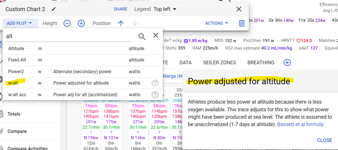

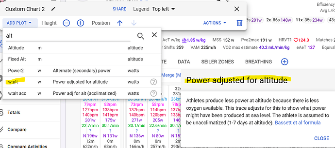

If I train by power, I cannot hold a conversation at all at z2. So I go by my ability to talk. But over z2, how can I figure out what zone I am actually riding in at all these different elevations?
There is some support for altitude corrected Power and zone in Intervals
But I can’t give you any details, because I don’t train at altitude…
There are more threads here on the forum which may give you more info
