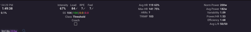

Oh my experiment actually doesnt show gains vs carb fueled riding. In fact my cardiac efficiency is way down!
The same HR was producing 200w avg vs currently abotu 165w without carbs.
My current experiment shows the rate of adaptation to keto.A

I’ll be tracking watts per kg per bpm in a specific 600kj slice of my ride for the next 60 days.
Each ride will be done in a keto state. Some days workout 6 hours perfore. The first ride for reference was not done in Keto state. So the w/bpm closer to baseline.
Date Ride kJ Weight kg Slice minutes Slice W Slice HR W/kg W/kg delta vs Sep 21 W/kg/bpm W/kg/bpm delta vs Sep 21
