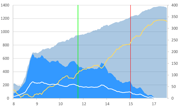

The topic of FatMax and carb-restricted training is very popular and interesting. For many years I believed that improving fat metabolism was possible only with restricted carb availability. Training without breakfast, without extra fueling.
But when I dug deeper into this topic, I realized — fasted training doesn’t improve fat metabolism, but it creates a lot of stress that’s very hard to dose, and fasted training can very easily even worsen your results.
FatMax assessment is quite reliable, possible on a metabolic cart test. Where you can see that carbs start being used from the very first minute of the workout, but at some point fat usage starts to decline — that’s the FatMax point: the maximum intensity at which high fat utilization is still maintained and the fat/carb ratio is 50/50.
Here’s an example of a treadmill test.
The yellow line is carbs in grams per hour.
The white line is fat in grams per hour.
The fills are calories from the substrate.
At about 9.5 km/h (or 6:19 pace), my fat burn is 60 grams per hour, and carbs 15 g.
At about 10.5 km/h, or 5:43 pace, fat burn is 54 grams per hour, carb burn 48 grams per hour.
Whereas already at 11 km/h, or 5:27 pace, the ratio becomes 51/60.
So I train fat metabolism at intensity no higher than 5:43, and ideally maintain a pace of 6:00–6:19 min per km.
However, if I run 3 hours at 5:27 pace, that burns ~150-180 grams of glycogen and creates excessive stress. There’s nothing wrong with consuming about 40–50 grams of carbs, sparing your glycogen, while fat utilization doesn’t change — meaning the fat metabolism training is preserved.
Second example: when I rode the bike without fueling, holding stable intensity (via ventilation control), I could observe that my power after about 2 hours (when, by mathematical calculation, I’d burned about 120 grams of carbs) started dropping sharply, by almost 50%. After taking carbs, about 40 minutes later my power came back, but not to the original level — only to about 80% of what it was at the start.
