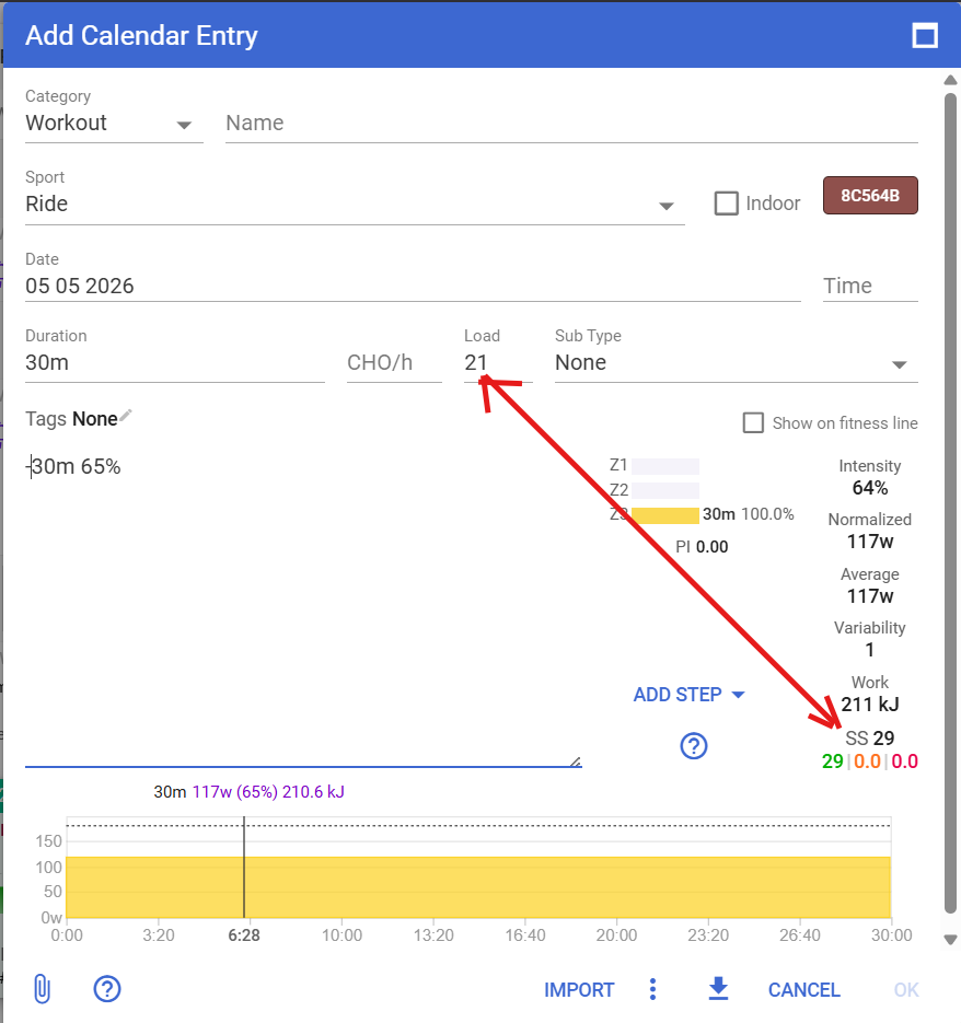

Playing with workout creator I see that 2 hours at 56% of FTP results in the same strain score as 1 hour at 100% of FTP.
This can’t be right either as training stimulus nor training stress measure. The former is a leisurely easy ride comparable to walking your dog in a park while the other is a very hard training session (even if split into intervals). Is there a bug somewhere? If not how comes Intervals.icu now defaults to this metric?

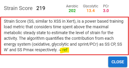

Have you read the support forum post with links to external documents?
Clicking on the word “ref” opens this link…
and includes a link to the paper in the first post…
Some users with experience have reported that it’s “quite accurate”.
It popped out as default for me when I opened a workout creator. I wasn’t doing it for a while so I was surprised to see it.

Yup, I have created one of them and I am using my custom metric. Unfortunately I can’t use my custom metric in the workout creator (last time I checked). I opened a workout creator and SS popped out as default metric so I was curious how it works and noticed it produces nonsense.
That’s why I am asking if there is a bug in it. It says that it considers time spent above FTP and takes into account contribution from various systems so it shouldn’t produce results like 2 hours of riding at recovery pace being equal to 1 hour of riding at FTP.

I don’t know it well enough to give able to explain the system. It does rely on three maximal efforts, considered short (5-15 secs), medium (3-5 mins) and long (10-12 mins). It’s a model-based estimation, so ensuring your efforts are maximal efforts ensures the model is “more” accurate.
So it’s not only efforts above FTP.
