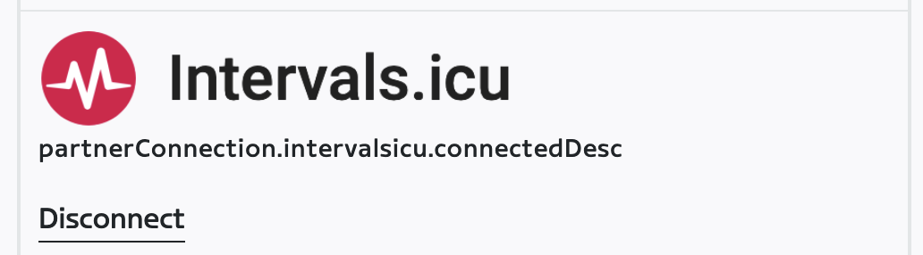

Here’s a small cosmetic bug. On the Zwift connections page there is what looks like placeholder text in the description for the Intervals.icu connection.

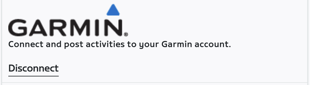

For comparison, here’s the Garmin Connect description:

Zwift have fixed this, Tx:
