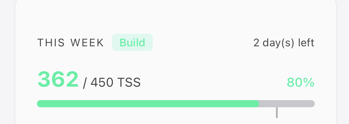

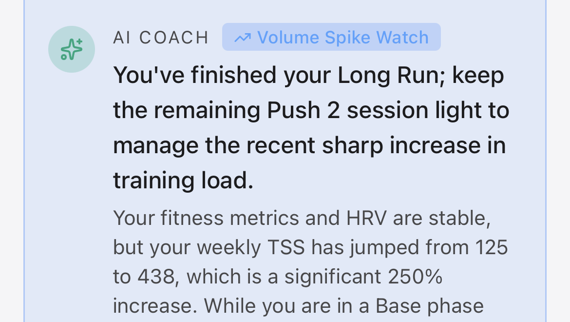

The dasboard metrics are looking odd to me today.
Last weeks load was 340, not 125.
So far this week I have a load of 360, which it even tells me 2 lines down below
so both numbers are looking off to me.

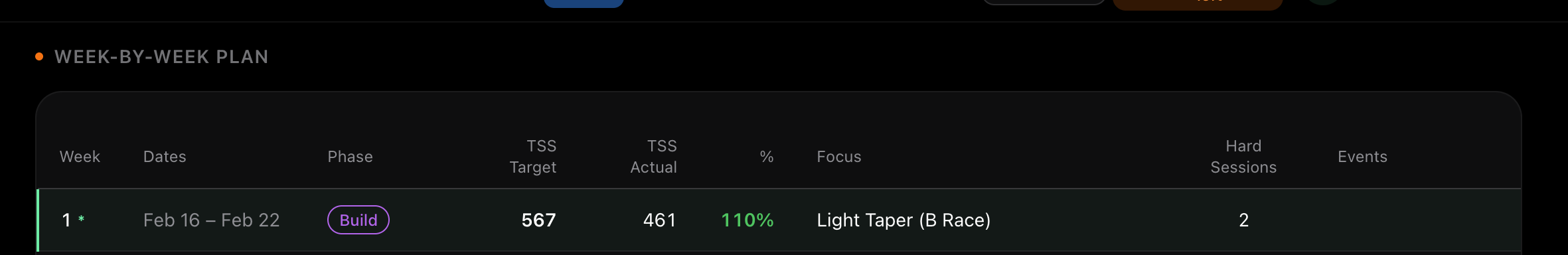

little bug here. did 461 / 567 so not sure How it can be 110% :laughing:

Good catch - you’re right, those numbers are off. The AI Coach card is calculating weekly TSS using a different method than the dashboard, which is why they don’t match. The “This Week” card (362 TSS) is correct; the coaching note is using a rolling window that doesn’t align with the actual Monday-Sunday week boundaries.
I’ve got a fix lined up for this. Should be sorted soon.
Thanks for flagging it!
Good spot - you’re right, that math is off. It’s a bug where the completion percentage is being calculated against an older target value before it gets updated to the correct one. So the 110% is based on a lower internal target (~419), not the displayed 567.
Quick fix, I’ll have it sorted shortly.

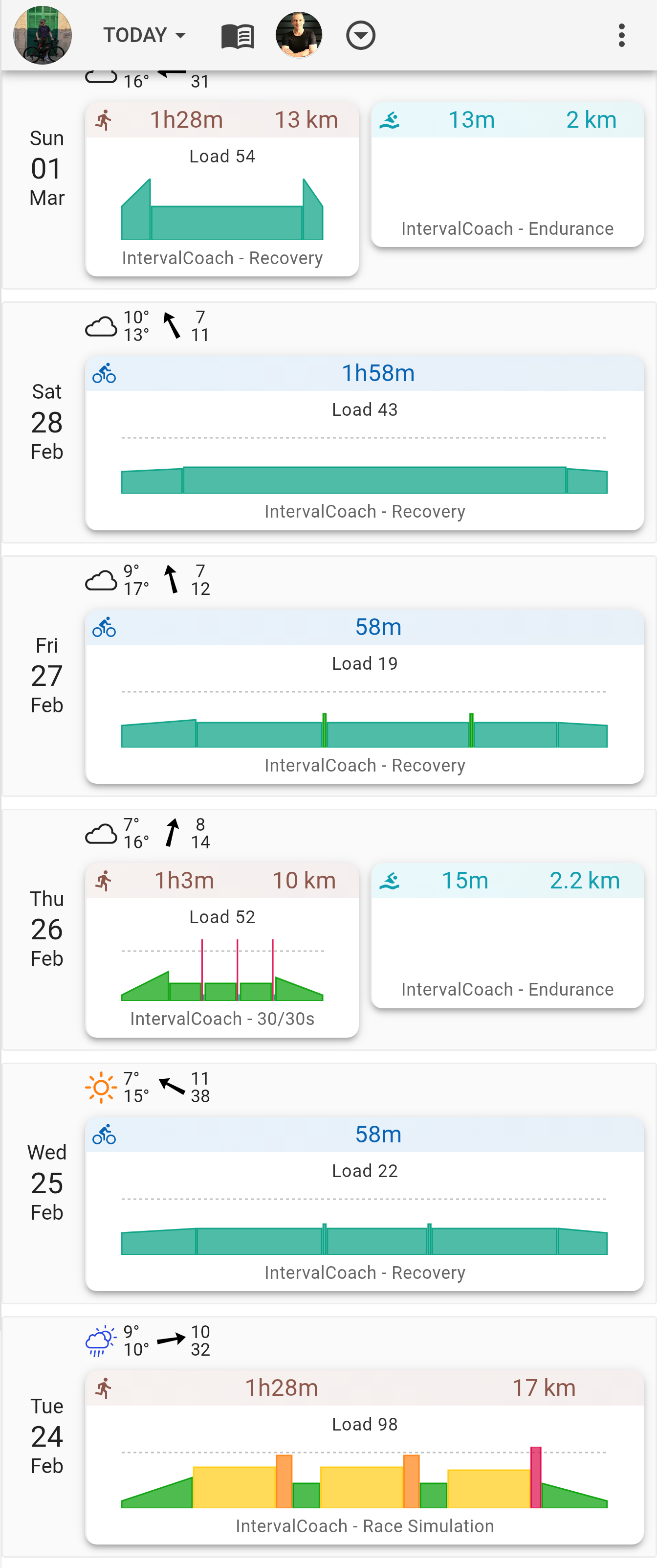

Hi Martijn,
  1. This morning coach scheduled the next week for me, even though my preference says Sundays at 5 PM
  2. The coming week is a recovery week. Recovery volume is set to 65%.
    AI says it should drop to 97 TSS (seems very low).
    Calender shows 237 on the left hand side(seems reasonable).
    But when I add up all scheduled workouts for the week it comes to 544 ( completely unrealistic)
I need to check what triggered it at 3 AM instead of your preferred time. The weekly cron is supposed to respect your Sunday timing setting, but something else may have kicked off the generation early. I’ll look into this.
The weekly target is correct (around 130-237 TSS at 65% recovery volume), but the individual workouts don’t properly account for this when you have very long weekend sessions. Your Saturday and Sunday availability (8h and 6h) gets reduced to roughly 5.5h and 4h during recovery weeks, but even easy Z2 rides at those durations still produce way more TSS than the target allows. The result is the 544 TSS total you calculated, which is clearly not a recovery week.
I need to add smarter duration capping for recovery weeks, especially for long sessions. Something like capping individual workouts at 2-3 hours max during recovery, rather than just applying a flat 70% reduction.

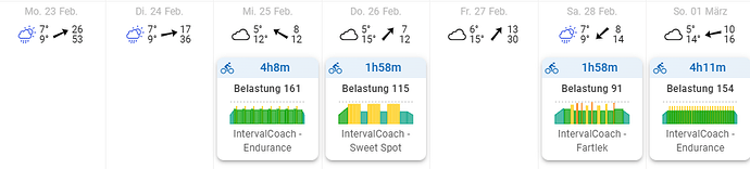

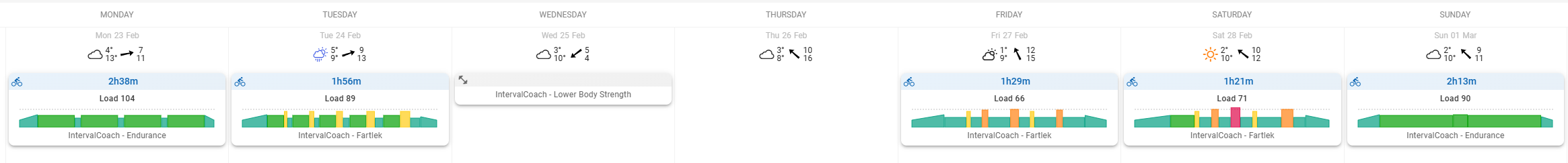

Hi it is me again with the workout duration thing :upside_down_face:
My cycling workouts are all set to 2h. This week’s plan:
I am curius what % deviation is allowed in the current setup? Saturday’s 1h21m session is a 32% time reduction from the set 2h. It also doesn’t seem to be in-line with the load, e.g. monday’s session has a higher load and is 38m longer than planned, whereas the saturday’s session does go into the higher zones but the load is still lower. Maybe I just don’t understand how the system balances duration, load and zones?

Looking at your week, the duration deviations are bigger than they should be. Monday came in at 2h38m (way over your 2h) while Saturday and Sunday were 1h21m (way under). That’s not right on either end.
The short sessions are caused by a recent fix I made to prevent impossibly long workouts on recovery weeks. It’s working too aggressively on normal weeks though, cutting endurance days shorter than it should. And the long Monday slipped past the duration check because the two duration estimators (mine and Intervals.icu’s) disagree on the actual length.

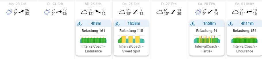

Honestly, I am somewhat loosing confidence in AI’s capabilitiesfor planning:
I’ve created a dummy event 12 weeks out from now to plan/train for: a 7hrs Gran Fondo.
I’ve given workout time for each day except Friday, totalling up to 13hrs/wk.
For the upcoming week, the “week by week plan” calls for 645 TSS as a target, whereas the scheduled workouts total up to “only” 521 TSS.
Screenshot 2026-02-22 213517
Those 521 TSS are distributed a bit odd, with 3 rest days on Mon, Tue, and Fri, while -in addition to the long ride on the weekend- scheduling a 4hrs8min workout on Wednesday, a day where I allocated 90mins availability.
The much I like the design, functions (train now), and analytic advises, the much I have to question the generated plans.

I see the target TSS for this week has changed over night, to 537 TSS (“aerobic” instead of “threshold”), so the scheduled 521 TSS come very close… However, the odd distribution with 3 rest days and the 4hrs8min workout on Wednesday remain.

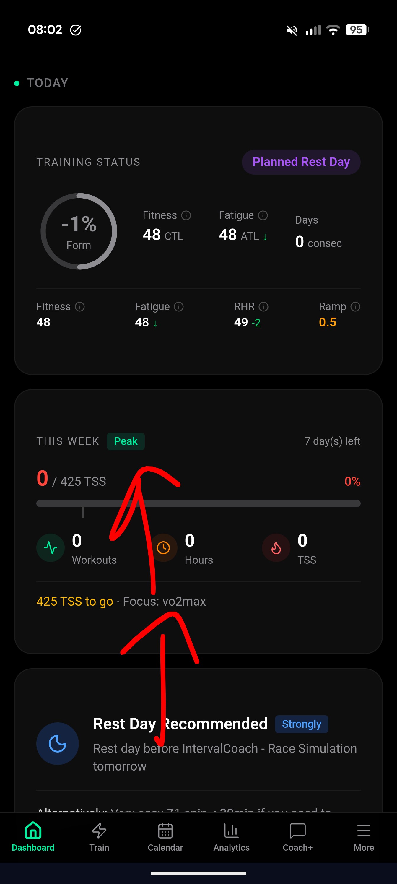

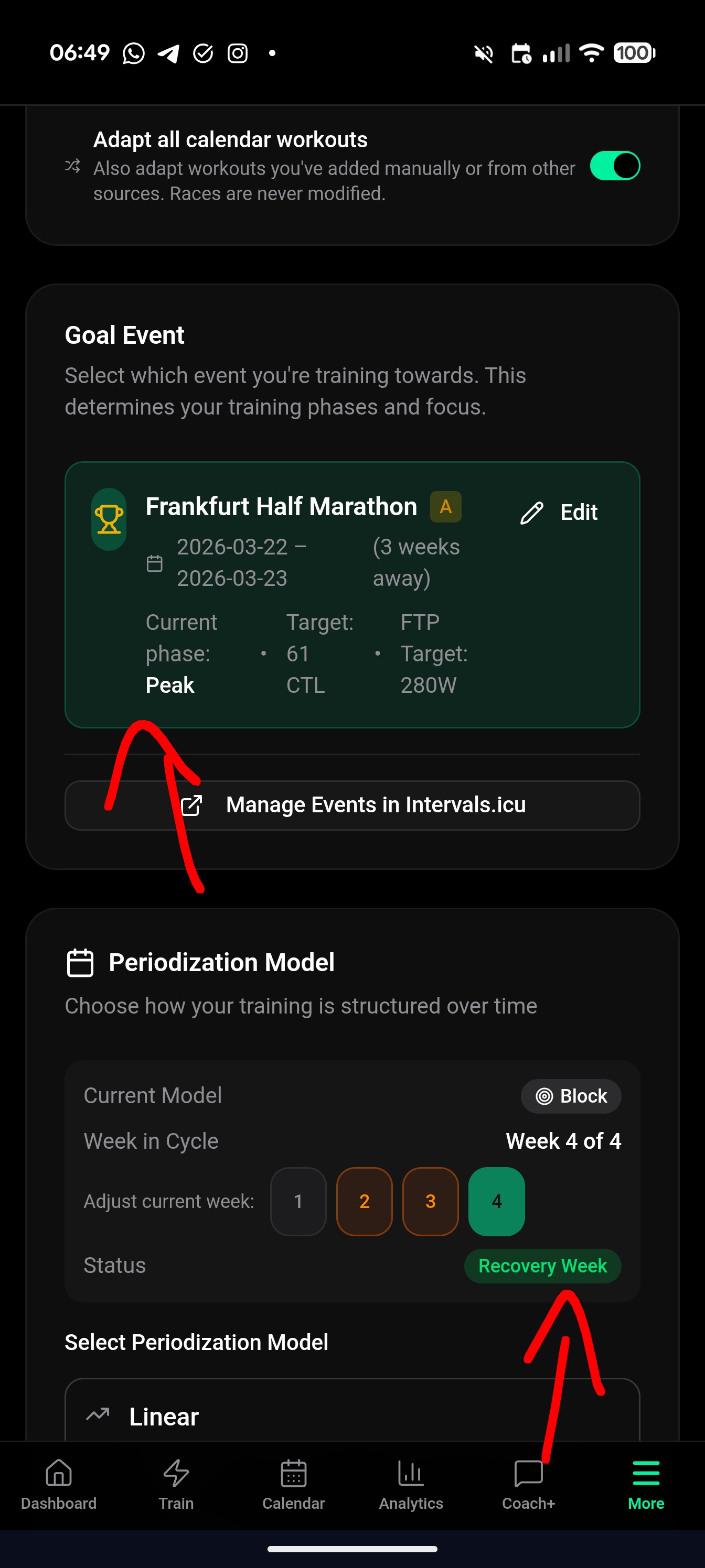

Good morning Martjin,
Unfortunately there are still a few inconsistencies:
Sometimes it says I am in peak week, sometime in recovery week. Overall, the sessions for the week are kind of in-between?
Best regards,
Marc
It’s a recovery week within the peak phase. Based on the 3:1 periodization model. I’ll see if we can make that more clear within the UI. Part of this model is that it reduces the overall intensity, but won’t cut all work because it’s not a full recovery phase.
