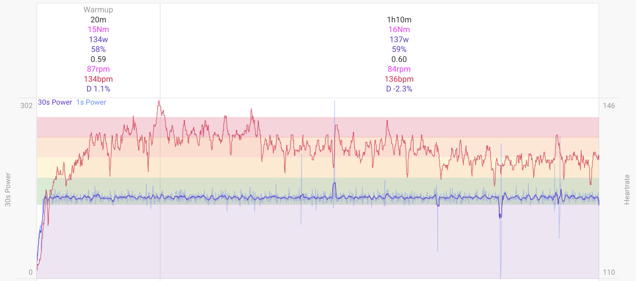

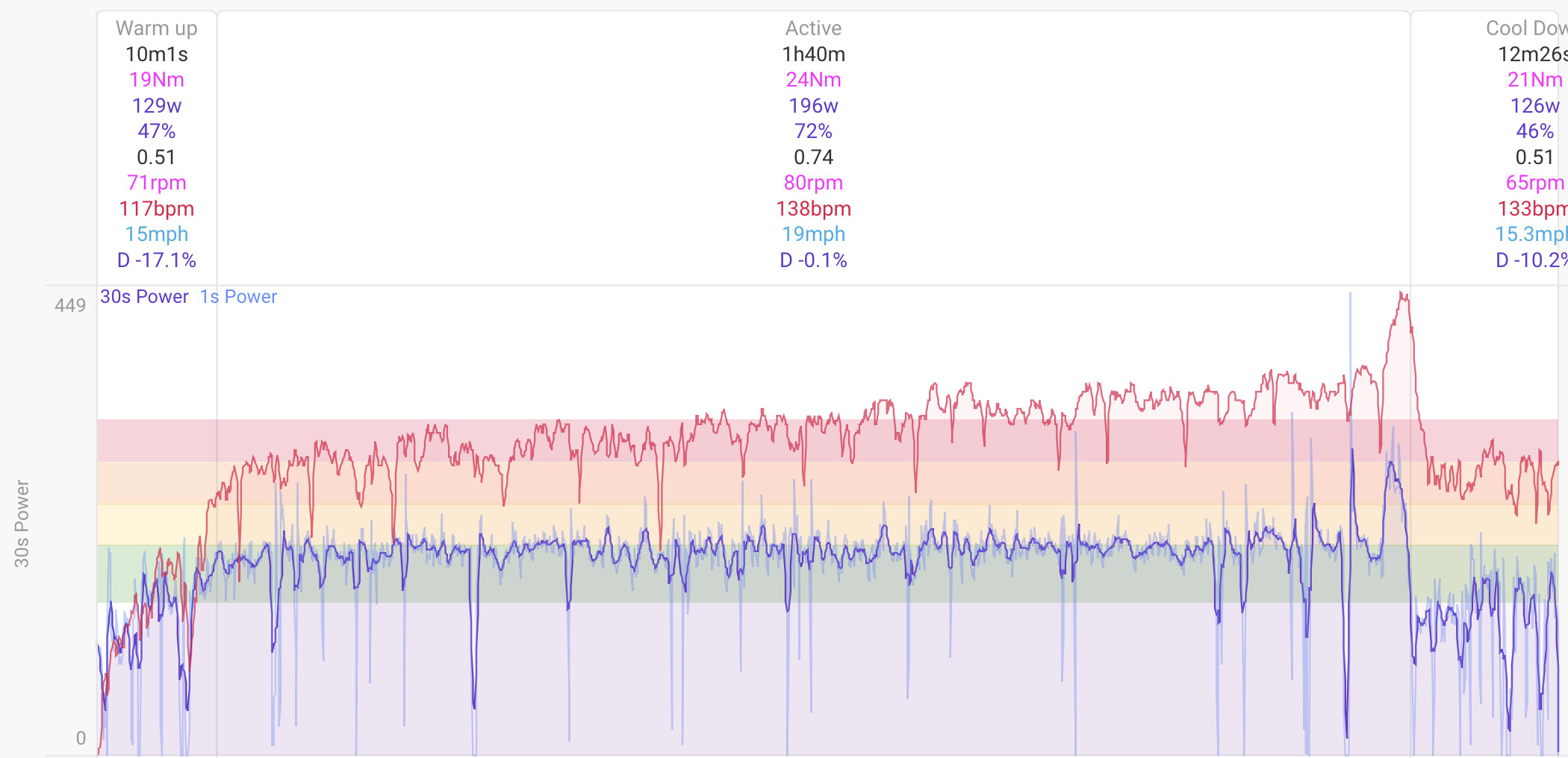

Go to the details of your workout and then go to the power screen. There is a Decoupling graph at the bottom. Sliders will adjust the starting and ending times to allow for warmup and cooldown.
It’s fun to play around with. Trial and error will pinpoint a power and heart rate that gives the lowest Decoupling value. Repeating long workouts with the purpose of generating this data will give useful comparisons. To the right of the chart is also calculated power to heart rate data for Efficiency which goes hand in hand with Decoupling.

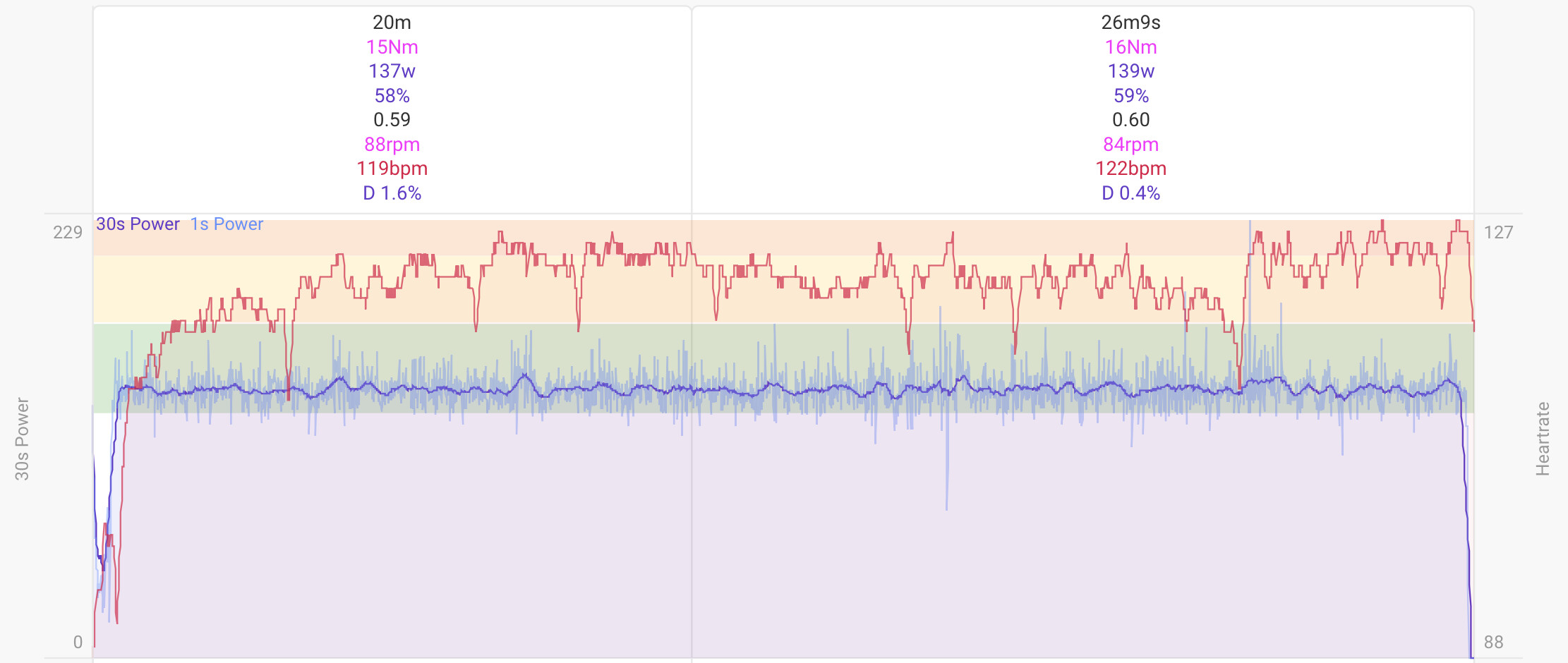

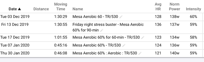

I dunno. Perhaps a better way to look at it is to do something like 60% FTP endurance in erg and seeing how HR changes over time:
see how average HR decreases over ~2 months? Easier to see if you can ride steady in Zwift, or use Erg. Here is the first workout:
you can visually see that HR (red) is pretty much flat while riding at 60% FTP in erg.
The next one, 10 days later, is called Friday night stress buster:
absolute HR spikes early - probably stress related - and then you can clearly see it dropping (going back to your question).
Last one:
pretty flat HR.

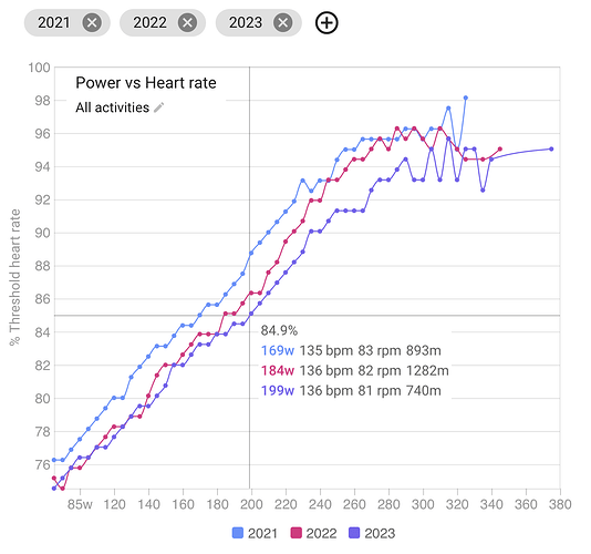

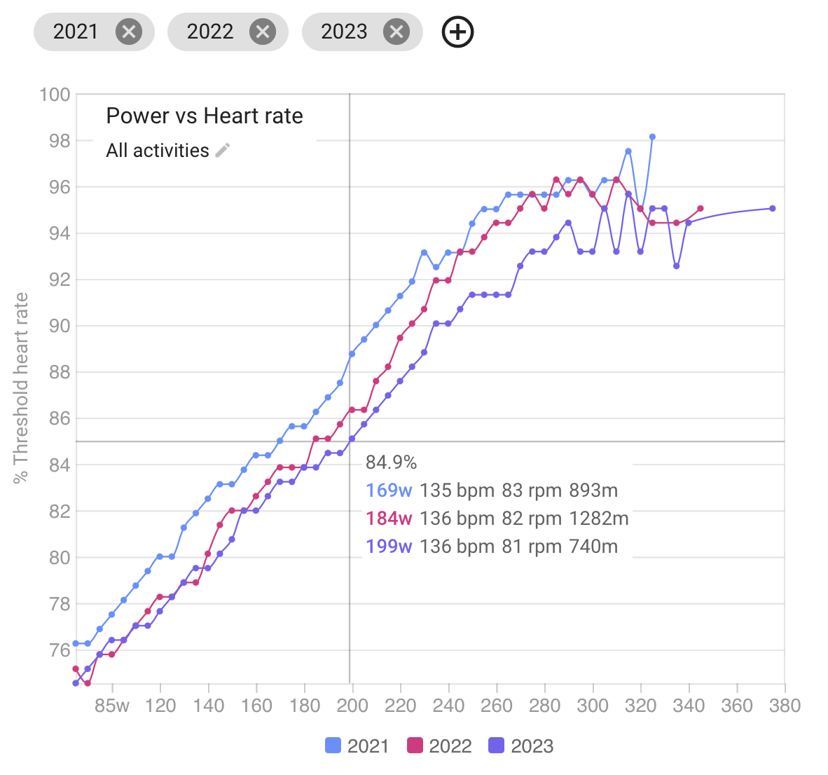

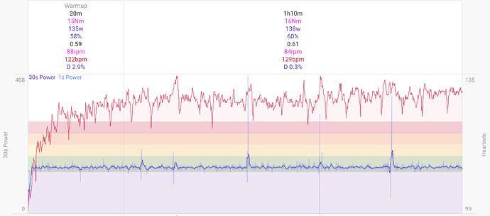

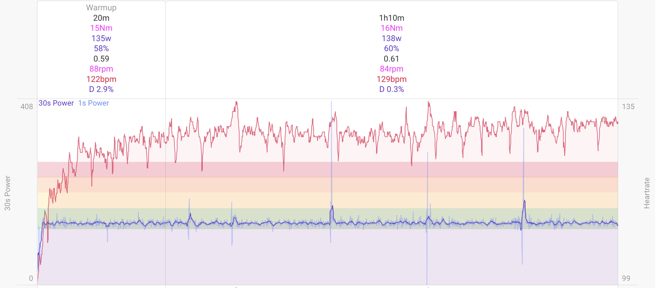

But like I said, its better to look over time. A great chart to do that, if you are riding enough endurance is this one under compare:
136bpm is about where my breathing changes, so its self-estimated AeT (lower aerobic threshold). See how power increases between 2021 to 2023? Around AeT - 136bpm - my power went from 170W to 185W to 200W.
I did that by training to power. The (99% outdoor) workouts had a lot of endurance rides that looked like this:
started in 2021 by riding mostly the middle of zone2, by 2023 I was riding mostly at top of zone2.
My advice is to not overthink it. What I did may not work as well for you. You need to find what works for you. For context, I was averaging 7-8 hours/week and for interval work my coach had me doing fewer intervals at highest quality (and generally at higher power). Don’t let your endurance rides detract from your interval rides.

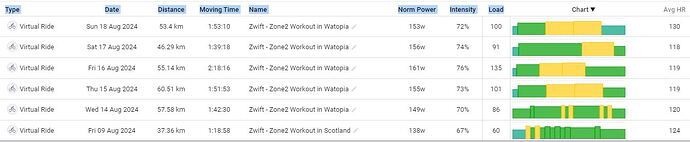

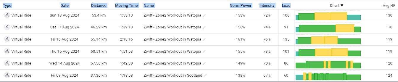

Odd, my avg HR was up almost 12 bpm for almost samt z2 workout
Are you used to doing 5 days back to back?
That’s 9.5hr in 5 days. If your body is not adapted to this kind of load, it is signalling you that you’re overdoing it.
If this is sort of your normal routine, something else is going on. More coffee then usual, Overheating, Sickness onset, Bad night, Alcohol, Stress…
Do you have morning HRV measurement?
The first and the last one I did on my race bike with wahoo kickr v5, with 165mm cranks and wahoo kickr headwind as fan.
The 4 in the middle I did on my Zwift Ride, Wahoo kickr core, 170mm cranks and AC as a fan.
The avg Cadence RPM was very similar for all sessions (71-78)
I’m new to zone2 riding but since it felt so easy, I thought I could do many days in a row.
I’m speculating that since I am a natural grinder, more than a spinner, that maybe 170mm is easier for me (same RPM, less force but a little higher pedal speed) that and the AC cooled more than just fans. I also had a 7 hour car drive prior the session.
I’m going to have a rest day today and redo the session Tue and see how it looks like. If it is the same, I’m considering shifting my race-setup to my 170mm crank one :slightly_smiling_face:
