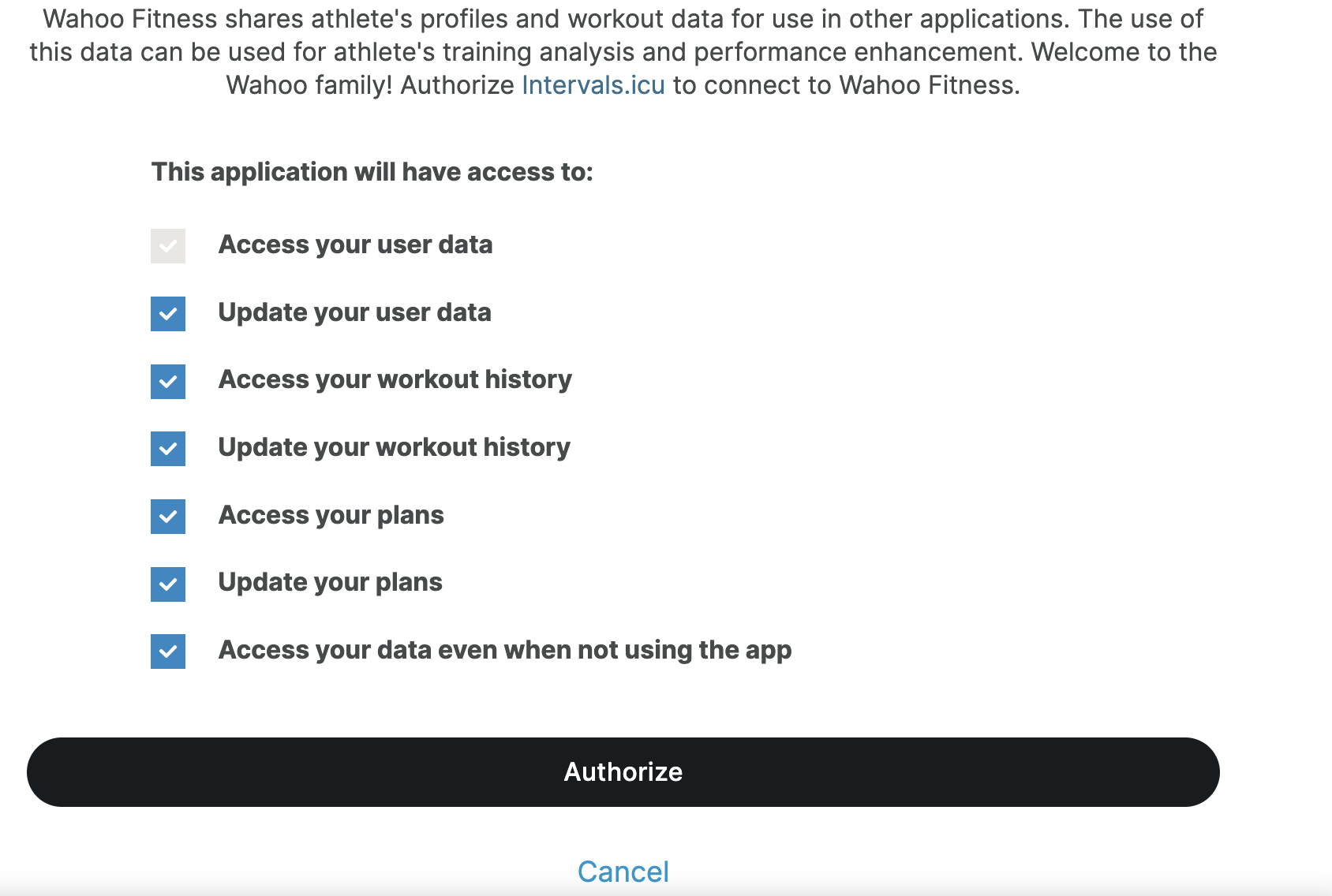

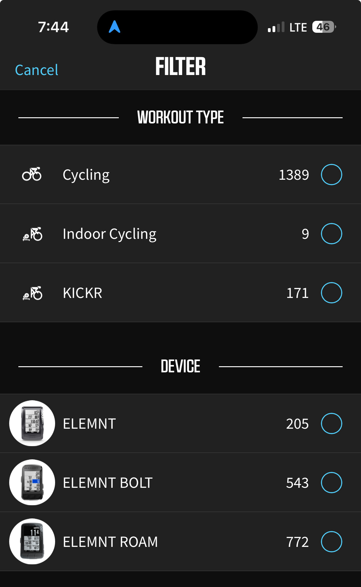

If I upload everything from the archive and start syncing with Wahoo. ALL of these workouts will start to load still.
So I still think I will have 2 copies of many of my workouts.
When you authorize Wahoo there I dont see a way to filter what gets uploaded. I believe it will take all 1389 workouts and upload them.
Which begs the question – do I want to just nuke my connetion to strava and pull the bandaid off?

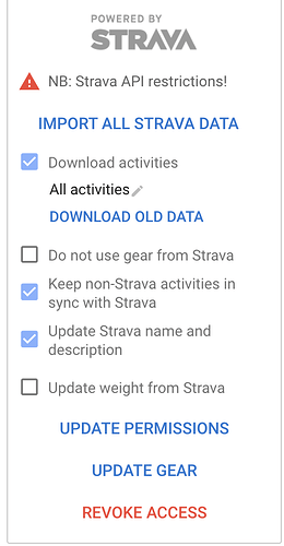

Just so it’s clear, you’re just gonna UNTICK the box that says “Download Activities”
DO NOT press the revoke access.
it’s actually OK to just leave the “download activities” to be there. In fact, in my setup, I have BOTH Garmin & Strava as “download activities”

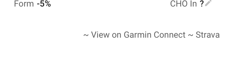

Garmin Data will replace Strava Data and only keep some relevant things (like strava name, starva ID If not mistaken - so you can click the strava link and it’ll open the activity in strava)
This “~ Strava” link
Can you show me a screen shot of what that looks like on your activities page?
