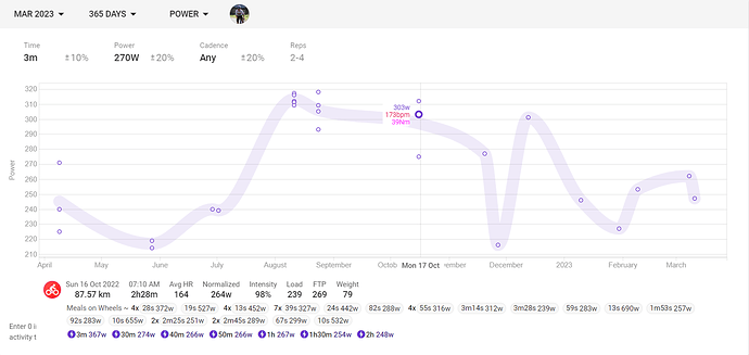

If you go to the Interval page as @Olly_Thomas suggested.
Type in duration, power, number of reps (3-6), and the last 365 days if you have recently done these.
In the example below, it returns all the rides, below the chart, where I did 3-6 repeats at the 300W for 5 minutes…
Clicking on the dot will give you some data.

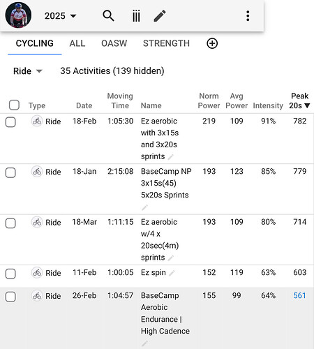

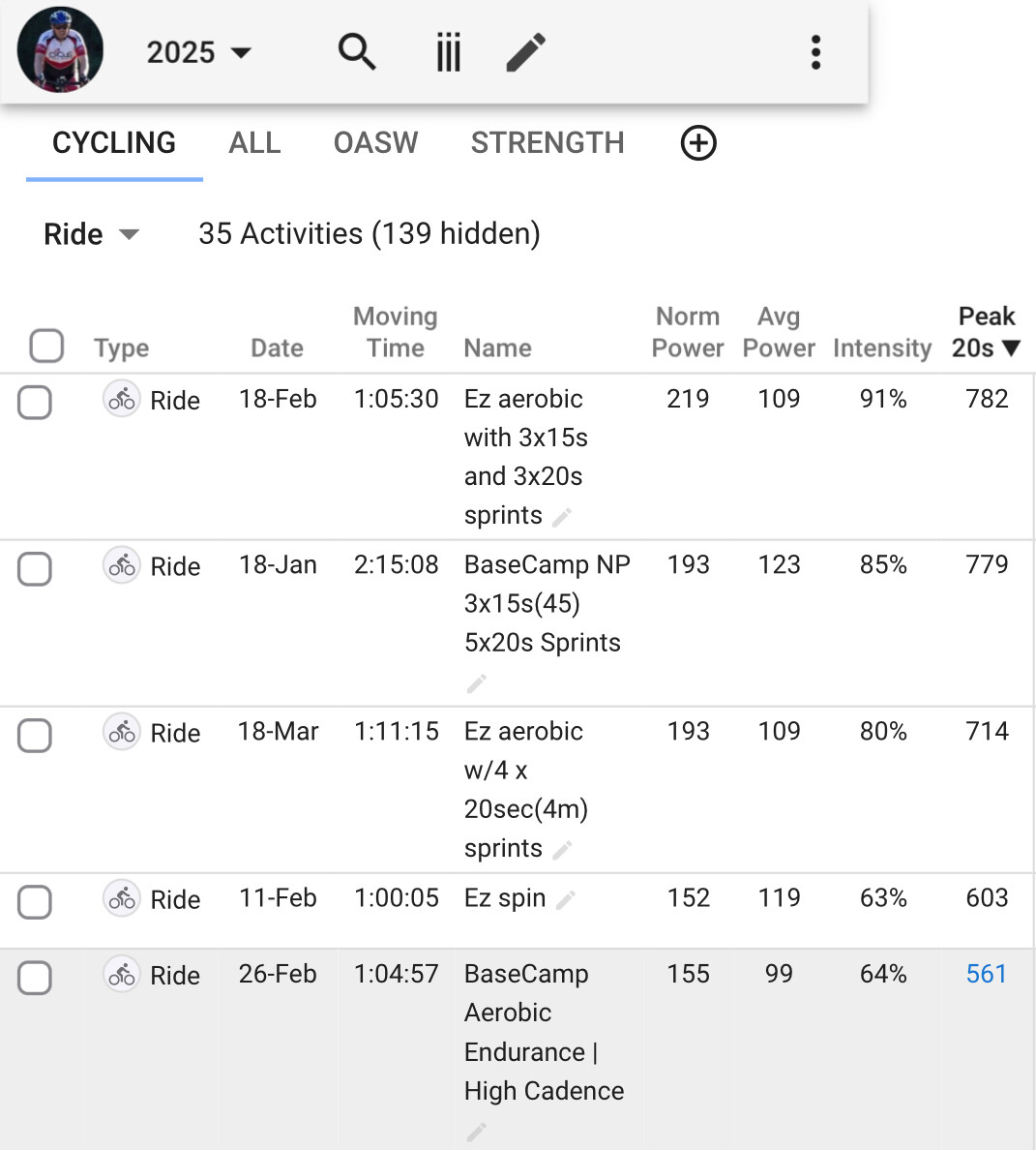

Something like this example for 20-sec best for every ride this year?
There is a thread explaining how to add that to activities. It allows seeing peak power at select durations (defined in a simple script).
details here:

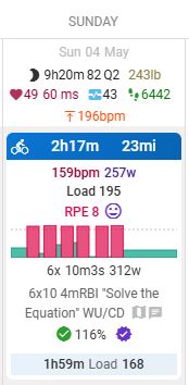

I guess for me it boils down to just using hash tags or making the interval workout part of the name. I was hoping for something like what the calendar does when it displays the workout intensity bars and the workout intervals with average power such as attached. This is how I find recent workouts now; using the calendar view looking for similar interval workouts and was looking for a way to find them further back with search criteria. Anyhow thank you to everyone for the helpful information.
