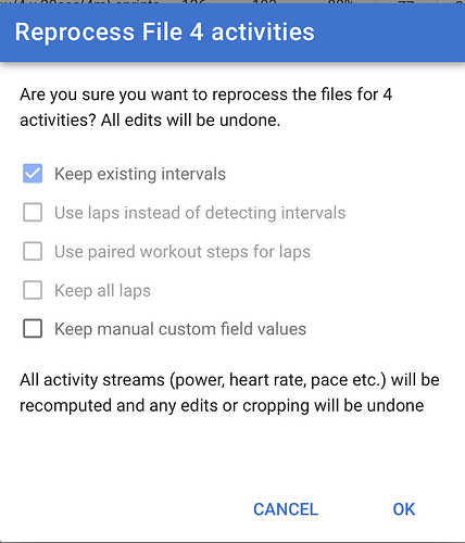

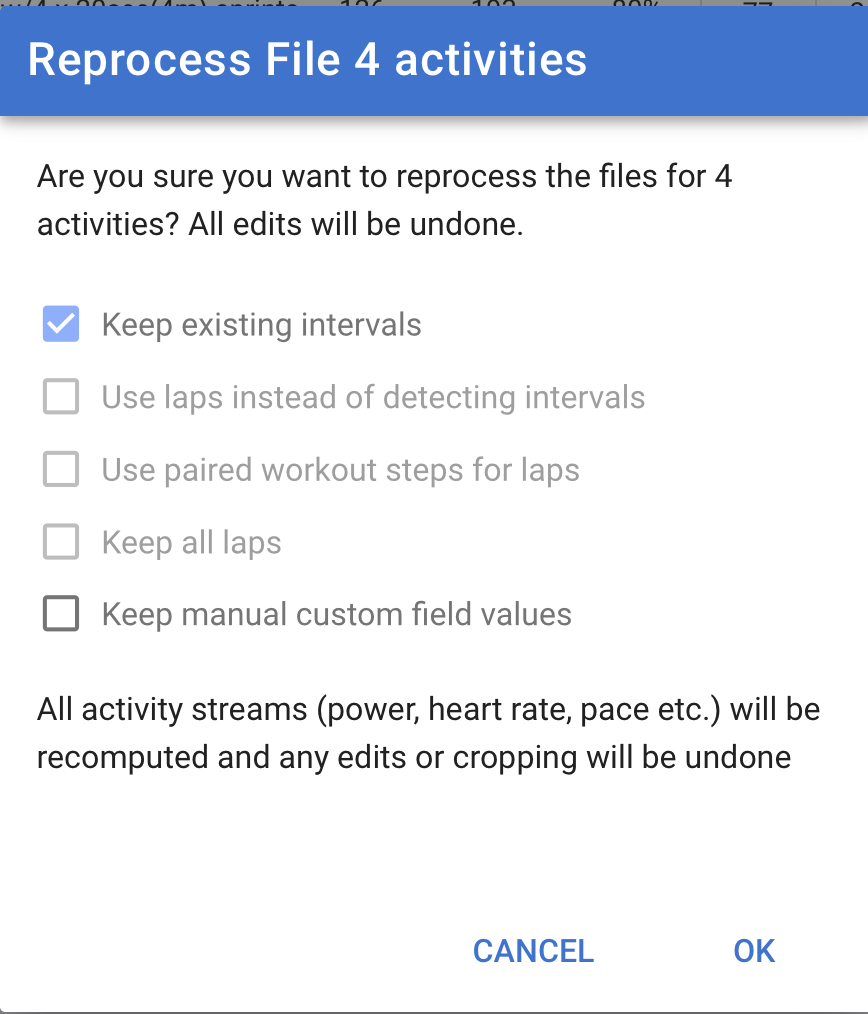

in list view select the activities without Peak Power, then Edit > Reprocess File and I selected “Keep existing intervals” so that any interval edits and changes are preserved.
Worked perfect! thanks!
