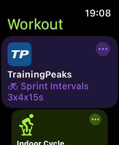

@david the TrainingPeaks app downloads to the native workout app, and can only do structured workouts using power heart rate or pace; no RPE.
Here is the help file from TP:
https://help.trainingpeaks.com/hc/en-us/articles/360039727152-TrainingPeaks-and-Apple-Watch

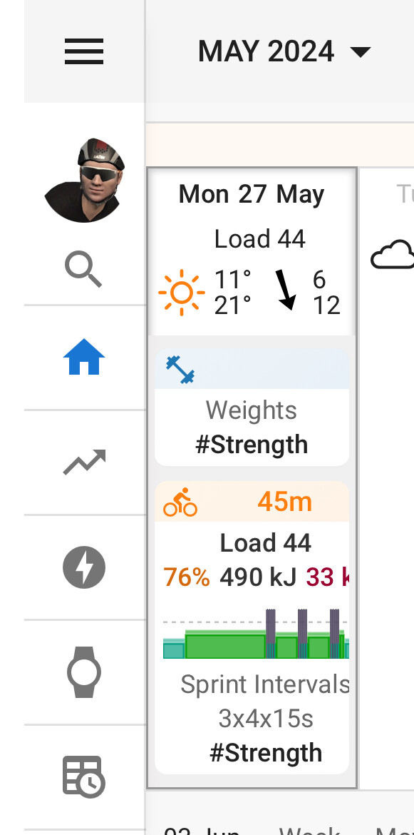

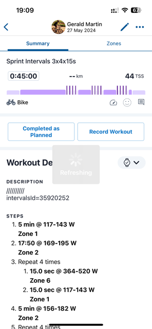

I currently sync using the TP2Intervals 3rd party app (macOS), to get my planned workout from Intervals to TP. From there, it automatically syncs on my Watch (native workout app. I moved tomorrow’s workout to today for illustrative purposes.
