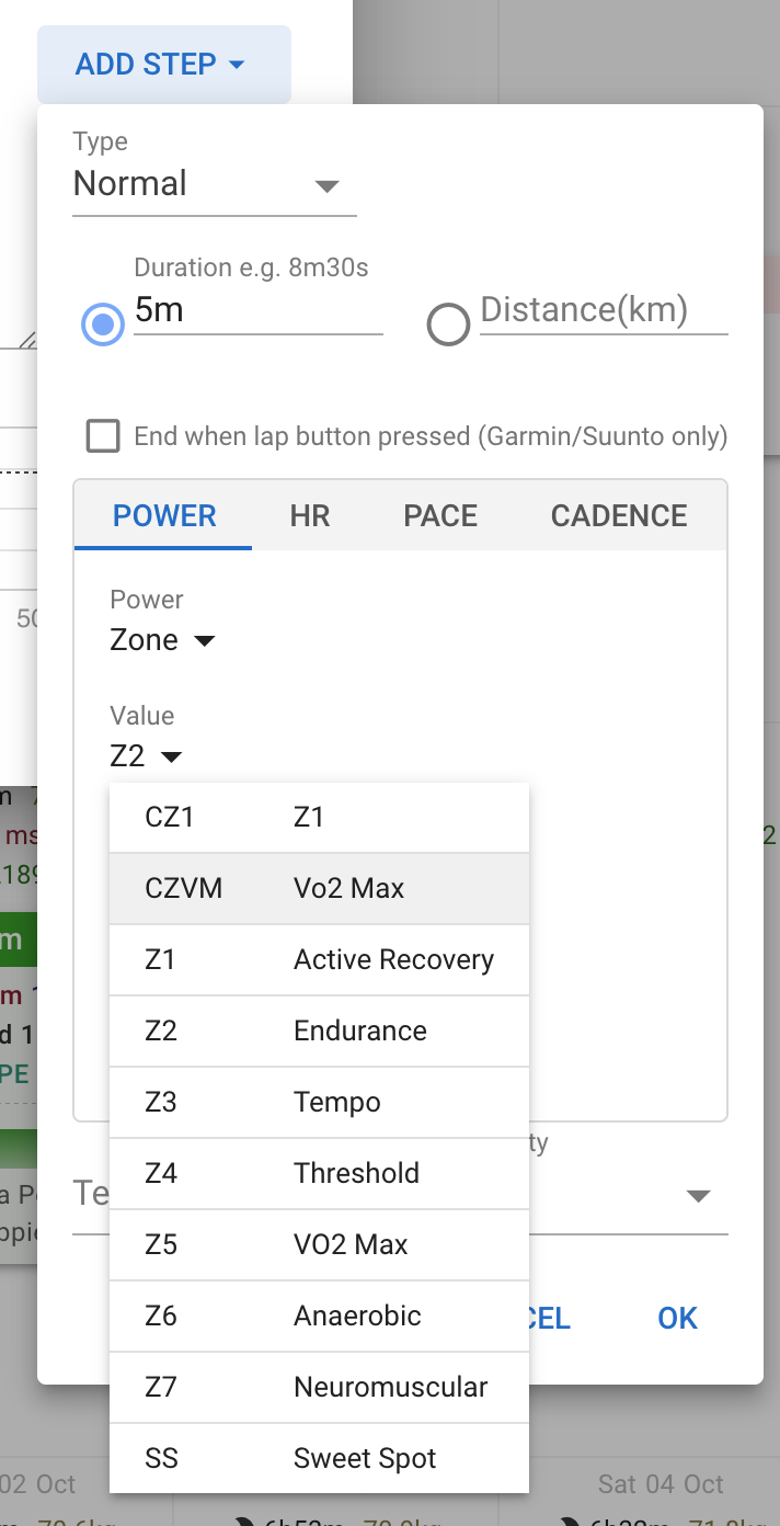

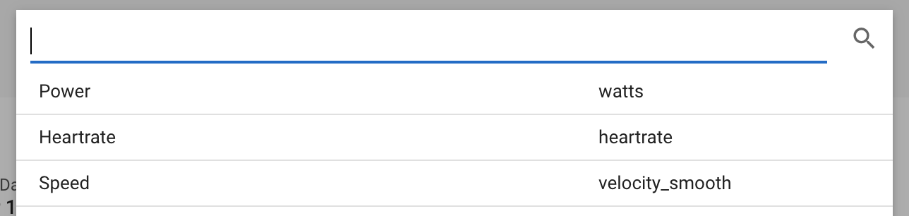

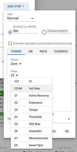

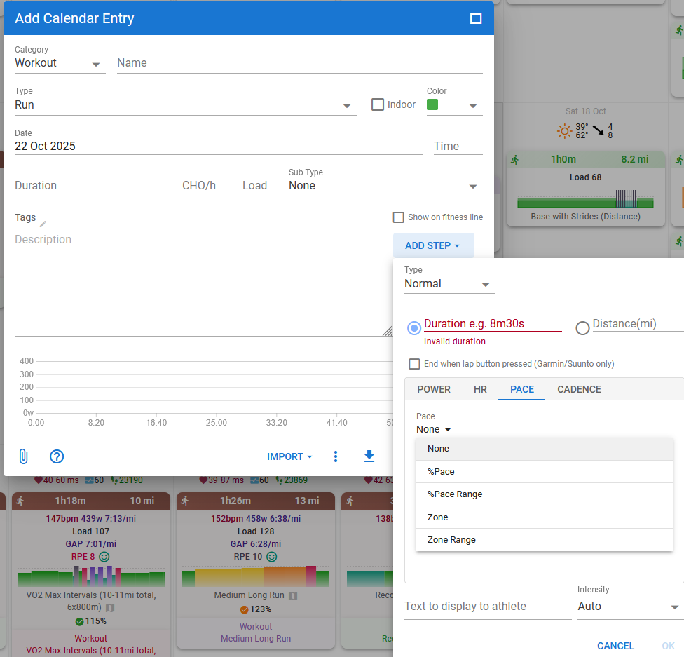

Workout prescription using custom zones is live now. The “Add Step” dialog has been upgraded to show custom zones and zone names.
This only works for zones using the Power, Heartrate and Speed streams.
If you have several sets of zones active for a sport and they have overlapping zone ID’s then the zone from the first zone found is used, in the same order as on the /settings page.

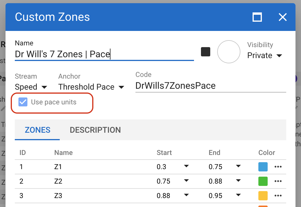

There is a new checkbox in the dialog to use the pace units for the sport instead:
You still need to enter zone values in meters/second if not using a factor of an anchor.

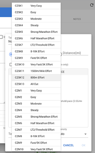

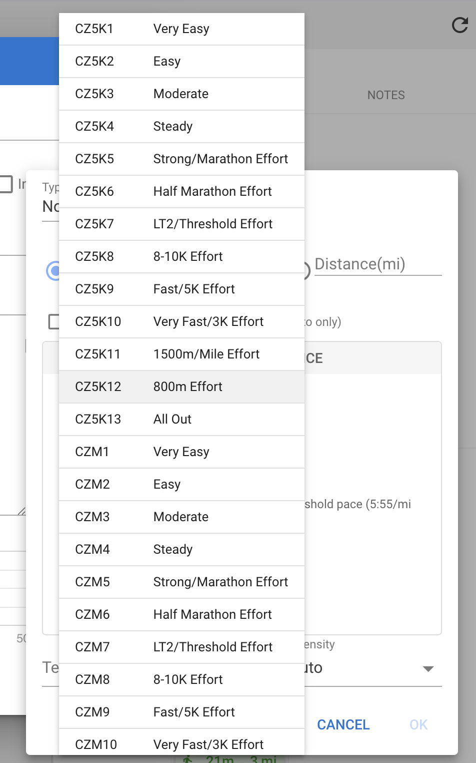

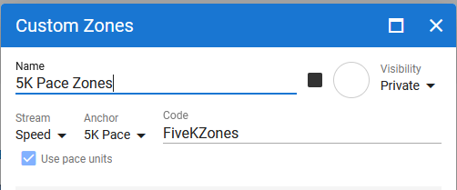

I’m not seeing the Custom Zones in the workout builder yet, either via the Add Step or manually entering it
I’d expect to see two options, one called “5K Pace Zones” and one called “Marathon Pace Zones”. Both are defined similarly
I’ve tried clearing my browser cache, logging out and logging in, and using a private window. I’ve tried via the calendar page and also via the workout library.
I’m using Firefox’s latest version, not sure if that matters
No rush, but I figured I’d report it.

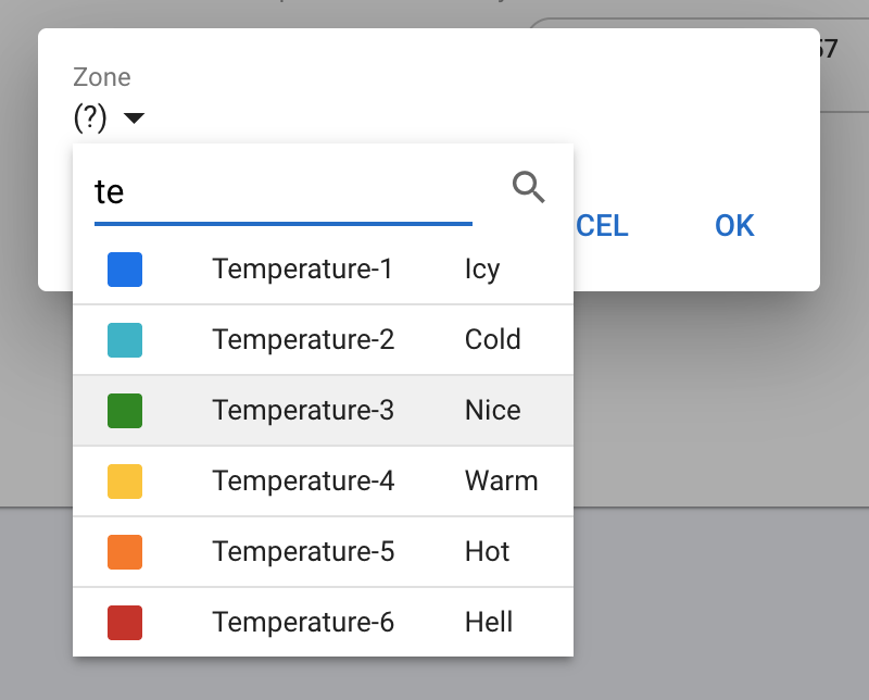

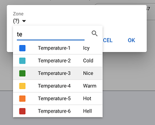

You need to choose “Zone” first and then the zones appear in the zone selector:

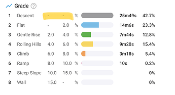

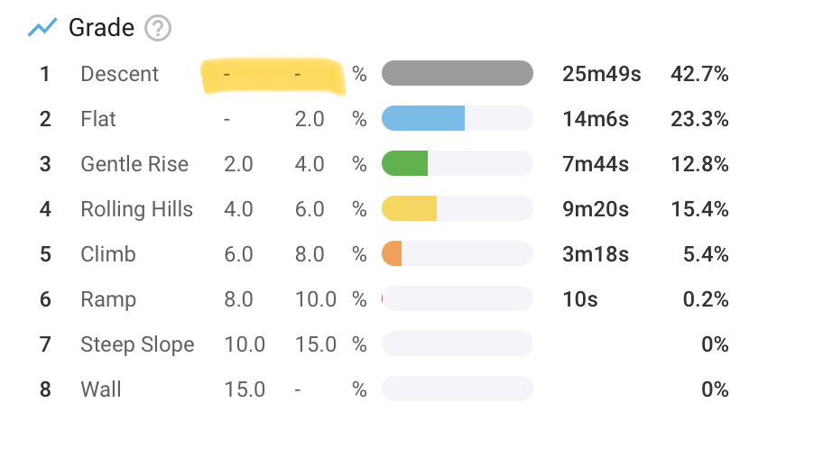

Could you show negative values, if specified, in the TiZ view?

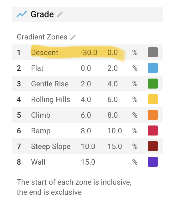

I have defined Grades as these:
But in the activity view I see this:
I previously defined Descent only as <0% (without the -30% minimum), and then it didn’t count at all any time in this zone.

That was a bug and just got squashed. Tx. I also tested removing the -30% minimum and that also seems to work now.

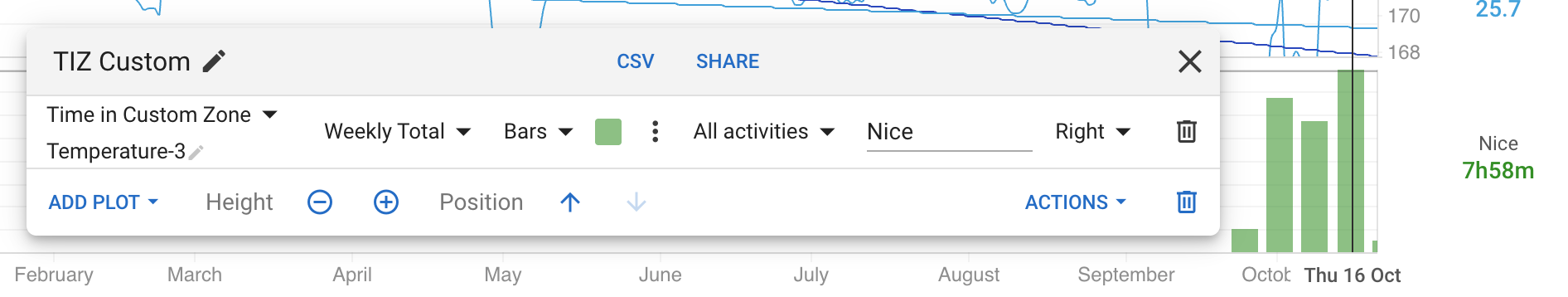

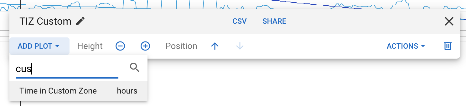

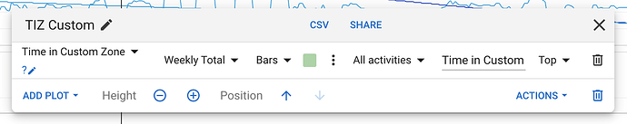

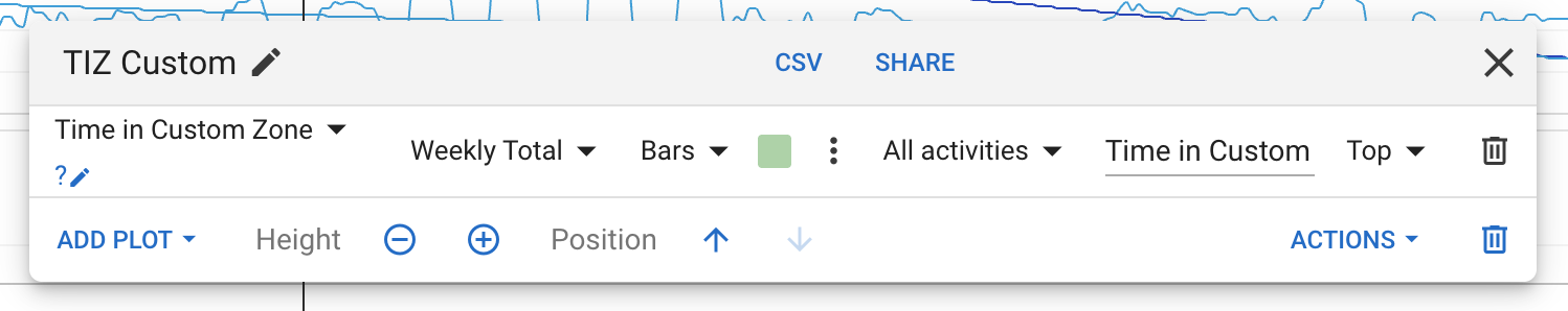

You can now plot “Time in Custom Zone” on the /fitness and /compare pages:
Click the ‘?’ to choose the zone:

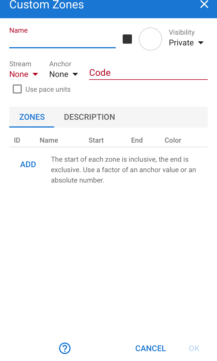

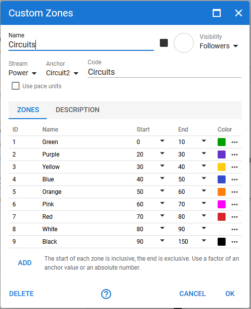

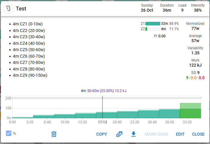

Would it be possible to have the stream be None so we can use arbitrary values for zones? This is mostly applicable to custom sports.
The problem I’m encountering is that because zones are still based on FTP/HR etc… in the workout box the custom zones don’t align with what is expected. I would like to have absolute values there based on my custom fields/zones.
in my example, I have 9 zones set up, effectively wanting cz1 to be 0-10%, cz2, 10%-20% etc…
The current workaround is to set FTP to mimic the custom zones and have a custom field be the range. However, this causes an issue if the number of zones with FTP don’t align properly (FTP maxes at 7 zones). It would be great to be able to ignore stream mappings and just have an absolute display if no stream is set, that only relies on the custom zones

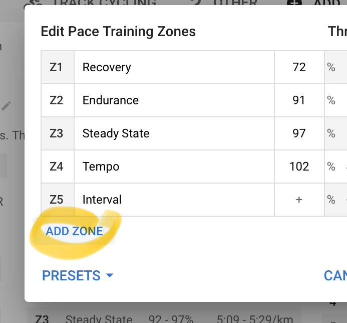

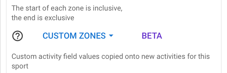

Any chance of an idiots guide as to how to set up these custom zones. I’ve looked through this thread but honestly I can’t make head n’tail of some of it. I can’t find anywhere how to set up a custom zone for a sport for instance.
PS Not everyone speaks coding language

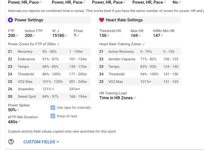

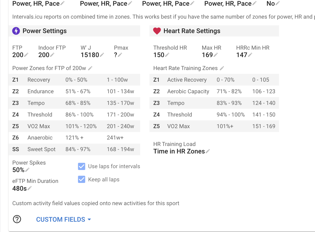

Go to the settings page, below your standard zones, there is a button:
After you clicked it, you can add a zone
Add a name, code will be auto filled, and select the stream (= zone metric, like power, or heartrate or whatever you want)
Then add a zone. For example power zone Z1 shall be from 100 to 200. Z2 shall be 60% of FTP to 80% of FTP. Z3 is from 0 to 100% of a custom Activity field pVo2max. It would look like this:

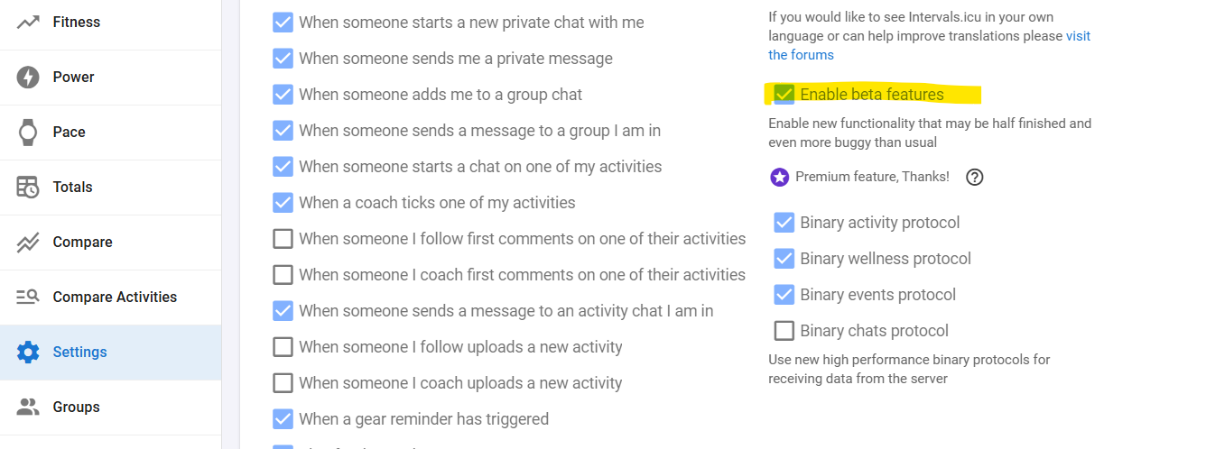

I didn’t realise it is only available in BETA version which I don’t have.
You are a ‘Supporter’, so you can enable Beta on the Settings page
