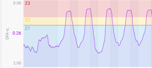

I created a DFA-α₁ chart with colored-background zones (public).
To show it in the same direction as other metrics (power, HR, etc.) I set the axis to min = 2, max = 0. Which works, but does obviously loose autoscaling, which other such plots have…
It would be great if I could get the inverted axis at the same time as autoscaling, is this possible?
