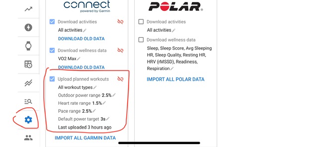

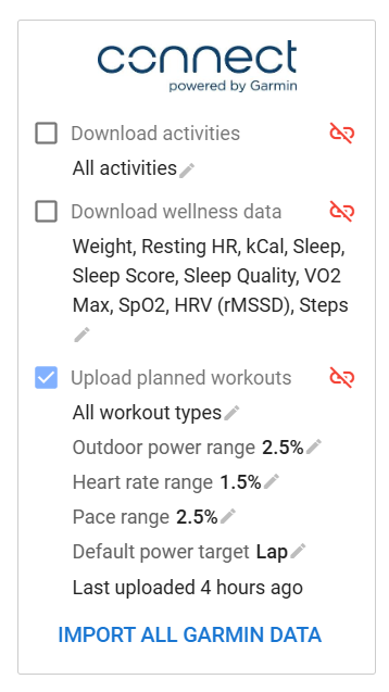

Check that you have allowed workouts to be uploaded to Garmin.
Settings, Garmin Connect.
IMG_5679
It will sync almost immediately with Garmin Connect.
From there, check your workouts on your Garmin, or the calendar.

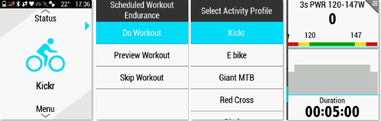

It’s as easy as loading a workout to your calendar.
It syncs to Garmin

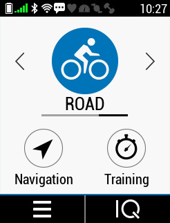

At start up it showsthe home screen, select top right to go to next page.
Shows a planned workout, select the profile, then go.

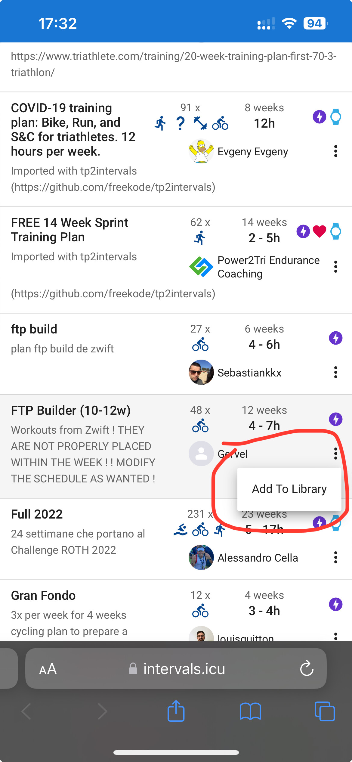

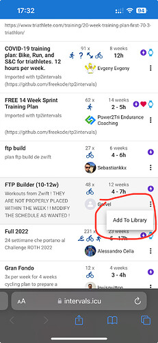

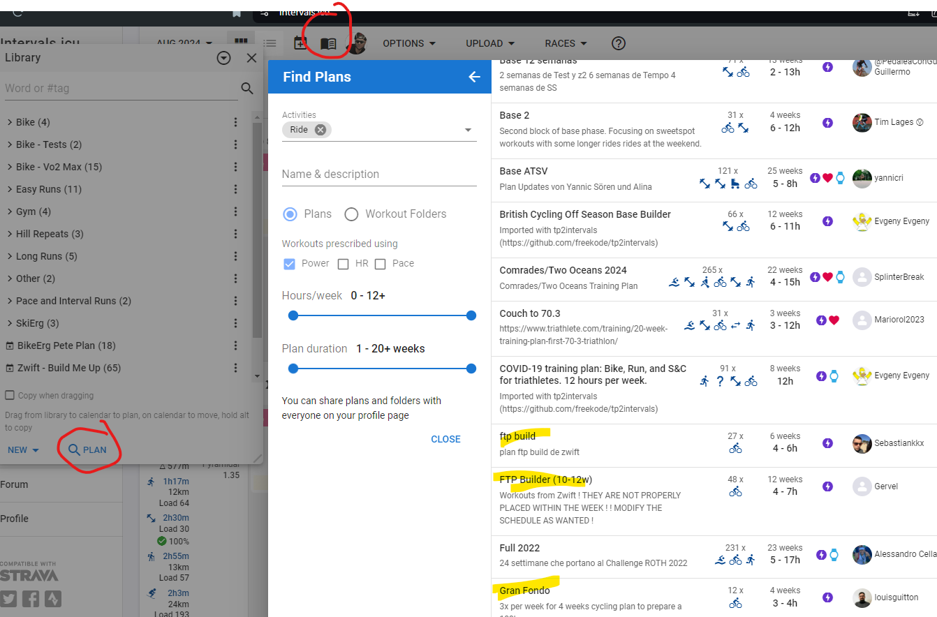

If you click on the library icon at the top of your calendar, and then click on the looking glass/plan it will give you a list of plans people have shared. There are a few Zwift ones in there (highlighted).
thank you you did that much more elegantly than I would have.

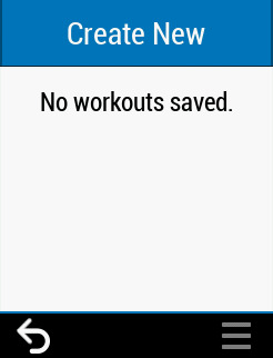

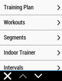

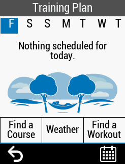

I’m not doing something right - I click Follow a Workout and there’s nothing there.
I click Training - Training Plan - and there’s nothing there.
I click Find a Workout and there’s nothing there.
Sorry I’m a little slow.
edit : tried to upload the first fit file manually and it failed

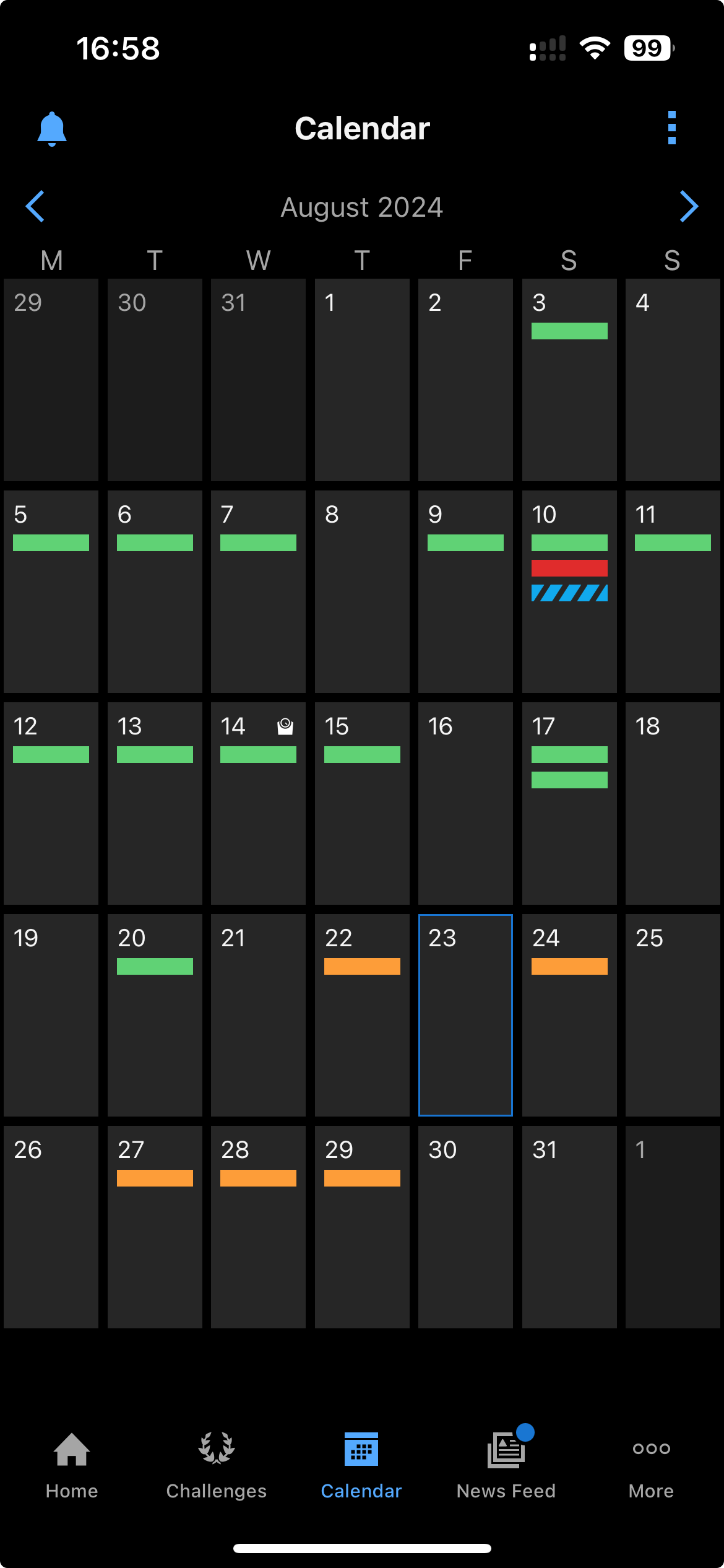

Does a planned workout show on the Garmin Connect calendar?
This would show, if you have a synced workout from your Intervals calendar.

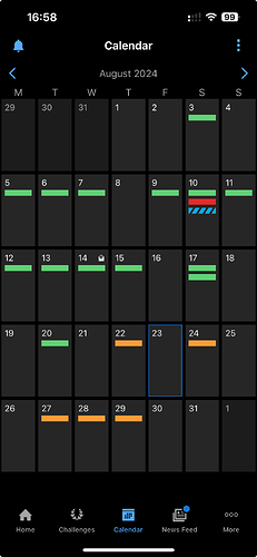

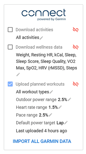

No I’m not seeing that. If I filter to scheduled workouts nothing shows.
so this part looks good.
I can’t see any evidence of it on the Garmin side.
It was last updated 4 hours ago.
Which day is your intended workout scheduled to happen? Today?
Intervals only uploads the next 7 days.
ok this makes some sense - for some reason when I copied the FTP builder in, it set it up in July and August (6 weeks gone by) - actually it ends Aug 3
so how do I set it to go forward?
somewhere along the line I really goofed this up :slight_smile:

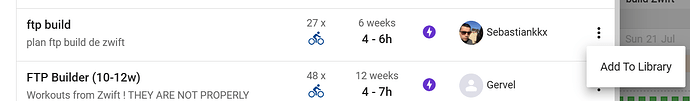

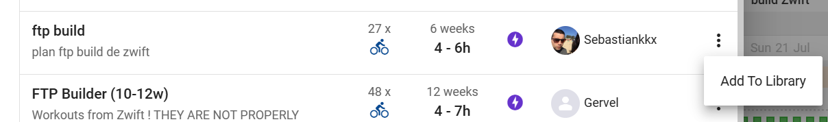

Is the plan in your workout library?
Triple dot link, then add to library
