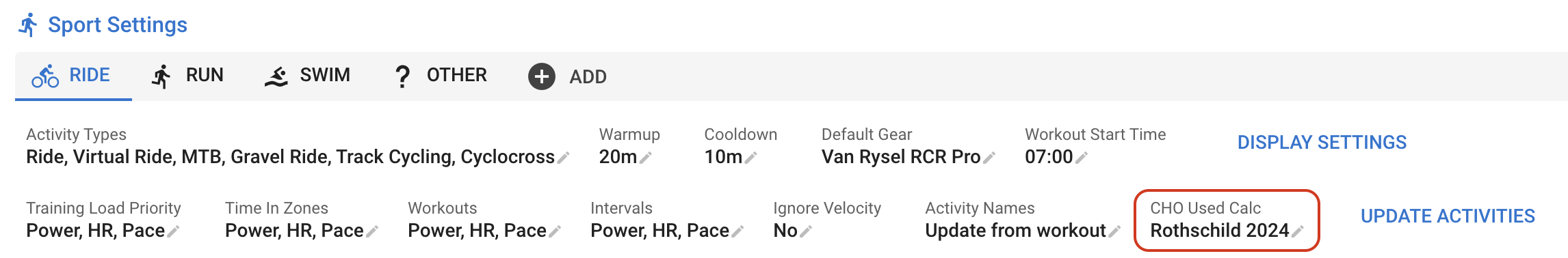

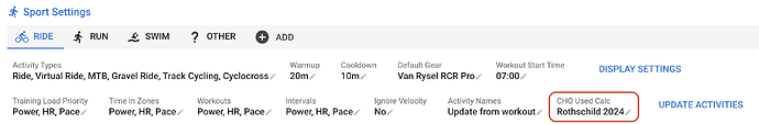

Update 19 October 2026: Carbs used is now an editable field in the UI and elsewhere. You can now control this feature per sport in /settings. Set this to “None” if you want to use custom activity fields and apps to update it.

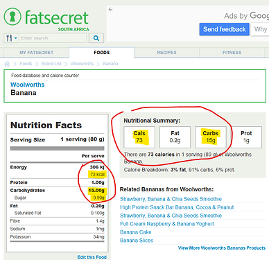

My carbs/kcal are based on the actual foods I consume on the ride. fatsecret.co.za is the data source to get the (estimated) carb/kcal values, then completed on a spreadsheet before the ride, so I know what value to enter on the Garmin at the end of the ride.
